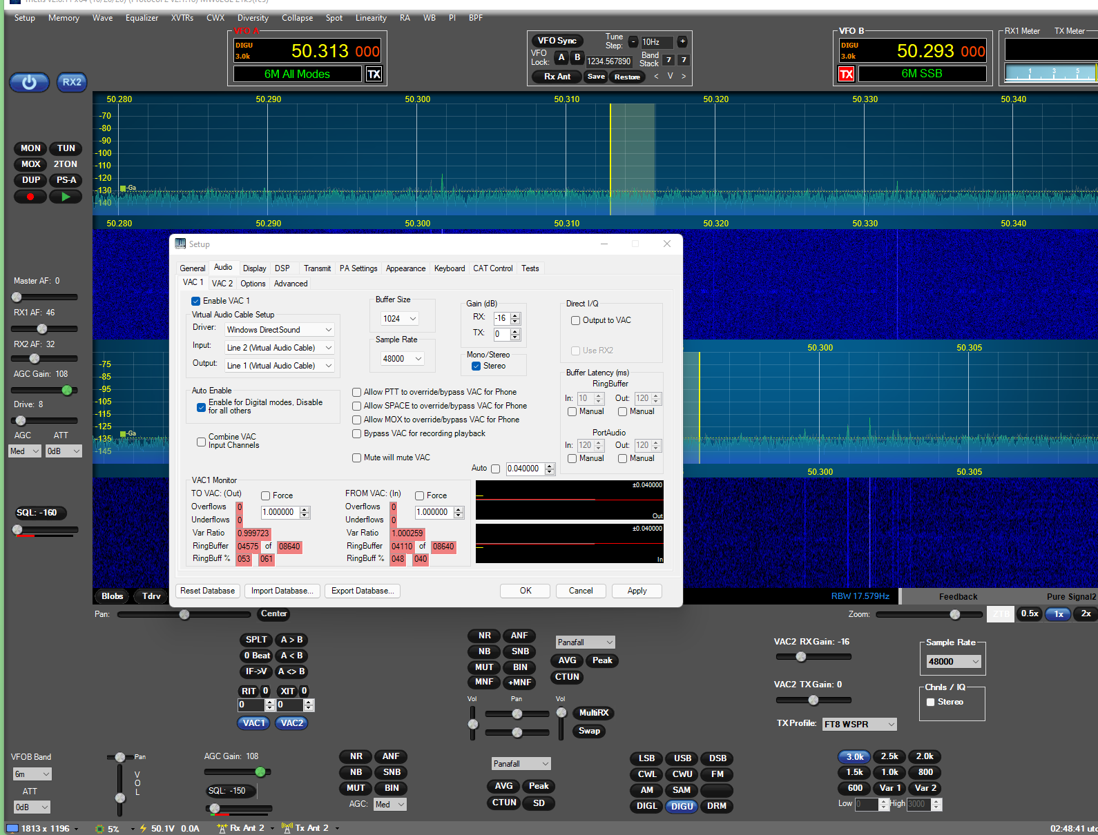

Seeing unexpected interactions between VAC1 & VAC2 when adjusting RX /TX gain on VAC1.
After selecting RX2 and IF VAC2 RX TX gain are displayed on "front" panel adjusting either the RX or TX gain on the VAC1 tab changes the VAC2 RX /TX gain in lock step.
However, On selecting the VAC2 tab - I can adjust the RX gain without affecting VAC1, however, no change is mirrored on the front panel. Audio levels do change on JTDX so the RX gain change is happening,
Not sure if I have missed some button that links the two VACs or its unexpected interaction?
Its non critical and easily worked around - once you realise its happening.

thanks Nigel, inadvertently broken in a recent release. Fixed along with the apostrophe issue.
Updated to rc5b.

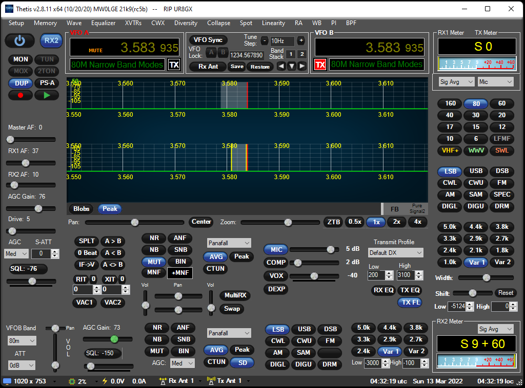

w-u-2-o wrote:The drop-down button UI is quite innovative and acts to address ever shrinking UI real-estate. However, the mixing of TX audio related controls with spectral display related controls is quite jarring and very counterintuitive. It flies in the face of UI design principles.
Blobs, Info, Spot and Peak correctly belong on spectral display related (located) buttons. CFC, CFCeq, and Lev do not. Tdrive is yet another outlier.
While it is also counter to UI design principles to obfuscate controls behind right clicks or, worse, modifier keys, please consider that it would be better to re-arrange these buttons as follows:
1. Blob, Info, Spot, Peak on a button or buttons located on the status line of the spectral display.
2. CFC, CFCeq (more properly "PostEQ"), Lev could more properly and logically become part of the existing DEXP button.
3. Tdrive could become part of the existing TUN button.
Even better, would be to simply show these buttons outright. The smallest allowable size of a Thetis window is 1018x609 pixels. This makes the smallest screen resolution allowable to be XGA, or 1024x768. Perhaps it is time to require a minimum screen resolution of WXGA, or 1280x720. This would provide ample space for a row of 4 buttons alongside MIC-to-DEXP, as well as 4 separate buttons on the spectral display status line.
I'm sure there must be some person that feels compelled to run on a 10 year old laptop with an XGA display, but even micro-laptops come with WXGA displays these days. It might be time for those folks to upgrade!
Yep, there are options that shouldn't be in there if you think of those buttons as just being related to the display. I know that, I knew that before anyone when I was coding it during ~10hrs that it took to re-engineer all the existing text box nightmare implementation of the info bar. However if you think of them as two general quick access buttons then they work as intended and it doesn't matter what is in there. Perhaps if you don't like what is in there, then just forget about them. Set them to what you want or just ignore them. I would imagine that over 75% of ops couldn't care less about RBW and the other hundred of options that are available, they just ignore them.
That said, we could of course add everything to the front end and add to the button splatter fest. If you want 'to fly in the face of UI design principles' then just look at the display already which can not be shrunk enough to fit an andromeda screen without using the collapse view. Groups of those control are adjusted by a delta every window resize which is why it is the slowest resizing window known to man.
21k9 is fast approaching completion with a few items left to tidy, I do not see me changing any of that info bar or distributing more buttons around the front end before then, because it does nothing for me, or gain me anything from the radio/experience right now.
- one_more_wafer-thin_button_sir.png (241.58 KiB) Viewed 30553 times
