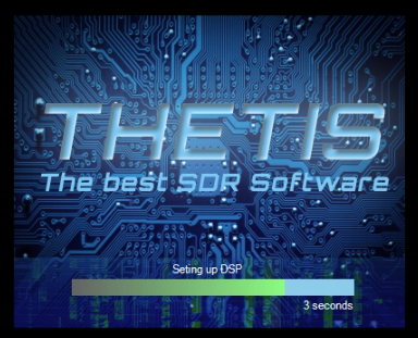

ramdor wrote: Something to brighten my very dreary mood recently, Ernst OE3IDE has sent over a nice new splash, and it looks great with progress bar and eta to completion time. It will be in rc5 at some point before/during the weekend.
This new splash looks great and nice work Ernst. Only one comment, can the text under Thetis be updated to something less obvious, like "ANAN SDR Software" or just "SDR Software"? IMO. :)

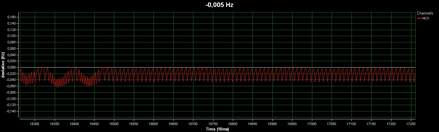

Here are some high resolution measurements of VAC output. Test signal is 1kHz from Thetis receive path test generator, so 0.001 Hz offset is 1ppm samplerate error.
First setling from forced to normal operation( big scale):
Normal operation in detail (zoomed Y):
Forced to 1.000020 (the mean error on my setup, to maximize time intervals between clicks):
as we can see, the "resolution" of the converter is about 50ppm, it is switching (dithering) between two values. Each slope maybe a relevant phase jump for some digital modes.
Due to the integer behavior of conversion resolution it is not capable to dither around zero, so a mean error of 25ppm remains.

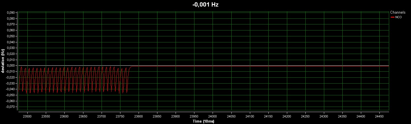

Forced to 1.0000000:
Indeed Spot on with only 1ppm offset (which may be rounding error of my PLL demodulator, its integer calculation too).
But we still have half ringbuffersize/samplerate latency, which will change over time to 0 or full ringbuffersize/samplerate until next overflow or underflow.
