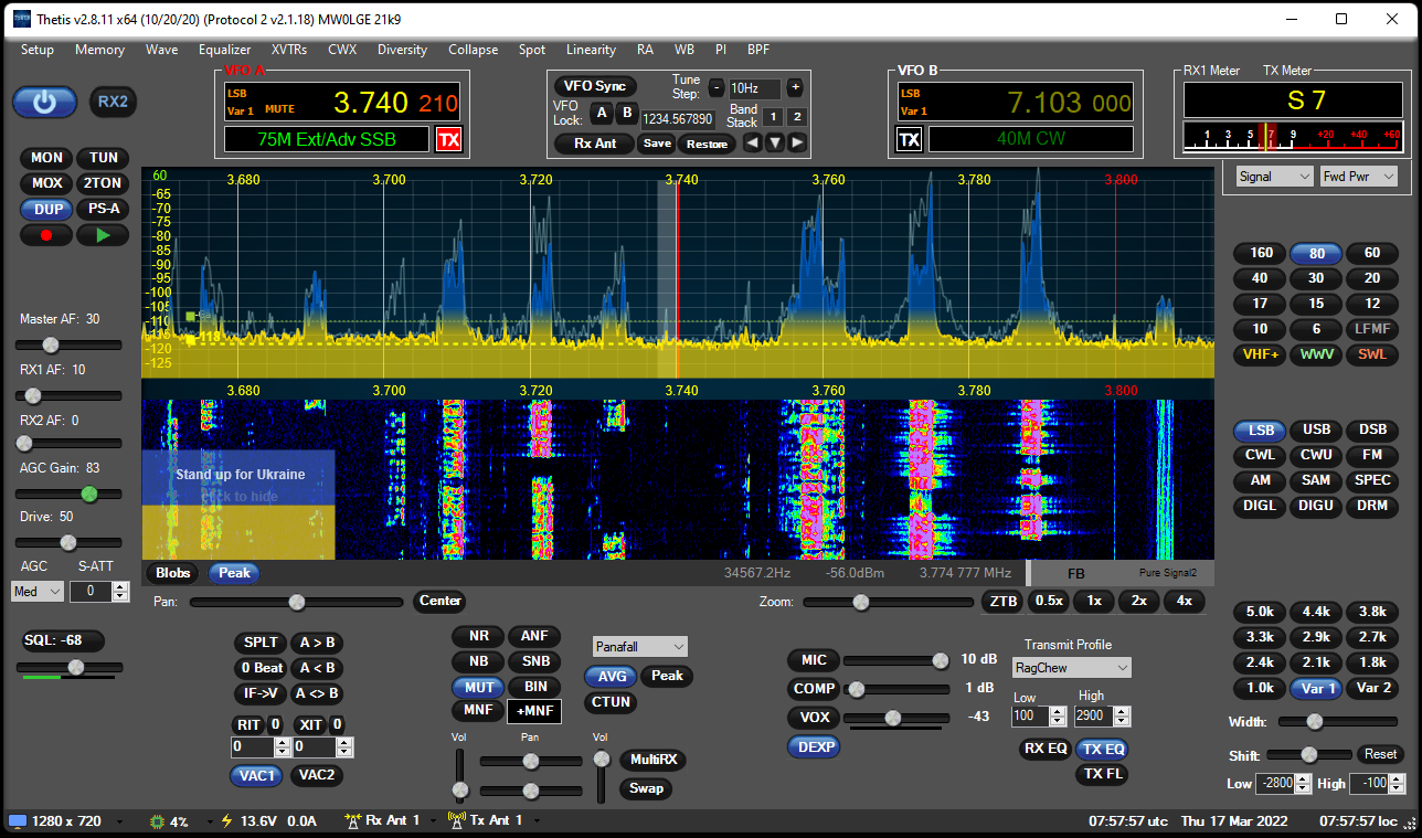

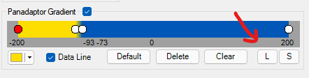

Find below a link to a gradient file that will give you the Ukrainian colours. Use the new Save/Load option on the gradient picker.
https://www.dropbox.com/s/jyusckqks8ven ... .grad?dl=1
- uk1.png (490.72 KiB) Viewed 33463 times
Thanks Richie, nice St Patrick's day gift.
Have a nice day Tony. Just for you : https://bit.ly/36lWn3kTony EI7BMB wrote:Thanks Richie, nice St Patrick's day gift.

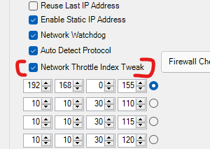

WOW Richie, just checking that Network Throttle Index Tweak box and allowing Thetis to run as administrator and rebooting like it said to do,
it stop showing me those error messages, and I close Thetis many times and restarted and no messages so far, hopefully stays that way.
Thank you Richie
