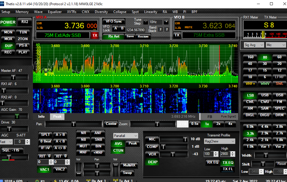

Using Tetis for a long time and love it! Everything is working fine with 21k9b. I miss the CPU load information. Under General - H/W Select I see "PLL Not Locked. What is my problem?
Thanks, Georg DG9FDA

DG9FDA wrote: Using Tetis for a long time and love it! Everything is working fine with 21k9b. I miss the CPU load information. Under General - H/W Select I see "PLL Not Locked. What is my problem?
cpu% will not be shown if your user lacks the permission to obtain the performance counter, and/or, your operating system does not provide it.
Not sure about pll not clocked. The info is returned as part of the high priority status packet. It should show the correct status in P2 when Thetis/radio is powered on/connected.
No solution for cpu% found. I am not an Windows specialist...
PLL not locked was fixed with newest firmware 12.1.8. (replaced12.1 pre4). PLL not locked produced a very rough tx signal (FM on RF).

Thanks to Erwin, DO2ZA I could fix the cpu% / performance counter problem: http://www.w1aex.com/anan/anan.html#counters
