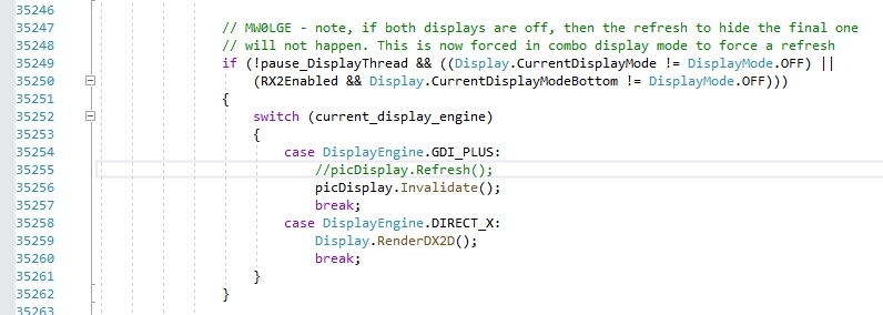

Try changing the GDI to .Invalidate instead of Refresh() in RunDisplay() and test to see if it then happens in gdi with panadapter on. I expect it will.
Like this?
GDI Change MW0LGE.jpg (71.38 KiB) Viewed 32443 times
If so, things are still the same. I'm seeing the DDC/PortAudio threads being blocked when in DX mode OR when in GDI with the Panadapter turned off. No blocking when in GDI mode with the Panadapter running. Maybe I'm just up against the limit of my 4 core i7 :(
I should mention that my computer doesn't have a graphics adapter, I'm just using the built in graphics in the i7.
Still though, I would like to get to the bottom of this thread blocking business before the GDI+ code is deprecated :D

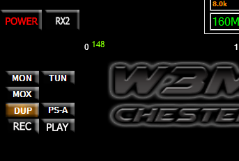

I maxed out the main display FPS to 140 and get the odd red flash , the green indicator shows 124 /125 , everything working great but I'm going to use this as a lame excuse to upgrade my GTX950 video card :D
Posts: 1588
Re: 2.6.9
Anything above refresh of screen is somewhat pointless as what you see on screen is essentially locked to vsync being that it is being rendered into something on the desktop.
Also keeping it lower rather than turning it up to 11 reduces the chance of the rest of Thetis from missing a beat.
All good fun though in the name of 'science' :)
