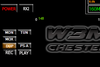

1920x1080 thetis client window size (borders included) on a 2k display (2560x1600)
single rx in panafall 50% split
filled panadapter
anti-alias
back ground skin
Completely pointless, mostly as this screen is 60hz, but still :lol: Capped at the 144 limit I set in there.
Compared to the same settings in GDI+ mode. The difference is somewhat extreme.

I maxed out the main display FPS to 140 and get the odd red flash , the green indicator shows 124 /125 , everything working great but I'm going to use this as a lame excuse to upgrade my GTX950 video card :D
Re: 2.6.9
Posted: Thu Nov 21, 2019 2:03 pm
Anything above refresh of screen is somewhat pointless as what you see on screen is essentially locked to vsync being that it is being rendered into something on the desktop.
Also keeping it lower rather than turning it up to 11 reduces the chance of the rest of Thetis from missing a beat.
