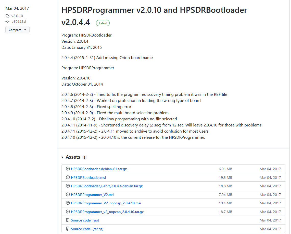

Attempting this for the first time. Have downloaded npcap already and the v2.1.18.rbf for my radio. As I was viewing the Bootloader and other "assets", I see many file names and I am not entirely sure which program file I need to download? The one with .msi extension?
See github image below (Scott has mentioned that latest versions don't make it to github very fast):
HPSDRProgrammer and HPSDRBootloader.jpg (244.35 KiB) Viewed 19135 times
Oops.....these are for Protocol 1.....will I need to find one for Protocol 2 or perhaps what it says refers to the Protocol currently on the radio in which case I can use this Bootloader?
Currently using Thetis v2.9.0.6 x64 (Protocol 1) on my machine.
I see npcap is already among the programs on my Windows 10 64 bit machine.

Everything you need to know is in the three tacked topics here:
https://apache-labs.com/community/viewforum.php?f=18
Use the instructions for Bootloader. Ignore the instructions for any version of HPSDR Programmer.
Those instructions are 100% good. The only reason they won't work is because either a) they aren't being followed precisely, b) there is something physically wrong with your setup, or c) some item of hardware is physically broken.
You want the HPSDRBootloader.msi file. That's the right choice for Windows.
That video is not bad!

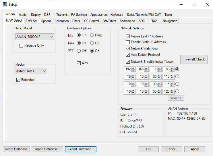

Posted: Sat Jun 04, 2022 7:36 pm
by JJ4SDR
General H/W Select Form after upgrading to Protocol 2. Will investigate to determine that all is well :)
