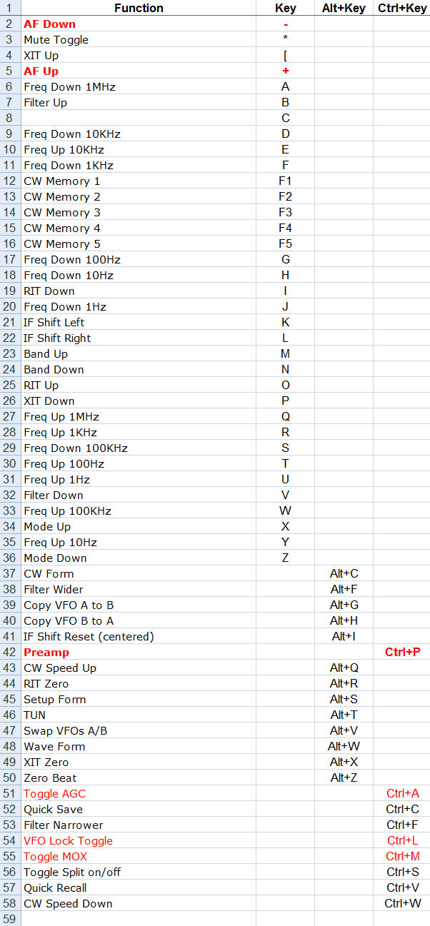

Posted: Fri Nov 26, 2021 4:29 pm
by RA3PKJ
Yes, that's right.
But the full list is much longer. Probably need a help button for shortcuts.
Posted: Fri Nov 26, 2021 4:46 pm
Where did you find that list?
Posted: Fri Nov 26, 2021 4:59 pm
by RA3PKJ
These shortcuts were in PowerSDR from FlexRadio. Shortcuts are transferred to all modifications of the program (PowerSDR > PowerSDR mRX > Tethis).
