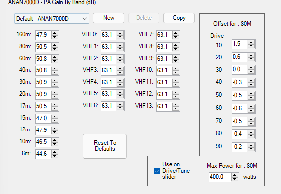

The new PA gain form is awesome! The PA profiles are going to make life a lot simpler for those of us who switch between low-drive amps and amps that need lots more. Very clever setup for getting a more linear response for each band from the drive slider.
Great job!
Great job!

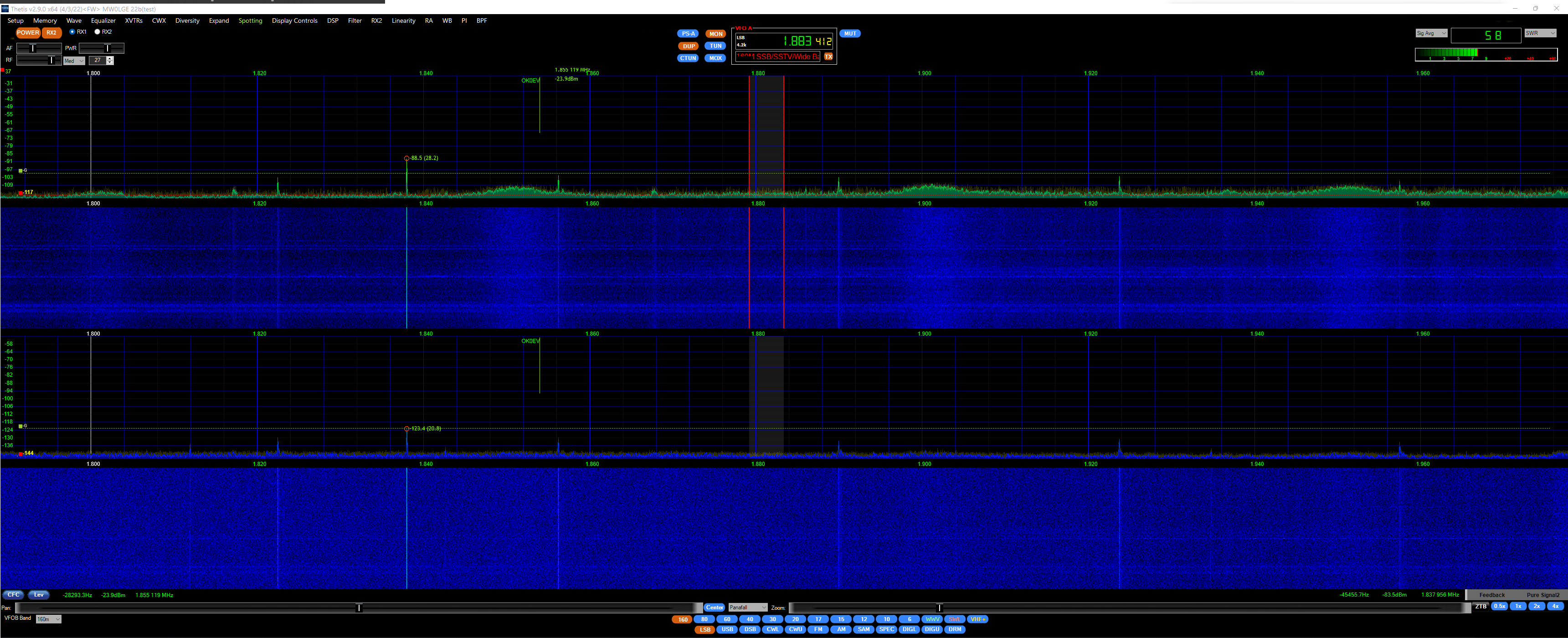

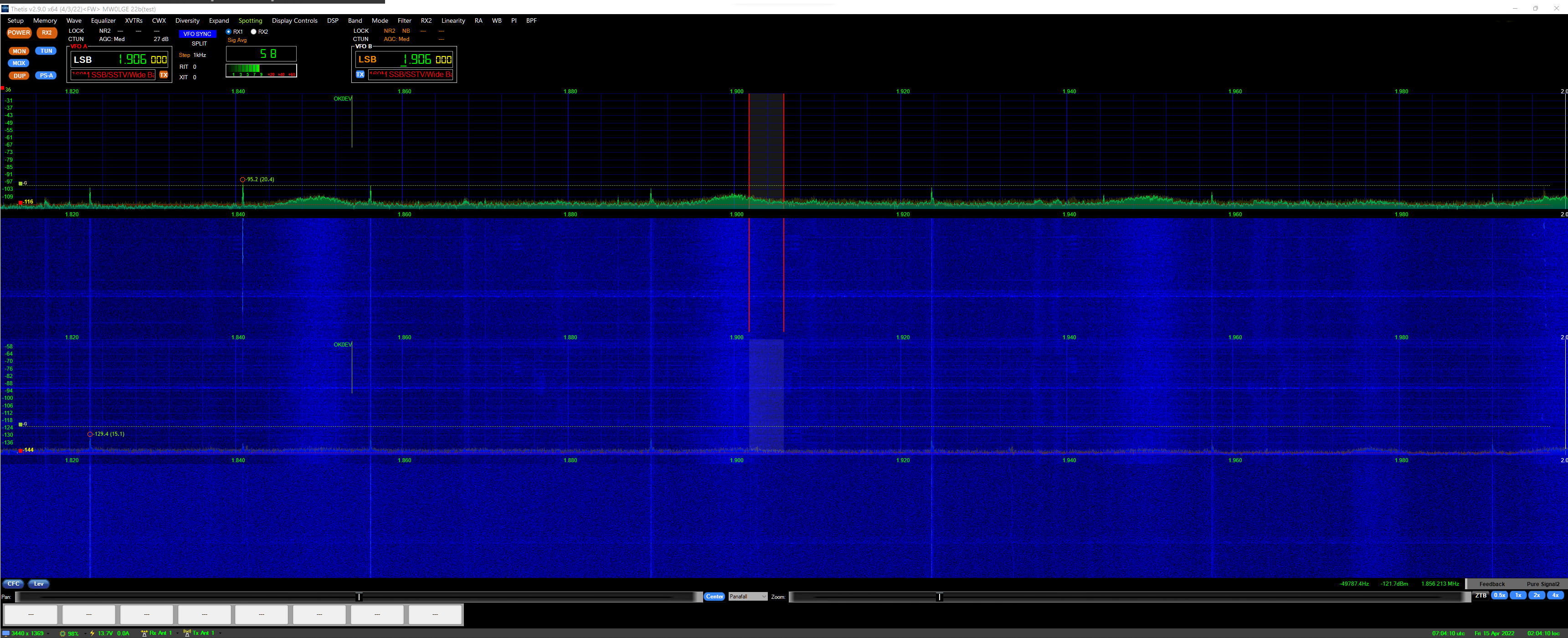

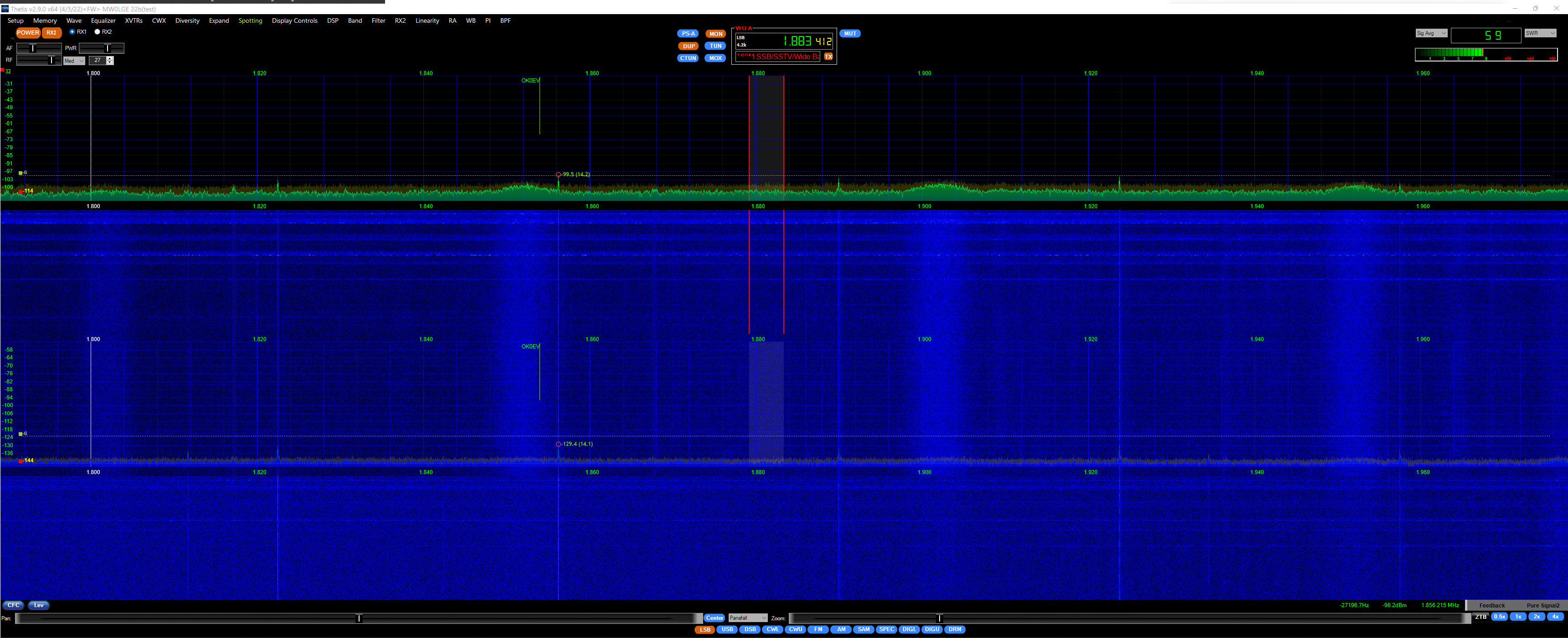

On 22b(test) with the display in collapsed view with RX1 only active and change the bottom at all from Andromeda buttons to others or none then activating RX2, the RX1 waterfall draws over the RX2. Appears to do with either top display option. Could only replicate this by making any change in the bottom display options first otherwise next time RX2 was activated it displayed normally as it should
Update--I guess that it is more random than anything , because for a while I couldnt get it to display correcly no matter what and then couldnt replicate it for a while after that/.

Hi Cory, could you keep posts in here to the actual released versions, and not versions that are in active development, it really confuses things, as 99% of people will not be using a self compiled version from wip source. Perhaps start another thread to talk about ongoing dev for not yet released versions.K9CDR wrote:On 22b(test) with the display in collapsed view with RX1 only active and change the bottom at all from Andromeda buttons to others or none then activating RX2, the RX1 waterfall draws over the RX2. Appears to do with either top display option. Could only replicate this by making any change in the bottom display options first otherwise next time RX2 was activated it displayed normally as it should
However, this specific issue, yes I have seen it, but like you was unable to replicate it on demand, much like the reverse vfo drag that happens from time to time. Added to that, I never use collapsed display so have not 'put it through its paces' over the course of development.

ok, there is an issue, quickly discovered perhaps related to the issue you reported Cory. If you are in collapsed view with RX2 enabled, resize the window, then turn RX2 off, RX1 waterfall is not correctly resized.
ramdor wrote:ok, there is an issue, quickly discovered perhaps related to the issue you reported Cory. If you are in collapsed view with RX2 enabled, resize the window, then turn RX2 off, RX1 waterfall is not correctly resized.
OK, glad it wasn't just me. I never use that view either, but was experimenting (since afterall, well enough can never be left alone and ran across that in the process.

1) After you update, make sure you check your PA settings, your old settings should default into your radio model in the new PA profile system

add: new PA profile system WARNING : check your PA settings before use (https://youtu.be/PlkBoOA5rfQ)
add: split_enabled is now sent on TCI initial connect
add: new limit system. Right click drag Drive/Tune slider. Use SHIFT + mouse wheel to adjust +- 1
