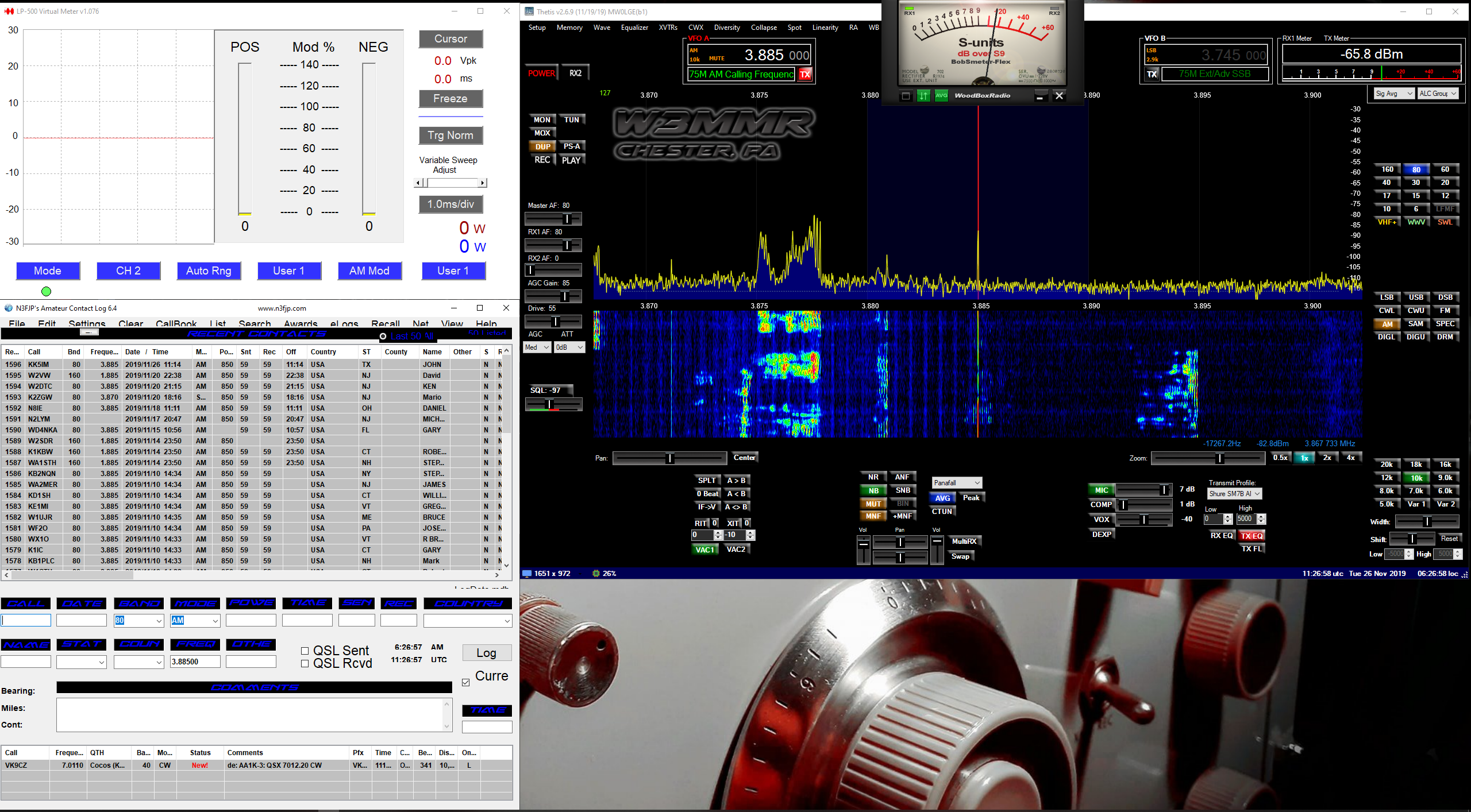

Hi all.
Many thanks Richie MW0LGE and all the other members of the development team for all the hard work. I am using firmware v1.8 and the latest software release v2.6.9 with no problems at this stage.
My project is now getting much closer to completion but I still I have a few things to do before I close the box – I will never be satisfied with everything but after all, it is a prototype in many respects . The front panel is not as clean as I would like it – I should have sharpened my hole punches. See QRZ.com for some pictures.
The transceiver is based on the Apache Labs Orion MKII SDR board. The remainder is mainly home brew – designed all the filters using Elsie software, made own PCB’s including a 100W mosfet PA for HF/6M. Also added a 2M transverter based on the G4DDK design (modified to accommodate pure signal and control using a second down converter) and a 2M 60W PA using a PA module used in 2M FM transceiver but linearized for SSB. However, the TX Intermod performance without pure signal is not adequate.
The software control arrangements emulates the Anan 7000 using Thetis/P2 (same for HPSDR) which I am now using and very pleased with the performance. Pure signal provides a significant improvement for the TX intermodulation performance as you can see for the pictures when on 2M. The same applies to HF. The software control also allows me to monitor 2M whilst listening on the HF bands.
regards
Jeff GW3UZS

No issue here @ 144fps, 2560x1387 resolution, 1440p 144hz monitor, 384k sample rate, 2.930 Bin, 50ms averaging, 20ms update period. Also tried your settings with no issue.w-u-2-o wrote:I'm observing what is perhaps best described as "stuttering" in the rendering of the waterfall. Running DirectX, 32ms update rate on a 30Hz monitor. Panadapter is set for 30Hz. 768KHz sample rate, 2.93 Hz bin size, 120ms averaging.
Changing the waterfall update rate to be faster or slower makes no difference. Changing to GDI makes no difference. Averaging on/off no difference. It's just not completely smooth, it's a little jerky.
Anyone else notice this?
Perry

One thing I want to mention, and maybe its just a coincidence, but I just installed a new 27" 1440p, 144hz, monitor. Taking a Dell p2213, 22" 60hz monitor out of the mix and and pairing the new monitor with a 24" 1080p, 60hz monitor. Before, as I had mentioned in other posts, I was getting a ton of sequence errors. All were just a random "1" in a sequence of 0's. But I was getting an error, sometimes as frequently as every 60 seconds or less. Now ever since I took the Dell 22" monitor out of the mix, im not getting really any errors at all. I got 1 error last night, same random "1" in a sequence of 0's , in 2 hours of operating, and this morning Ive been operating for 2 hours and havent got one single error. Coincidence? I dunno. But its just weird that I went from getting dozens of errors to not getting any and all I did was change monitors. Whatever, lol, im not complaining by any means!
Perry
