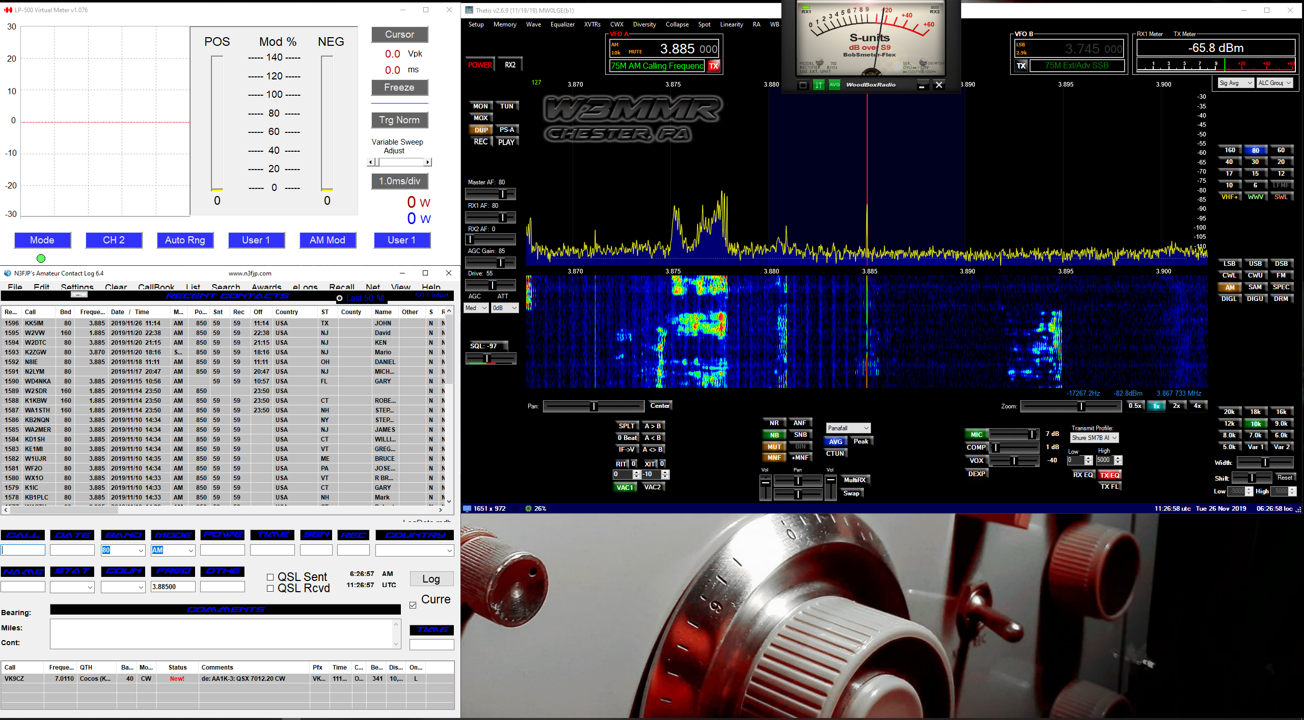

w-u-2-o wrote:I'm observing what is perhaps best described as "stuttering" in the rendering of the waterfall. Running DirectX, 32ms update rate on a 30Hz monitor. Panadapter is set for 30Hz. 768KHz sample rate, 2.93 Hz bin size, 120ms averaging.
Changing the waterfall update rate to be faster or slower makes no difference. Changing to GDI makes no difference. Averaging on/off no difference. It's just not completely smooth, it's a little jerky.
Anyone else notice this?
No issue here @ 144fps, 2560x1387 resolution, 1440p 144hz monitor, 384k sample rate, 2.930 Bin, 50ms averaging, 20ms update period. Also tried your settings with no issue.
