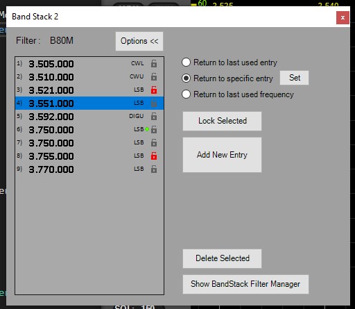

Just a quick question.
The current band stack system has 10 slots say per band stack. You can store whatever frequencies for the band you want in those slots. They can be in any frequency order, so when you cycle, the vfo can jump all over the place, up/down the band. You can hit the sort button to resolve this.
The new system has no slot limit. The stack presented is a filter applied to all entries. Entries have no idea of 'stack'. To display the stack of entries for 80M a filter is defined that selects entries based on band and frequency limits. An entry could technically be included in the result of another filter.
It is far easier for the new solution to present the stack pre-sorted. Anything you manually add will be included in the results of the filter and used as the bandstack in a sorted way. If you want me to implement a user adjustable sorting to the list, that that is going to be a whole bunch of additional work (and pain).
So what are the thoughts, do people use unsorted bandstack lists and jump all over the place? Or having it all sorted is an ok compromise?
Good morning Richie,
wow...that looks nice!
For me, the sorted list is 100% ok!

Posts: 1587
oe3ide wrote:Good morning Richie,
Cheers
It is working nicely at the moment Ernst. Just ironing out a couple of oddities, then onto saving/loading the data with the database. Also an import procedure that happens when migrating from old db version.
Then to build a manager so you can add your own filters.... I should have kept on with the bugs for a week more instead of starting this, but I needed a change.
Not sure it will be ready for weekend at this rate..... must.. type..faster !

ramdor wrote:Just a quick question.
The new bandstack looks really good. I also have had no issues with 21c. Plus the gradient really throws a pleasing look to Thetis.

Posts: 1587
If region is set to US in the current version Thetis locks you to specific frequencies on 60m each time you press the 60m button. It ignores the stack information for the 60m band totally, It does not allow you to use more entries in the stack. It just cycles through the five channels. Essentially the code is: If region is US then do channel based VFO update on 60m button click, otherwise use stack system.
I can implement this for the 60m band if in the US if you guys want to be locked down and limited to that, but blimey, dont you want to be able to define your own stack entries for the band? I can add the defaults channels already locked easy enough, but they could be changed by unlocking them. If for example, you wanted some extras, or the locked ones moved for different narrow modes.
Essentially, I would have to disable lock/delete/add buttons if region = US and on 60m band, so that the 5 default entries could not be changed.
What say you ? :)

"but blimey, dont you want to be able to define your own stack entries for the band? "
I vote for versatility over fixed and locked. You never know when the FCC might decide to change allocations or other rules on 60m and if things are locked like they are now then everyone would be stuck if you or another volunteer programmer wasn't around to change it when it happened.
Thanks for all your work Richie, it is really appreciated!!!
Joe W4WT
Posts: 6088
This is just my opinion, but 60M channelization for the US is so simple, I don't mind just clicking 5 times to roll through the entire band. Indeed, I've set up the current version so I see all 5 channels on the panadapter in all 5 60M bandstack entries, so I just watch the passband move from one channel to the next. That's how I operate on 60M, no doubt others have their own style.
To summarize: IMHO it's not worth a lot of effort to change the way 60M works now, but again others may differ.
To be my own devil's advocate: on the other hand, having the software function in a common manner on all bands provides a level of consistency that may be worth it by itself.

ramdor wrote:If region is set to US in the current version Thetis locks you to specific frequencies on 60m each time you press the 60m button. It ignores the stack information for the 60m band totally, It does not allow you to use more entries in the stack. It just cycles through the five channels. Essentially the code is: If region is US then do channel based VFO update on 60m button click, otherwise use stack system.
What say you ? :)
I vote for the unlocked and unlimited. This is the reason I chose this type of architecture to purchase over others.
I love the virtualally unlimited functionality and ability chose to make it what I want.Richie, Thank for all the time you take out of your life
to add to the fun this hobby affords.

Richie...
I'm with Scott on this one.
I think your valuable time could be better spent on things more widely used.
Thanks for all your hard work.
Carl

Posts: 1587
It is much easier to make it more flexible tbh.
One line of code to make it like all other bands VS a load of bodging, checking this and that to make it how it was
If it needs to add them in, they'll appear pre-locked when region is US. They can be unlocked/deleted/updated however.
21d will drop over the weekend, probably Sunday now. Still working through some stuff.
