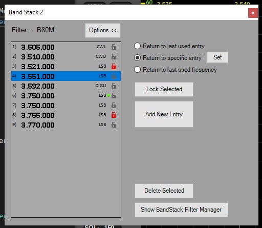

Just a quick question.
The current band stack system has 10 slots say per band stack. You can store whatever frequencies for the band you want in those slots. They can be in any frequency order, so when you cycle, the vfo can jump all over the place, up/down the band. You can hit the sort button to resolve this.
The new system has no slot limit. The stack presented is a filter applied to all entries. Entries have no idea of 'stack'. To display the stack of entries for 80M a filter is defined that selects entries based on band and frequency limits. An entry could technically be included in the result of another filter.
It is far easier for the new solution to present the stack pre-sorted. Anything you manually add will be included in the results of the filter and used as the bandstack in a sorted way. If you want me to implement a user adjustable sorting to the list, that that is going to be a whole bunch of additional work (and pain).
So what are the thoughts, do people use unsorted bandstack lists and jump all over the place? Or having it all sorted is an ok compromise?
Posted: Thu Jul 08, 2021 6:23 am
by oe3ide
Good morning Richie,
wow...that looks nice!
For me, the sorted list is 100% ok!
Cheers
Posted: Thu Jul 08, 2021 6:52 am
oe3ide wrote:Good morning Richie,
Cheers
It is working nicely at the moment Ernst. Just ironing out a couple of oddities, then onto saving/loading the data with the database. Also an import procedure that happens when migrating from old db version.

ramdor wrote:Just a quick question.
The new bandstack looks really good. I also have had no issues with 21c. Plus the gradient really throws a pleasing look to Thetis.
