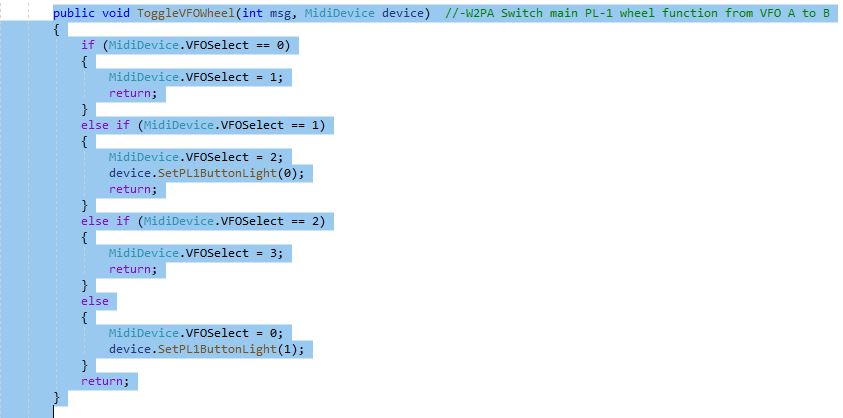

Midi-interface:
* 2TONE is missing in the mapping (or I've overlooked it several times)
* Toggle Wheel to VFOA/VFOB (last entry in commands)
What should this do? I assumed this swapped wheel control between VFOA and VFOB, but it does nothing (at least nothing noticable).
Posted: Fri Feb 11, 2022 12:18 pm
by DH1KLM
Hello Ernst,
2Tone is there and it is working for me. You can also test ZZUT1 to activate.
If I am not mistaken, Toggle Wheel to VFOA/VFOB only applies to Behringer CMD-PL1 Midi Controller
Posted: Fri Feb 11, 2022 12:32 pm
by oe3ide
DH1KLM wrote:Hello Ernst,
Hi Sigi!
amazing... I checked it 3 times ;-) ... now I have found it.
Thanks for the info about vfo-toggle.

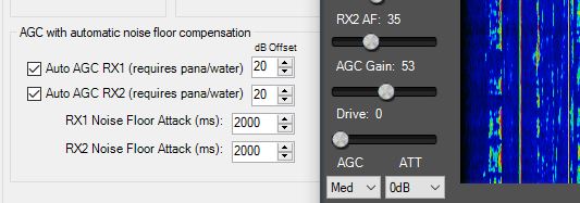

I need to revise my edit. https://apache-labs.com/community/viewt ... 210#p18093. KB5010472 is not the cause.
The problem is still there. Interesting is the fact that chkAutoAGCRX1 and chkAutoAGCRX2 are set to true in the database. "Auto AGC RX1" is also checked in Setup>DSP>ADC/ALC.
But in Thetis the AGC Slider remains grey and Auto AGC did not work. It almost seems like the GUI will not be updated.
no auto agc.JPG (30.96 KiB) Viewed 24133 times
The picture shows a running Thetis with a gray slider and the current settings in the setup. This combination should actually be impossible.
Is there a possibility that a certain Win10 service is responsible for this?
My system is trimmed for performance and a number of services are therefore deactivated.
In 21k7 it works without problems.
So something must have changed since 21k8.

Since this behavior also occurs with a blank database, I started to examine.
I've now gone the hard way and installed a clean Win10. All suggested updates were installed.
Thetis installed and updated to 21k9rc1(clean Database, noting configured except radio model). So far everything works as it should, including AutoAGC. No other programs and drivers installed.
Now I have installed the drivers for the MIDI controller and imported my MIDI profile, started Thetis and Bingo, AutoAGC no longer works.
MIDI driver deactivated in Device Manager, Thetis started and AutoAGC works again.
OK, so it has something to do with MIDI.
In the MIDI profile I have deleted the mapping for "RX1 AGC Level" and now RX1 AutoAGC remains green.
For "RX2 AGC Level" I have not deleted the mapping yet and RX2 AutoAGC is still grey. Now I have also deleted this mapping and AutoAGC for RX2 works again and is green. All good for now, except RX1/2 AGC Level should not be mapped to a Knob/Slider to prevent a non working / non re-enabled AutoAGC.
So if someone has not mapped RX1/2 AGC levels to a knob/slider, this behavior is not noticeable.
I don't think this error only occurs with Hercules DJControll mp3 LE.
Conclusion: Something regarding AGC must have definitely changed in the code from 21k7 to 21k8.
Posted: Fri Feb 18, 2022 4:19 pm
The change :
21k8
change: dragging agc gain slider, clicking G-/F-, changing gain via midi/cat/memory/andromeda slider window will cause 'auto agc' to turn off
I will double check that it is protected against same value updates. No chance to fix it today though, will attempt to sort it out for Sunday release.

I setup my DJ Starlight and set both left/right sliders as agc rx1 and rx2. I had to use bome midi translator to absorb a bunch of other midi messages coming off the slider.
When the software starts, all is fine, the auto agc stays green. As soon as a slider is touched it turns off, and works as expected for either rx1 and rx2. However, I did fix an issue with RX2 using RX1 data, so that might have been related. The only way for it to turn off is if the assigned agc level is different to current. Please let me know if it is fixed when rc2 comes out.
Posted: Sun Feb 20, 2022 10:12 am
by DH1KLM
To verify I started again with an empty MIDI profile and only mapped the RX1 and RX2 level controls to the knobs. The result is the same again.
Of course I will check rc2 as soon as it is out.
