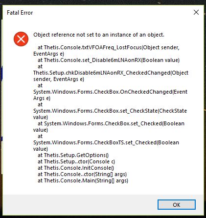

I installed today Thetis 2.6.8, it worked good here, TRX is Anan 200D vers.24. After i put all my Settings by hand in, I test Puresignal but it will not work very well.
I shut down Thetis, switch Anan off and on, but when try to start Thetis i get this:
[img]

What can I do now???

Re: 2.6.8
Post by DO2ZA Erwin »
I am not shure, but maybe a mistake by myself:
1. switch off thetis
2. shutdown thetis
3. switch off the Anan
an than....
4. start thetis an get the error
then thetis is shut down, I switch the Anan on, start Thetis and get the error again.
Can I try to install Thetis again??? Or is the Database broken ??
any Ideas???
73 Erwin

Hi Erwin,
I could be wrong but I believe that error shows up if you are using a text setting in Windows that is not the default 100% size. Right-click on your desktop and choose Screen Resolution from the menu that pops up. Then click on "Make text or other items larger or smaller" and check to be sure that you have selected the default setting of 100%.
Rob W1AEX
EDIT: Erwin, I knew I had seen that error box before but it was not from the font scaling issue that I first thought of. The Thetis thread below has some details on my startup issue when specific boxes were checked in the Thetis setup. Looks like Ritchie is already looking into it.
https://apache-labs.com/community/viewt ... f=9&t=3083

Hi Rob,
thanks for coming back, my text Scaling is still at 100%.
I have killed the Database, its running again, but Pur Signal is not perfekt, sometimes it corrects, sometime not.
When I disable the Auto Attenuator, it is better. I must test this, but for now I must put in my settings.
Thank you
73 Erwin

DO2ZA Erwin wrote:I am not shure, but maybe a mistake by myself:
2. shutdown thetis
an than....
any Ideas???
73 Erwin
It is a bug. To get around it at the moment, shut down thetis, backup your database. Open it with an editor, such as notepad+
Search for chkDisable6mLNAonRX
set the <value> key to False
Restart thetis. There are some nasty initalisation state issues that need fixing, this being one of them. If ever Disable 6m LNA RX is ticked on, Thetis will not start. Will fix this for c4 release.
Code: Select all
  <Options>
    <Key>chkDisable6mLNAonRX</Key>
    <Value>False</Value>
  </Options>

thanks for coming back. I was not shure but I thinks also it was this little Box, I have ticket!!!!!!!!
AAAAHHHHH, stop, I have put a big part of my Setting in, make a restart now: the same again, but the Box, I think, was not checkt,
I take a look in the data and tell you.
And by the way, your work here is really great!!!
Erwin

I changed the Key to "False", Thetis is running again. :D :D :D
Thank you
73 Erwin

DO2ZA Erwin wrote:Richie,
Thank you
73 Erwin
yes issue has been there since before I owned an anan. Odd that no one has actually had that check box enabled and restarted thetis.
