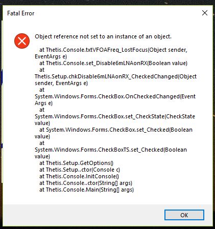

I installed today Thetis 2.6.8, it worked good here, TRX is Anan 200D vers.24. After i put all my Settings by hand in, I test Puresignal but it will not work very well.
I shut down Thetis, switch Anan off and on, but when try to start Thetis i get this:
[img]
Fehlermeldung Thetis .JPG (46.76 KiB) Viewed 35121 times
[/img]
What can I do now???
73 Erwin
Re: 2.6.8
Posted: Fri Oct 04, 2019 3:53 pm
by DO2ZA Erwin
I am not shure, but maybe a mistake by myself:
1. switch off thetis
2. shutdown thetis
3. switch off the Anan
an than....
4. start thetis an get the error
then thetis is shut down, I switch the Anan on, start Thetis and get the error again.
Can I try to install Thetis again??? Or is the Database broken ??
any Ideas???
73 Erwin

Re: 2.6.8
Posted: Fri Oct 04, 2019 4:35 pm
DO2ZA Erwin wrote:I am not shure, but maybe a mistake by myself:
2. shutdown thetis
an than....
any Ideas???
73 Erwin
It is a bug. To get around it at the moment, shut down thetis, backup your database. Open it with an editor, such as notepad+
Search for chkDisable6mLNAonRX
set the <value> key to False
Restart thetis. There are some nasty initalisation state issues that need fixing, this being one of them. If ever Disable 6m LNA RX is ticked on, Thetis will not start. Will fix this for c4 release.
Code: Select all
  <Options>
    <Key>chkDisable6mLNAonRX</Key>
    <Value>False</Value>
  </Options>

Re: 2.6.8
Posted: Fri Oct 04, 2019 5:14 pm
by DO2ZA Erwin
I changed the Key to "False", Thetis is running again. :D :D :D
Thank you
73 Erwin
Re: 2.6.8
Posted: Fri Oct 04, 2019 5:32 pm
DO2ZA Erwin wrote:Richie,
Thank you
73 Erwin
yes issue has been there since before I owned an anan. Odd that no one has actually had that check box enabled and restarted thetis.
