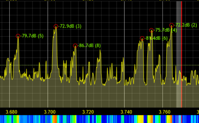

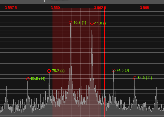

Posted: Mon Dec 09, 2019 4:45 pm
UPDATE
HI all,
Small update with the peak indicators, and a couple of other bits and bobs. Most of it is only implemented in DirectX at the moment. The peak detect is a simple algorithm, and does not use crossing point/smoothing/slope.
Quite handy for this sort of thing, with PS on :
Also, an experimental change to frame rate calculations that can be enabled with 'accurate frame timings' option. However, It sits in a very tight loop until the expected delay has passed and consequently is quite cpu hungry. It is perhaps only worth using if you have a work horse of a PC and want to test if it improves the micro-stutter in the waterfall.
Link : link removed, see post #1
(11/19/19) b2
-add(*): peak markers on the panadapter. Configure through Setup>Display>General. Note: this is a very simple algorithm and does not consider slope
-add(*): experimental accurate frame timing. This will probably have a substantial impact on cpu usage
