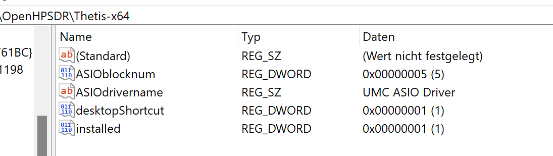

Re: cmASIO feature in Thetis
Posted: Sun Nov 10, 2024 12:14 pm
by Michael
forgot to send you the registry entries. Here they are:
Posted: Sun Nov 10, 2024 2:32 pm
Michael wrote:
I guess a solution would be to use speakers and a mic directly connected to the audio interface but currently cannot check as I miss the required adapter plugs. How have others solved the issue? Just staying with VAC and not using cmASIO? Any advise is appreciated.
You know, I totally missed this part of your original post. But when you posted:
Unfortunately I cannot use the Behringer input/output as I do not (yet) have the required plugs/adapter plugs.
All became clear :D
It's a very simple problem: you need to run your mic and speakers via the UMC202. That's why nothing is working. Because cmASIO completely bypasses both VAC in Thetis and the audio I/O on the ANAN. Until you get a mic and speakers on the UMC202 you'll have to use a different method. More on this below...
Maybe it works as it is supposed to work and I wrongly assumed that audio should be available at the computer and VAC could be used for e.g. digital modes only.
Yes, that's the way it's supposed to work :) If you want to use cmASIO for both voice and digi modes it's easy to do with the Voicemeeter audio mixer software from VB Audio. Install Voicemeeter Potato, assign the UMC as output A1 and input A1, then assign cmASIO to use one of the Voicemeeter virtual ASIO channels (B1, B2 or B3). Digi mode software can go to one of the other virtual channels in the normal fashion. Then mix and route in Voicemeeter to your heart's content.
