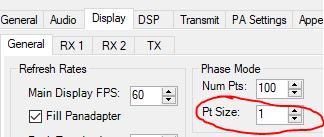

- add: option to increase particle size in phase

NC3Z wrote:Where do you set particle size for the Phase?
