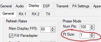

Where do you set particle size for the Phase?

NC3Z wrote:Where do you set particle size for the Phase?
Re: 2.6.8
Posted: Mon Oct 07, 2019 1:50 pm
by NC3Z
Thanks Ritchie, make sit easier ti see them now.
