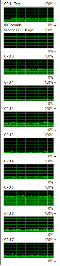

Ive noticed the same thing, but even with "AFT" unchecked, one core is still taking the brunt of the load, 65%, while all the other 7 are running anywhere from 10-20%. Can this be adjusted in the bios? Running an i7 4770.

I had a quick look at the cpu% code and it is currently reporting total cpu% usage of the entire system, which is why we tend to use resmon or something similar to find out how much Thetis is actually taking. I have quickly changed it to reflect the process %cpu that is being used by Thetis. This calculation is an averaged value based on 'cpu count' in the system and will more accurately display how much % thetis is actually using. It now shows the same value as ResMon +- 1%
I have been thinking about the warning symbol for seq errors and may change it to only show it if there are -ve numbers. Positives alone are somewhat meaningless, only telling us that there has been some missing packets. I don't think we have yet seen any major repeatable widespread occurrences of -ve value patterns that could be fixed by an implementation of the pack reordering system.
I wouldn't worry about where the threads are running, we don't set any affinity, so they get scheduled onto which ever processor (core/virtualcpu) the OS thinks is best. As a result you may see a peak on one compared to others(s).
