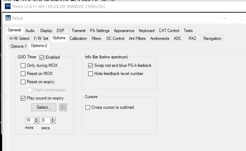

Ruben, will the timer already built in not work?
Screenshot 2022-03-13 170957.png (90.62 KiB) Viewed 22120 times

Gary, Yes it could and I have already thought of that. The issue is that the QSO timer only runs during MOX.
There is a box labeled "Only during MOX". I thought if I were to remove the check mark it might start running on MOX. Then, keep running when not transmitting and reset at 10 minutes. If the "Only during MOX" is not selected, the timer doesn't run under any cond1ition.
This may be a bug or by design. I don't know. It seems the ability to select it or not is there for some reason.
So, maybe my request should have been to give this timer the ability to run and/or reset when NOT transmitting. (MOX).
Plus, keep running up after it automatically resets.
If this will already run when not transmitting I will write this up as another Post Covid DUH! moment.
Thanks for the response Gary!

You probably want Reset On Expiry checked. And then every time you start Thetis you need to enable the Timer (lower right of the GUI, the stop watch, left click it to turn green).
A useful option would be a setting to make the timer start with Thetis, or maybe on the first PTT.

turn 'only during mox' option OFF, and click the clock on the status bar to stop/start it. It will continue to run, timeout, and reset and run if you have reset on mox turned on.

ramdor wrote:turn 'only during mox' option OFF, and click the clock on the status bar to stop/start it. It will continue to run, timeout, and reset and run if you have reset on mox turned on.
There are a lot of options for the QSO timer, perhaps too many. FWIW, I recommend only turning on "Reset on expiry" and "Play sound on expiry". This limits the amount of obsessiveness required. Sit down at the radio, start the timer. If you start a QSO you start with an ID. The timer will expire in under 10 minutes from that time. ID then and then just match up with the timer after that. If you are not in a QSO it'll make a sound every 10 minutes which, if a nice, subtle sound is chosen, is not intrusive. What's the big deal?

Yep, clicking on the status bar works great! I've tried several things, but never thought of clicking the timer on the status bar.
Thanks Richie! Thanks Scott!
