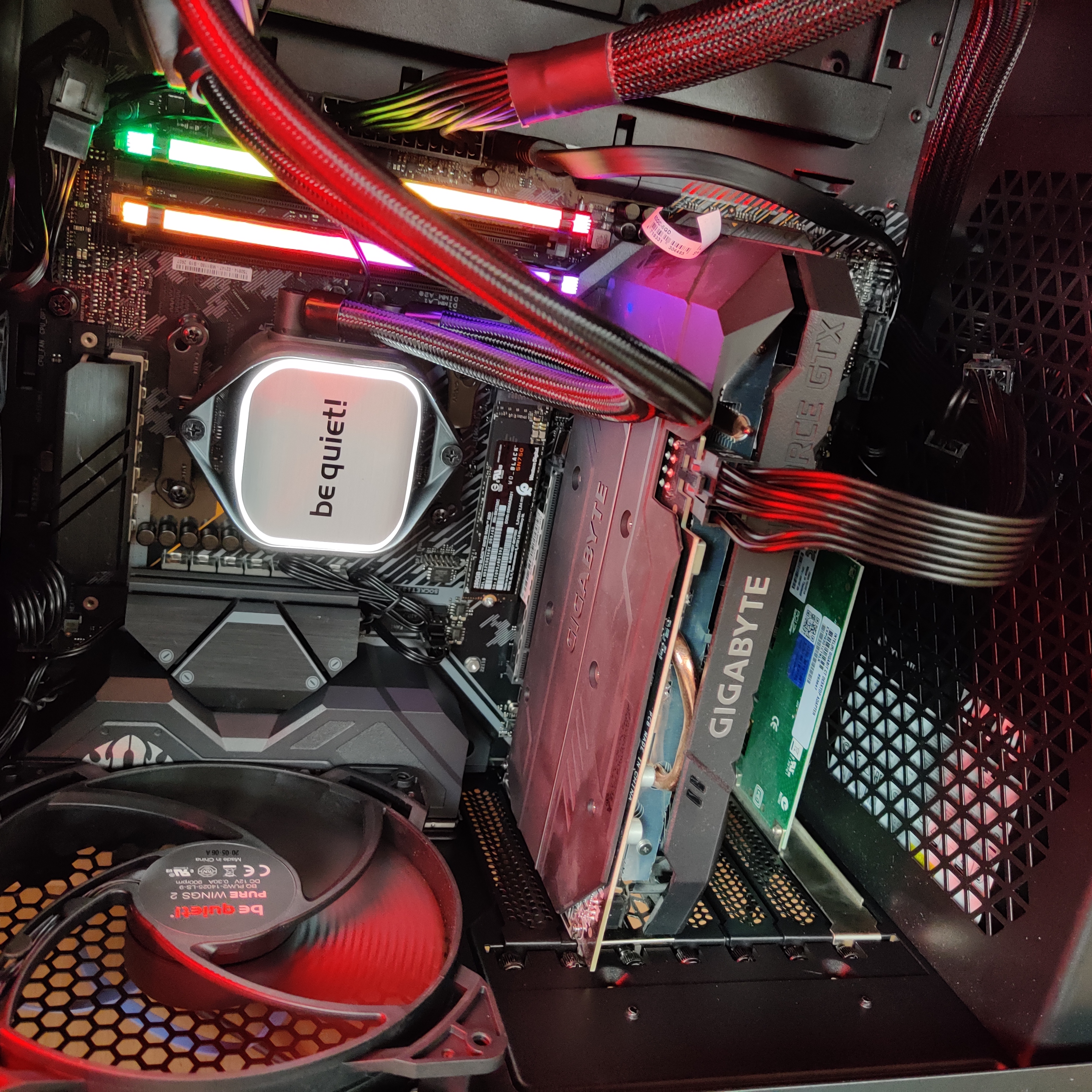

Posted: Fri Sep 03, 2021 2:21 pm
by Tony EI7BMB
Latest build just completed using X570 Motherboard and AMD 5950 16 Core CPU . Thetis load showing 4% and I can run JTDX at full throttle with good lag times .
