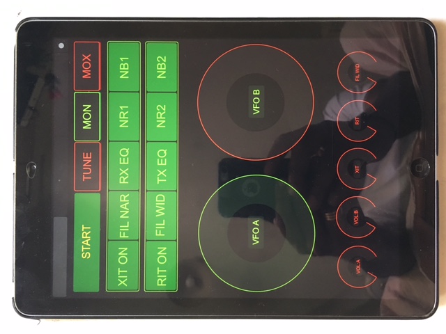

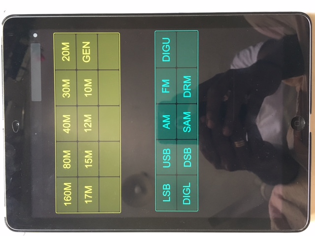

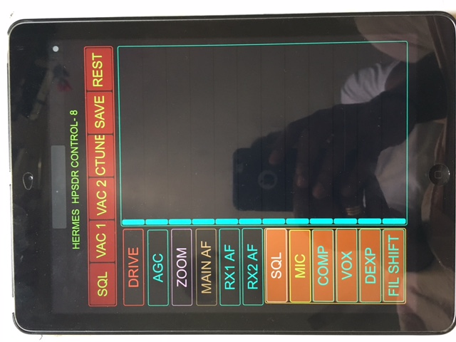

Please find attached the layout details I prepared modifying your layout and referring to some other sample layouts.
I have 3 Pages in my Layout as attached. If anyone interested, I can share the OSC design data file.
73s
Prem

Posts: 6110
Re: TouchOSC custom tablet MIDI control surface
Great job, Prem! Excellent use of the multiple screen capability of TouchOSC, too! :) :) :)
Now you just need a wireless headset so you can roam around with your tablet and work the radio wirelessly!
And, when you decide you want to change something, you can! :D

We miss the Freq read out when away from PC screen ! We should be able to see the freq ! Rest all OK .
Also I noticed we don't have option to MAP few things as :
1. RX1 AF
2. CTUNE
etc.
73s
Prem
Posts: 6110
Prem,
RX1 AF and CTUN are both available MIDI commands. Look at the list more carefully.
Any others you think you are missing?
The lack of a method for displaying frequency over MIDI is a consequence of the fact that the vast majority of MIDI controllers have no provision for displaying frequency. TouchOSC is a notable exception!
