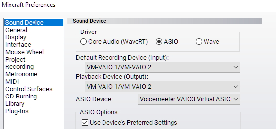

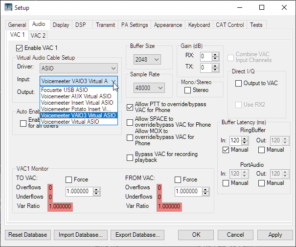

Ok, I guess I figured it out. I send Mic to B3 (VMP VAIO 3) and set VAIO3 as sound-device in Mixcraft. If I send virtual input 3 (VAIO 3) to A1, I can monitor the processed audio :-)
Using VAIO3 in openHPSDR should then receive the processed audio from DAW-app.

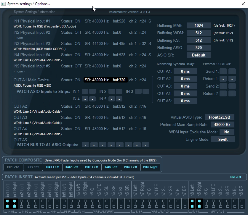

Focusrite: use ASIO as input:
1) deselect the WDM Focusrite USB on hardware input 1
2) patch focusrite asio input strips 1 + 2 in the system-settings to hardware input 1:
This makes a huge difference on the delay.

Sorry for the delay in responding, but this response required me to sit down at a real keyboard for more than 30 seconds, something I haven't had the chance to do until this morning.
Mic (Focusrite ASIO *) => DAW-App => openHPSDR VAC1
The "proper" way to do this is as follows:
1. Assign HW input 1 to Focusrite ASIO (mic inputs 1 and 2).
2. In VMP System Settings, enable the patch inserts for In1L and In1R.
3. In your DAW, select the hardware device Voicemeeter Insert ASIO Driver.
4. In your DAW, assign input channels 1 and 2 of the Voicemeeter Insert ASIO Driver as appropriate for processing in your DAW.
If these were "real" mixing consoles this would be the equivalent of plugging a patch cord into a pre-fader "send" on channels 1 and 2 of the VMP "mixing board" and patching it over to another "mixing board" (your DAW).
At this point you should be able to see input from your microphone in your DAW, where you can process and route it to your heart's content inside the DAW.
Now you need to get the results of the DAW back into VMP for further routing. Since this is the equivalent of a hardware studio pre-fader "send"...
5. Assign the results of your DAW processing to output on channels 1 and 2 of the Voicemeeter Insert ASIO Driver device.
The results will arrive back into VMP HW input 1 on the L and R channels before the VMP HW input 1 fader. You can then further process or route them as required.
6. Assign PowerSDR VAC1 to use one of the three VMP virtual channels, for instance the first one, Voicemeeter Virtual ASIO (yes, they have such terrible names, it is easy to be confused).
7. Activate the correct route button on HW input 1. Again, in my example, that would be B1.
This is actually how I used to have my audio set up. I used VMP as a glorified patch panel. There is no other way to connect multiple ASIO devices together (in this case PowerSDR, the DAW, and the actual sound interface hardware). I used no processing in VMP and I left all levels in VMP at 0dB. All of the VMP channels were "patch inserted" into the Reaper DAW, where I did a ton of processing on all of the audio.
Nowadays, with the really fabulous audio processing tools in PowerSDR (and even better in Thetis), I don't need to do any processing in a DAW.

thanks again for your excellent explanation. The PRE-Fader patching <=> "Voicemeeter Insert ASIO Driver", that was the missing link :-)
In my case I had to use "Voicemeeter Potato Insert ASIO".
I tried this already before, but in Mixcraft 9 I got an error ("Unable to open the playback device")
"Voicemeeter Potato Insert ASIO" works fine on Ableton and Reaper :-)

I just checked and they are selectable options in WSJT... since the radio did not 'see' them, I can not verify if they actually work.
Which version of wsjt-x are you running. Here on 2.1.2. 0068f9 there are no ASIO drivers selectable in the audio-menu.
Don't be confused about the naming, there are listed some VAIO drivers, but they are not ASIO ;-)

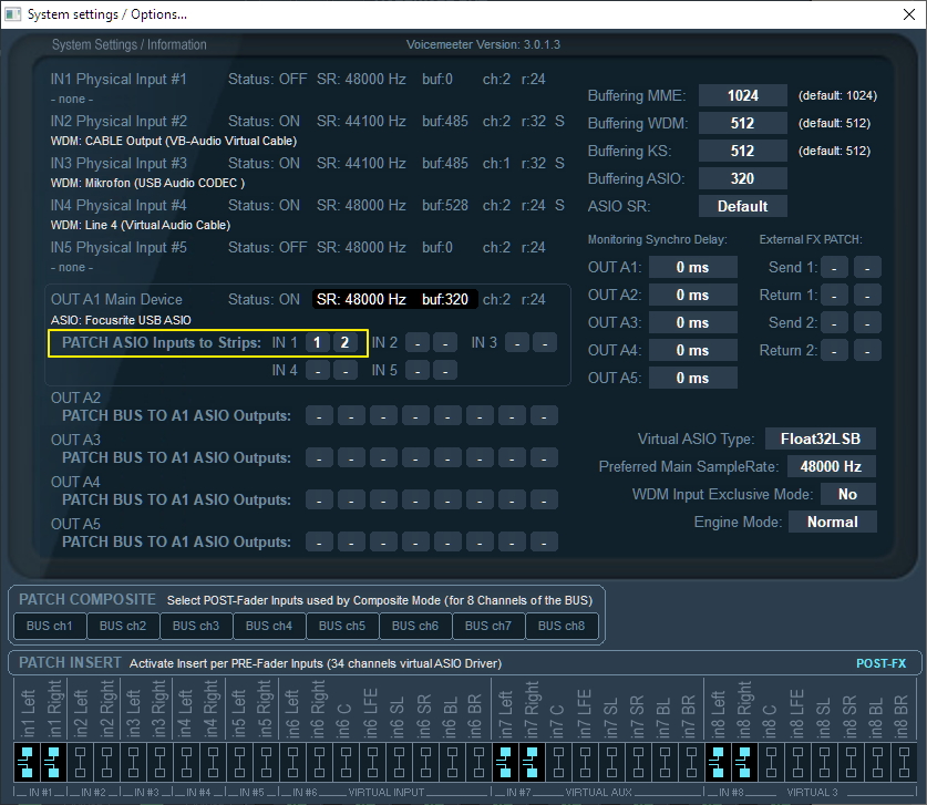

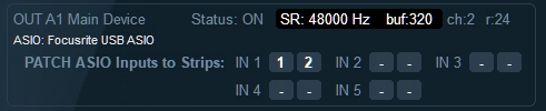

This might be the key... I checked and did not find the ASIO selections in VMP. I had MME, WDM, and KS options available, but no ASIO.
I had the same problem with my focusrite. They are not visible in the hardware-input dropdown.
For me, this procedure does the job:
1) de-select the audio-device on hw-input 1
2) go to "Menu / System-settings" and patch Asio ch1 & ch2 to the input strips:
focusrite asio input.jpg (38.17 KiB) Viewed 17138 times
73s de Ernst
