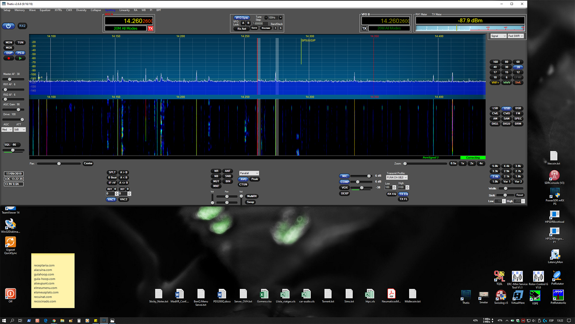

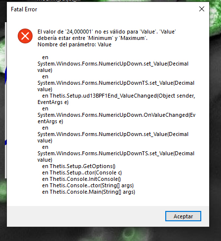

Hey all!
My 200D Rev 24 got pretty weird with 2.6.8 on many points and I was forced to go back to 2.6.7.
To mention one thing, there were four decimal places on the frequency and they could not be zeroed. After a while, it also crashed.
Compare the XML documents to both versions and see that points are used in the new but the comma in the old one and assume it has to do with the thing.
Otherwise, it looked really nice with the new features and looks!
Looking forward to the development of this :)

Impossible to set up new thetis 2.6.8 on my Anan 7000 DLE running P2 2.0 Pre1.
Always ending with a crash. I've deleted all directories (in "program files" and "users") and started building it 100% from scratch (except for my transmiting profile that I always import).
Today, with the latest build from GitHub, (I've tested every single build) while I was setting it up I've clicked on the screen to tune one station on 20m and both VFOs changed to 61.440 and decimals changed from .xxx to .xxxx
I can switch to any band again clicking on it, but the VFOs are still showing 4 decimals
After this crash (I got the same crash every time with every build) Thetis never starts again and always shows the same error.
To restart Thetis I must delete my current database and import a saved one.
I don't know what's going on!
Help please
Excuse me for my bad english...
