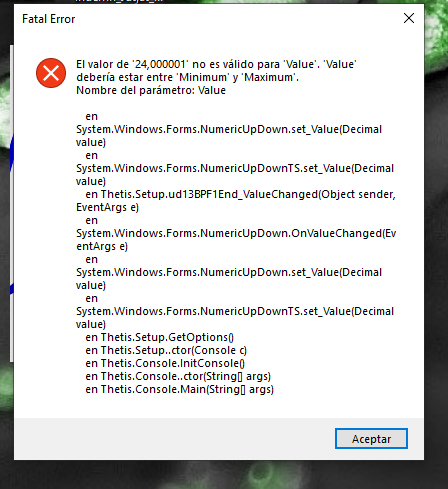

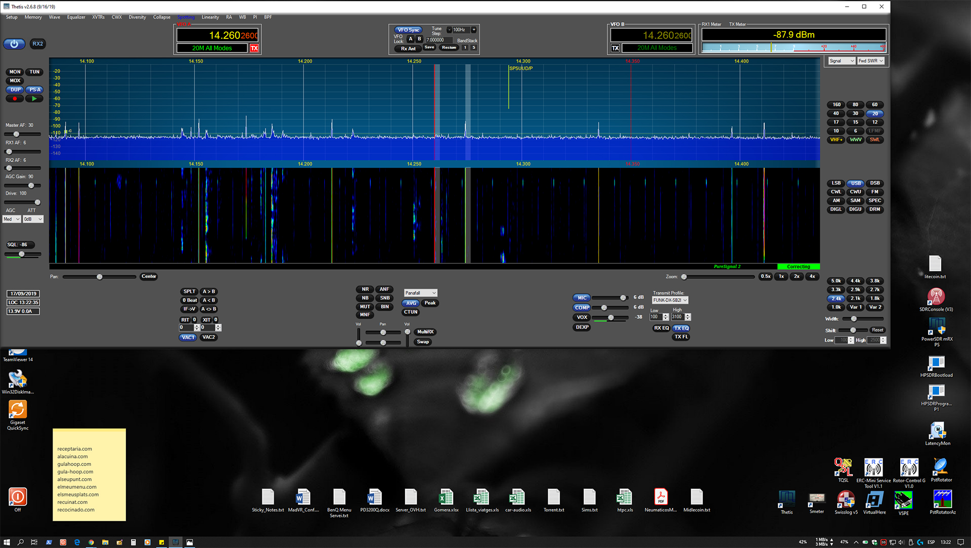

Impossible to set up new thetis 2.6.8 on my Anan 7000 DLE running P2 2.0 Pre1.
Always ending with a crash. I've deleted all directories (in "program files" and "users") and started building it 100% from scratch (except for my transmiting profile that I always import).
Today, with the latest build from GitHub, (I've tested every single build) while I was setting it up I've clicked on the screen to tune one station on 20m and both VFOs changed to 61.440 and decimals changed from .xxx to .xxxx
I can switch to any band again clicking on it, but the VFOs are still showing 4 decimals
After this crash (I got the same crash every time with every build) Thetis never starts again and always shows the same error.
To restart Thetis I must delete my current database and import a saved one.
I don't know what's going on!
Help please
Excuse me for my bad english...
