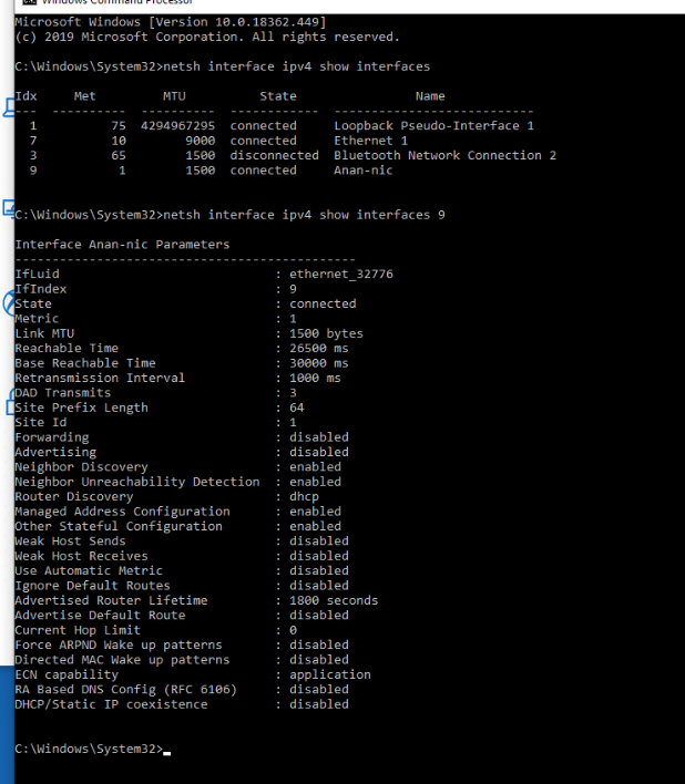

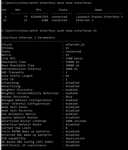

w2ner, Nicholas, before you move over to dedicated nic, can you run the following commands in cmd window...
The first gives you a list of interfaces, use te number on the left to pass into the next command to get the data. Screen shot that, and repeat on with the dedicated NIC.
Could provide some important info. Cheers, Richie.

ramdor wrote:w2ner, Nicholas, before you move over to dedicated nic, can you run the following commands in cmd window...

w2ner wrote:I'll do that today. I changed a NIC card setting and enabled "Jumbo Packets" and it seems to have fixed it. I have some things to do in the yard but I will leave the systems running and see if it logs anything. I'll post an update later today.
Very interesting, I didnt change that setting when I was testing earlier in the week.

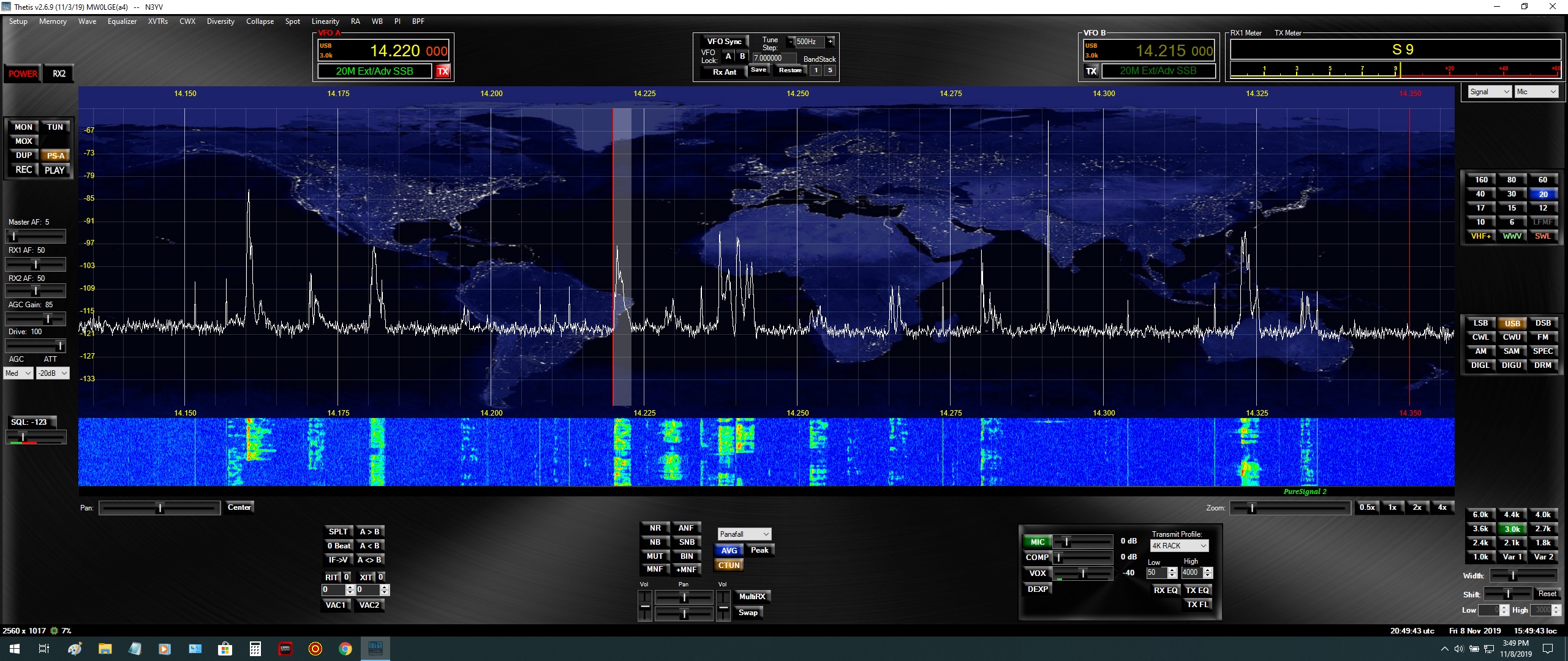

Screenshot 2019-11-08 19.25.51.png (1.93 MiB) Viewed 32408 times

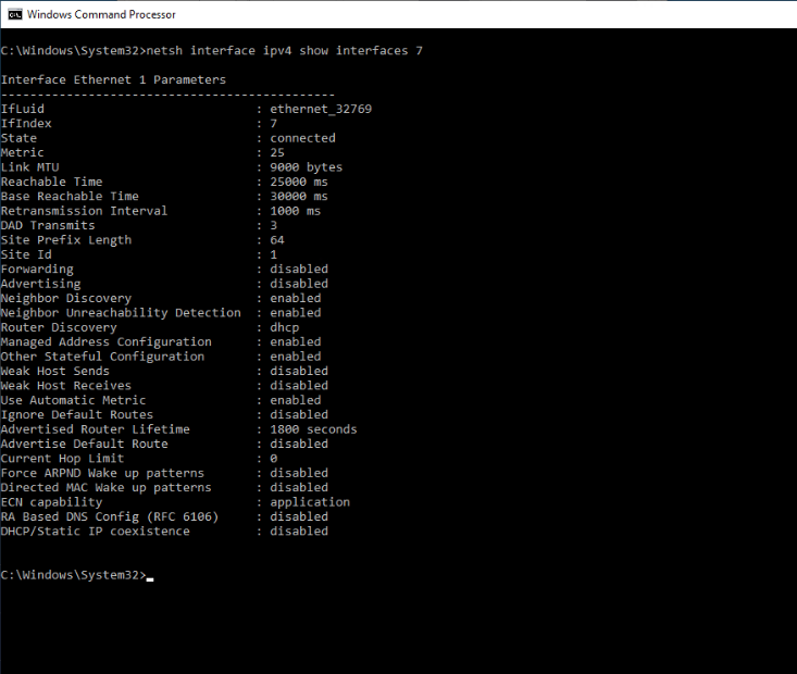

Here ya go Richie. First one is direct and the second one is on the network.. Also, with the "Jumbo packets" enabled, I did see Seq errors again so, not much of a change. The only thing I saw was, the 396 number in the log went from that to I think 63 (forgot to get a screen shot). On direct there is no errors.

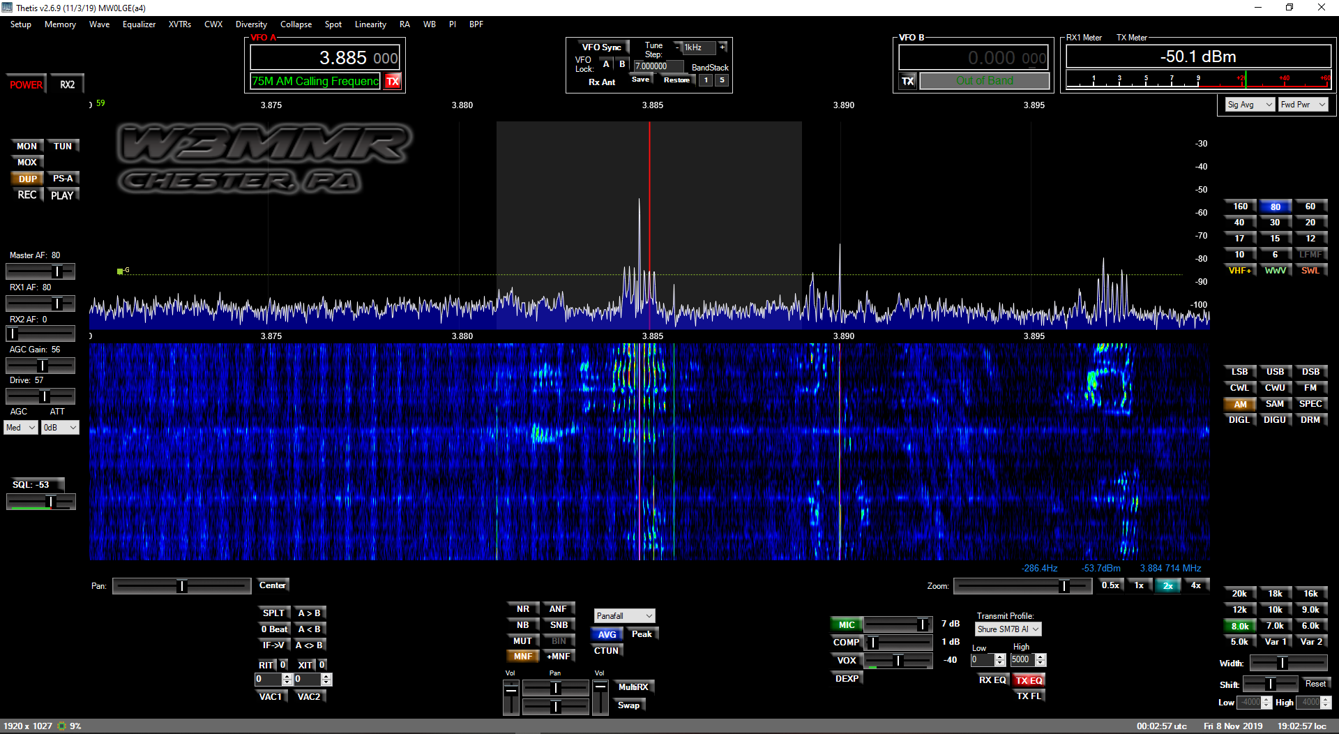

W3MMR
Posts: 148
Location: Springfield, PA
Re: 2.6.9
Post by W3MMR »
Working Great. Thanks Richie!

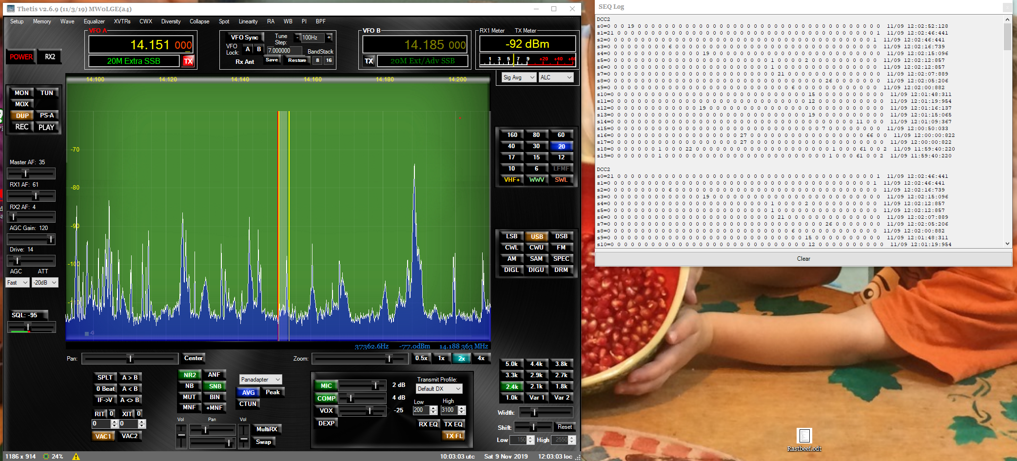

Here it is on my 8 core AMD Ryzen 7 2700X CPU with 16GB DDR4 and NVIDIA 1050 TX. I am also getting some SEQ errors (attached is the SEQ Log).
Hope it's useful. BTW, on the screen it shows 24% CPU usage which is unusual. Usually it's 10-11%.
73 Isaac 4Z1AO
SEQ.docx
SEQ Log
(6.32 KiB) Downloaded 1185 times
Screenshot
Screenshot
SS_2019-11-09 120657.png (1016.3 KiB) Viewed 32320 times
