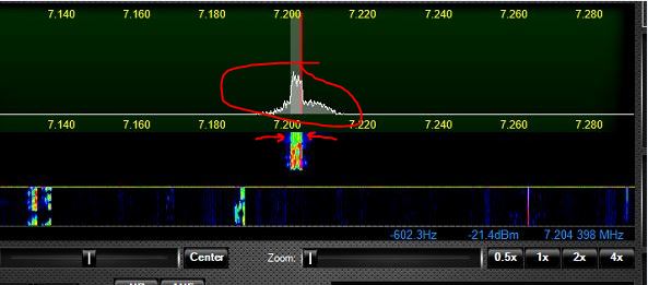

Reloaded P2 FW / Orion_1.9.16 again. Identified a kind of audio artifact/tale after talking but still keeping the MOX button on. Its almost like and over modulation noise/hiss. This is the issue I was getting on my 200D previously only worse. Anyway, its this artifact that trips out/sends a high SWR reading to the SPE 1.3K FA amplifier out of operate mode and the buffer alarm states high SWR.
I did take a screen shot of the tail artifact on TX.
P2 FW / Orion_1.9_pre4 works ok. Only now and then do you have to toggle the PS button for PS to engage. Overall pretty good on all bands.
