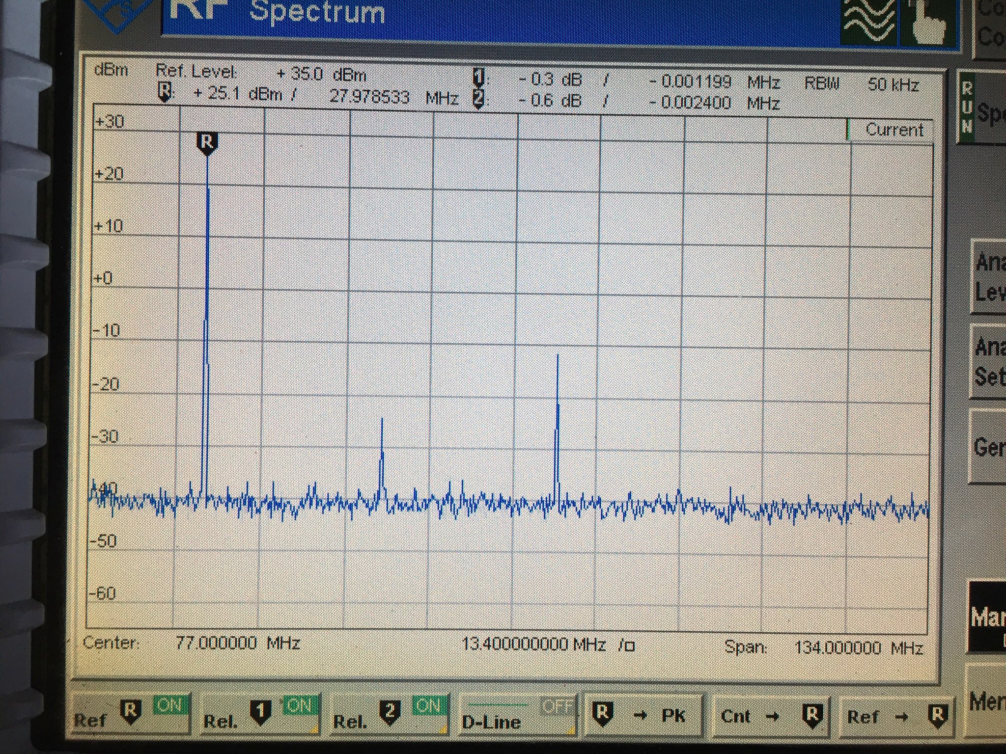

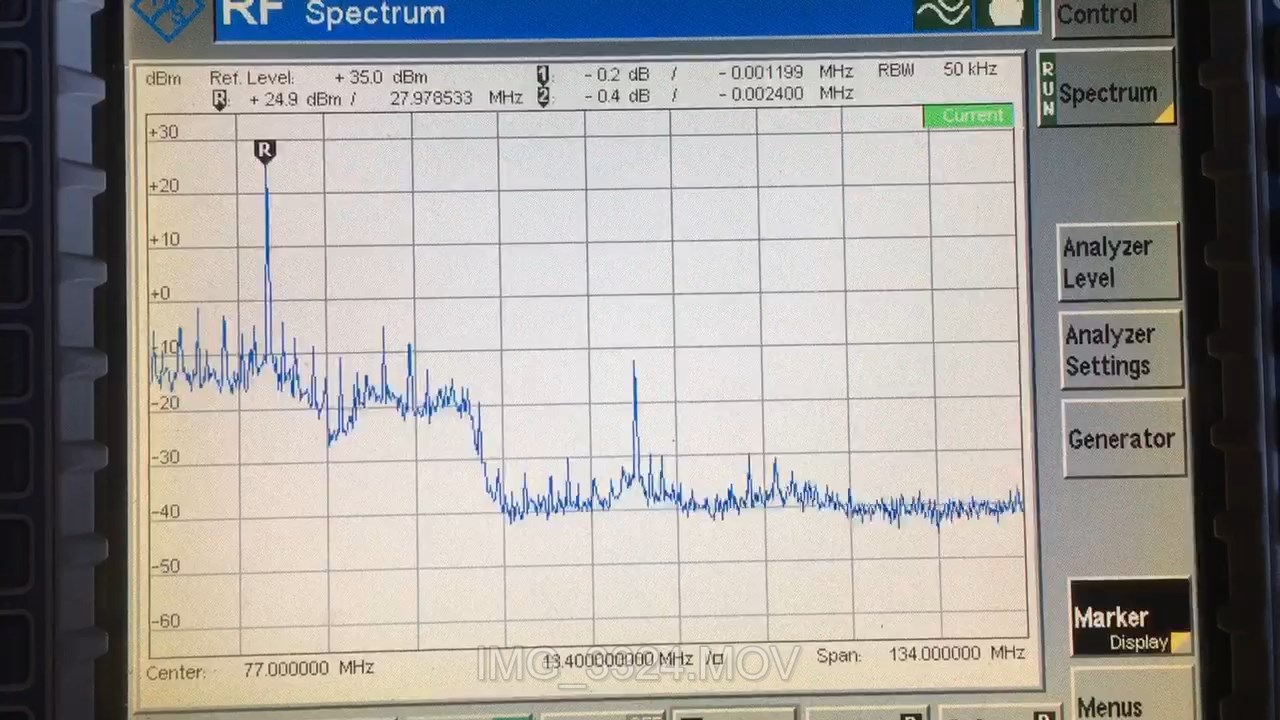

Dear friends,
I have got a 100D on my bench for checkup and testing firmware versions. I use a spectrumanalyzer at tx out (J3) of the Angelia board to check the spectrum from 10 to 144 MHz (the CMU200 starts at 10 MHz).
With v12.1.6 the spectrum is cleaner than that from v12.0. The pictures show a 28 MHz tune signal after some minutes of warm up.
Now comes the interesting part: With v12.1.6. and cold spray on DAC U5 I can get the noise down to be almost as good as with P1 V6.0!
Since there is no feedback from DAC to FPGA I would assume that this noise is not caused by timing closure.
I would like to get some feedback from the audience before I go further and replace the DAC (AD9744ARUZ, 19€ at Mouser). Does anyone have experienced DAC failure modes similar to this one?
I checked the 3.3 VDC at F3, there is only a 30 mV drop from 3.105 V with P1 to 3.086 V with P2, both measured at tx.
- P2 Version 12.1.6
- P2_V12.1.6.jpg (197.09 KiB) Viewed 42172 times
- P2 Version 12.0
- P2_V12.0.jpg (188.43 KiB) Viewed 42172 times

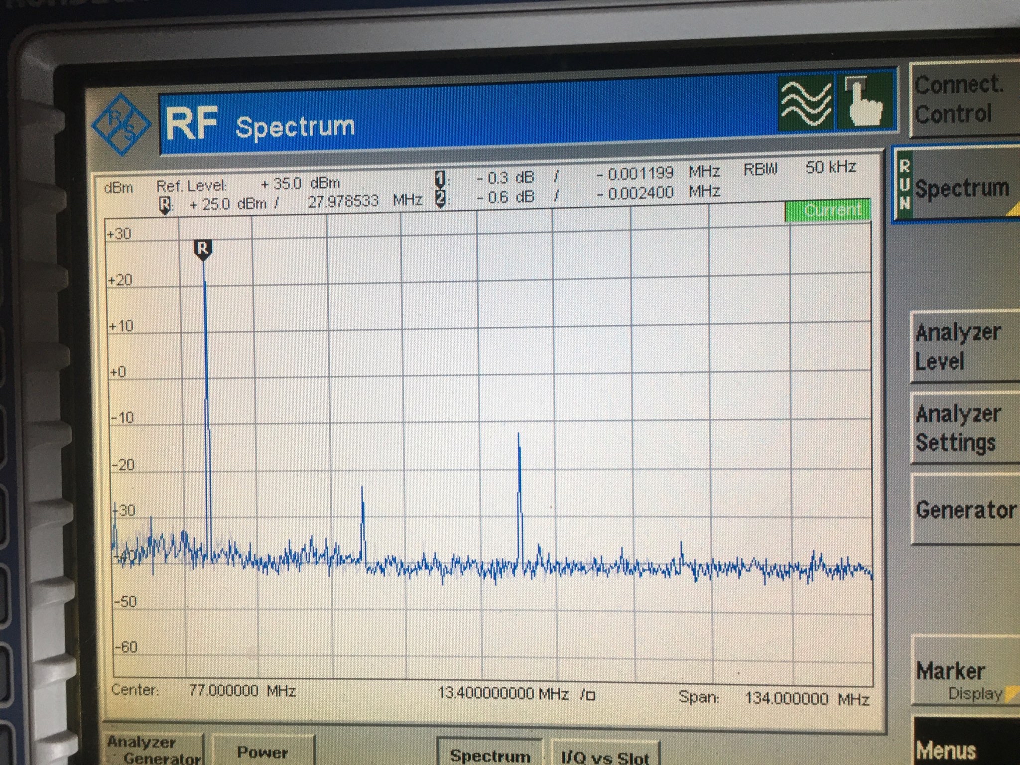

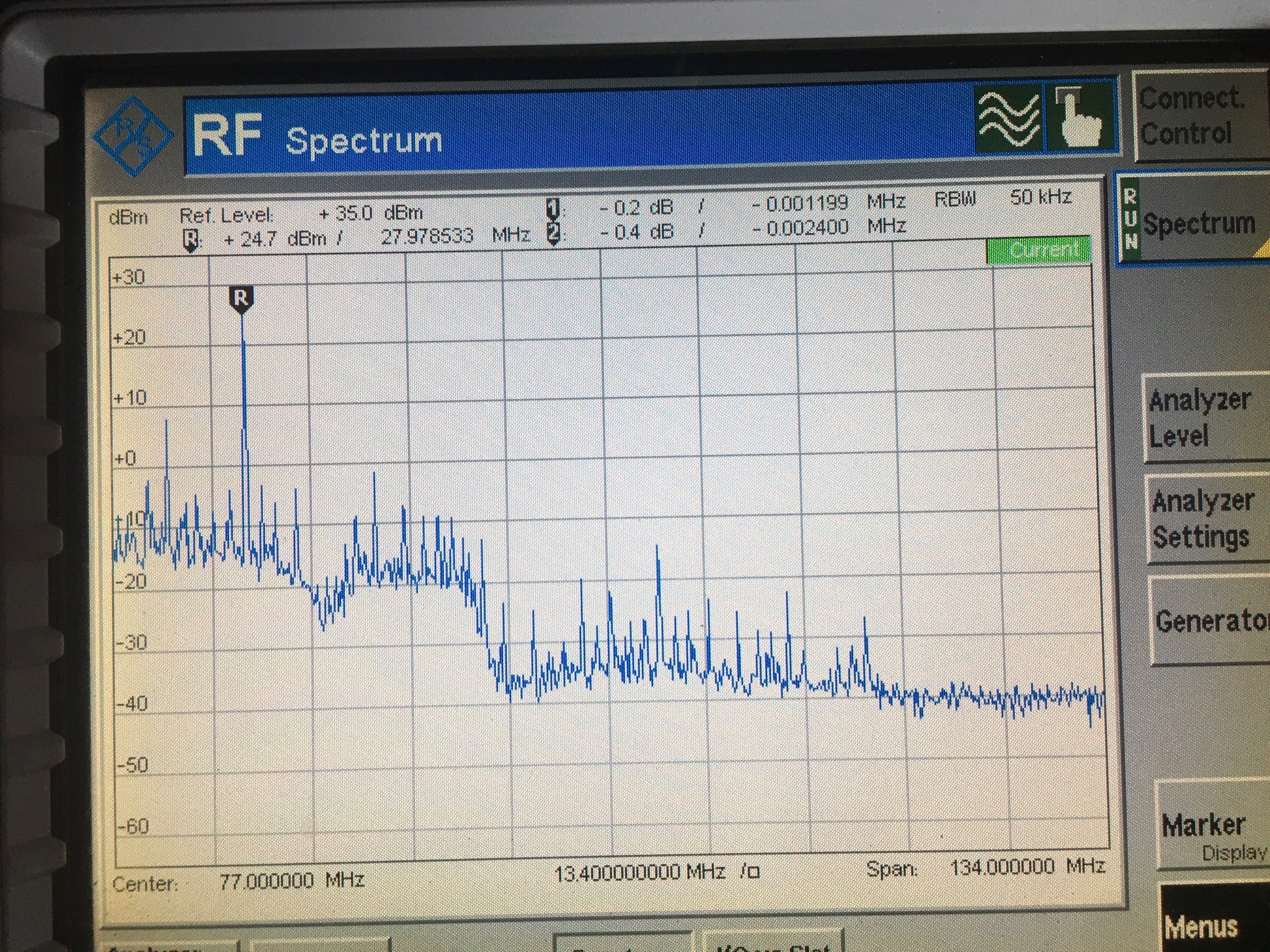

Re: New 100D Angelia Protocol 2 Firmware Topic
The noise floor of the spectrumanalyzer is just below -40 dBm without signal. The tune signal at 28.050 MHz is around +23dBm. The noise / spur at 10 MHz did show up to 10 dB difference, but it could be that I checked that at different times (temperatures) after flashing another firmware.w9mdb wrote:Not clear to me that you're lowering noise or just the noise floor.
Are you using a signal generator for your reference level? That level went down 1dB
I should have provide you with pictures before / after cold spray. This is how it looks with v12.1.0_pre2_5550:
- U5 warm
- before_cold_spray.jpg (2.52 MiB) Viewed 42164 times
- U5 cold
- after_cold_spray.jpg (2.11 MiB) Viewed 42164 times

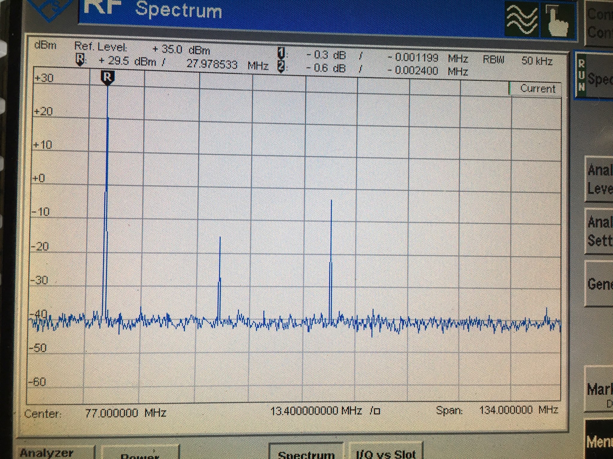

Tnx Rick! I will try that "tomorrow"! It's just before real midnight and I am just back from late shift. Bed time nown1gp wrote: I made some changes that should agree with setup and hold times better. Could you please try:
https://www.dropbox.com/s/cl54cp3wb4c9n ... 8.rbf?dl=0
EDIT: Morning Rick! The v12.1.8 seems to work perfect regarding the spectrum purity! Transmitting for more than 20 minutes and the signal is perfectly clean from the beginning (flashing). The temperature at the FPGA heatsink is 60°C (140°F) and DAC is 40°C (104°F).
Thank you Rick, well done! We owe you a beer!
The power reading of 25 dBm is without any calibration, but added attenuator values into the CMU200 settings. I just use cables out of the junk box and well used attenuators!
- Angelia_fw_12.1.8.jpg (1.26 MiB) Viewed 42032 times

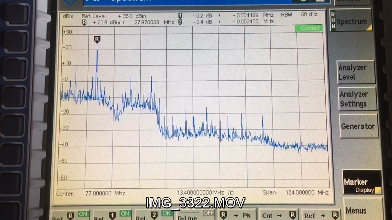

Hi Rick,n1gp wrote:That's great news Norbert. Tnx for testing that out.
I notice in your signature you have a 7000 as well. Have you, or could you
also test your 7000 to check how clean the TX spectrum is with the latest
firmware?
https://apache-labs.com/community/viewt ... =32&t=3192
I use 2.1.18 daily since release and have never seen any problem. The spectrumanalyzer shows the same clean spectrum like the Angelia with the latest release.
This measurement was not done with the maximum power available from Orion MKII!
- Orion_MKII_fw_v2.1.18.jpg (2.96 MiB) Viewed 41990 times
