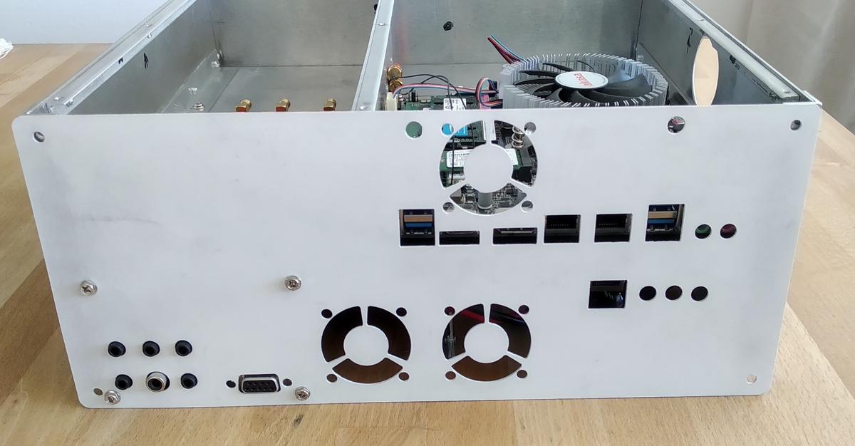

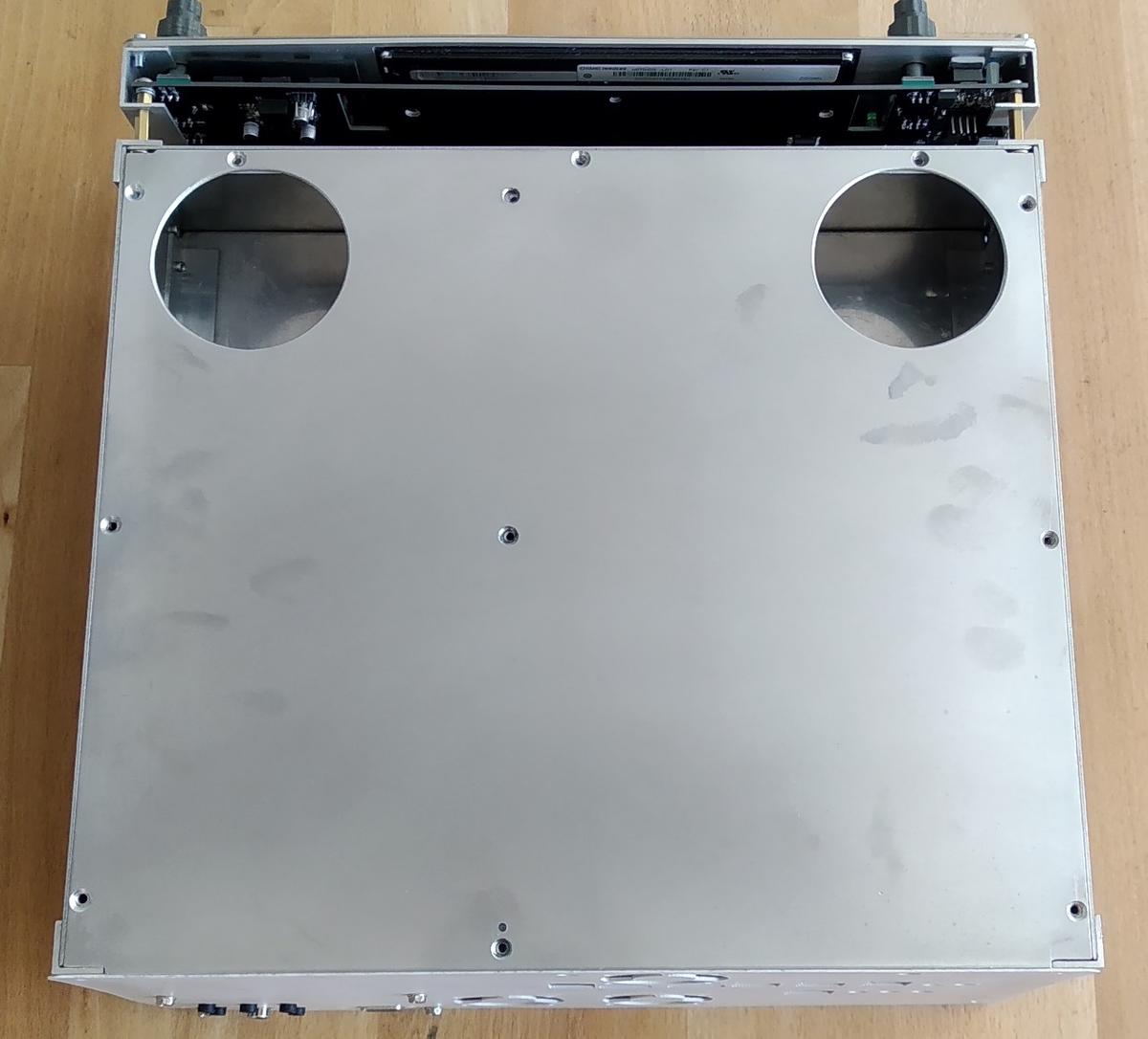

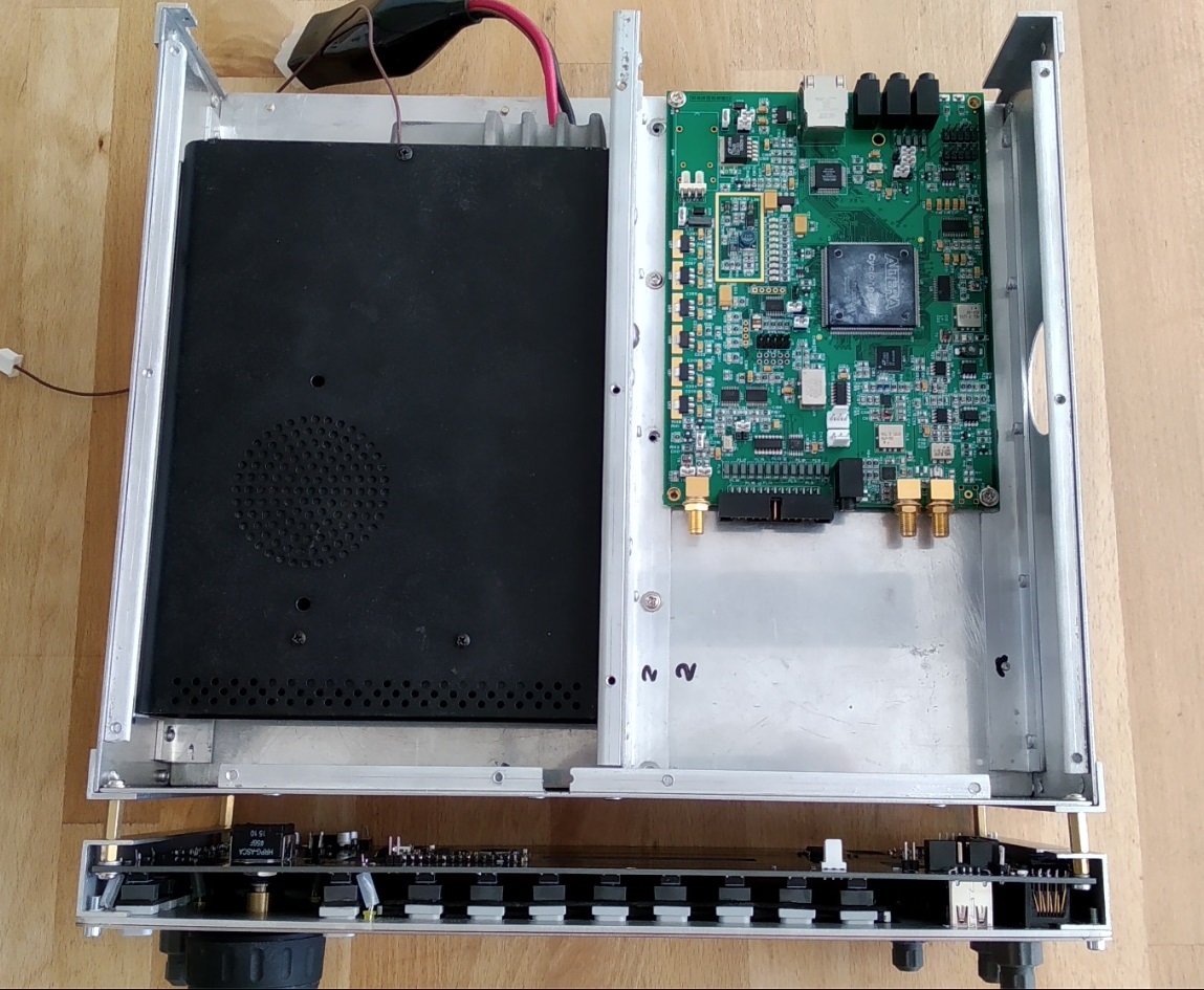

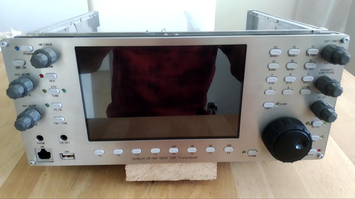

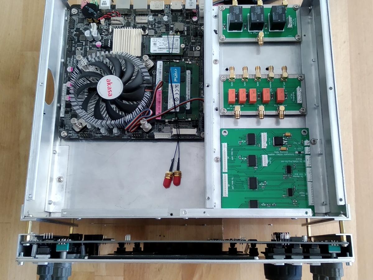

I hope it is OK to show my Andromeda progress so far, but for some reason I can not upload attachments. :?:
I linked the pics from my qrz.com.
The case is nearly done, every here and there are parts which need to be rearranged.
Building the case was the most time consuming process. Last part is the rear plate with all the mainboard and hermes connectors, Fan cutouts and so on. And of course the upper and lower housing.
So there is progress, but there is still a lot to be done.
I also used these encoders from Aliexpress. Regarding the LED's, there is no need to worry about.
You can use what you like. I found LED's which are not so bright, are looking more pleasant.
Regarding the buttons, Kjell has published the print files on https://www.thingiverse.com/thing:4245135.
My front panel is 3mm thick to compensate for the protrusion of the microphone jack and the USB port, because I didn't like the look.
See also https://apache-labs.com/productImages/1 ... pdated.jpg

@Aivars
I had the front and back lasered by a local company. I got the panels at a very, very affordable price.
Positioning the cutouts in the front panel was very time-consuming, as the cutouts in the construction file I had at hand did not match the PCB 100%.
I also had to change the coutouts of the lower row of buttons because I'm using a different LCD display.
For your Interest: In the original fpd file, the cutouts had different distances to each other (also the pcb). Cant speak for the updated file.
So please double check the gerber against the frontpanel design file.

The construction of the back panel was also time-consuming because I had to measure every section. Printed out on paper and cut out, changed a few tenths again, and so on until it fits.

You're right about the black box. It's a cannibalized Yaesu FT857. Inside is the PA board and where the main unit was originally located is the PA driver from the FT817. An Arduino that controls the PA, LPF and fans is also built in.
I hope that I can finally start with the cabling at the weekend.

My VFO knob is from Yaesu FT857. As already said the frontpanel was cheap. I paid with some other aluminium parts 20€ or so.
