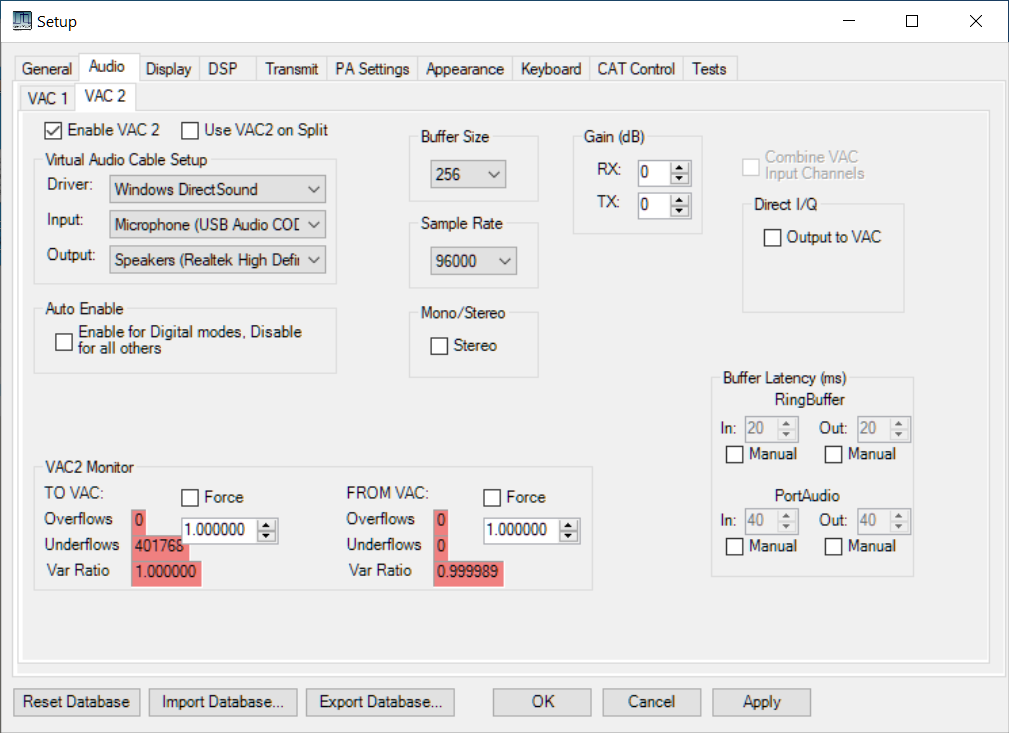

I posted this in a different thread but I suspect I should have posted it here...
VAC1 is stable on v2.8.8 but I'm getting crazy runaway Underflows on VAC2, nothing I change on buffers, sample rates or Force even slows it down.
This wasn't happening before, including in yesterday's v2.8.7, so I suspect something has changed in v2.8.8.
I need VAC2 for digital modes so I'll probably revert back to v2.8.7.

Mark, see my reply in the orig thread.K1LSB wrote:I posted this in a different thread but I suspect I should have posted it here...
Re: Thetis 2.8.8 Released!
Bryan,
Thank you sir, you nailed it! The RX2 receiver was not running. I turned it on and VAC2 is behaving correctly.
