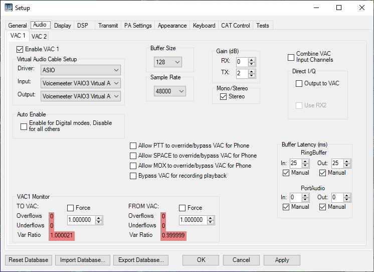

Here an example how it sounds (changed tx-profile). RX-audio 100% clean.
After unticking/ticking the buffer checkboxes, all fine again.

oe3ide wrote:Here an example how it sounds (changed tx-profile). RX-audio 100% clean.
oe3ide.mp3
Something I have noticed in the code, is that only the ring buffer IN latency is stored/recalled when swapping TX profiles. There are no changes made to the RB out, or PA in or out. You might be inadvertently applying some other RB IN setting when swapping profiles?
Not sure if that is intended, but that is how it is in the code.
Correct, I noticed one tx-profile with a different RB in-buffer. I cycled now through all tx-profiles, and made them equal.
I will take a look, if the "problem" is solved with equal settings (I guess that is)

Ernst--does the resampler run wild (unstable) when this occurs? I.e., is this a problem due to a change in VAC settings, or is this the resampler running wild when VAC is reset because of the TX profile change?
ramdor wrote:yeah, it would be easy enough to get those other settings stored/recovered with the profile, but not sure if it is done for a reason. Perhaps they have just been forgotten about and not included in the tx profile save/load.
That would be a great improvement, Richie!
VAC looks completly "normal"

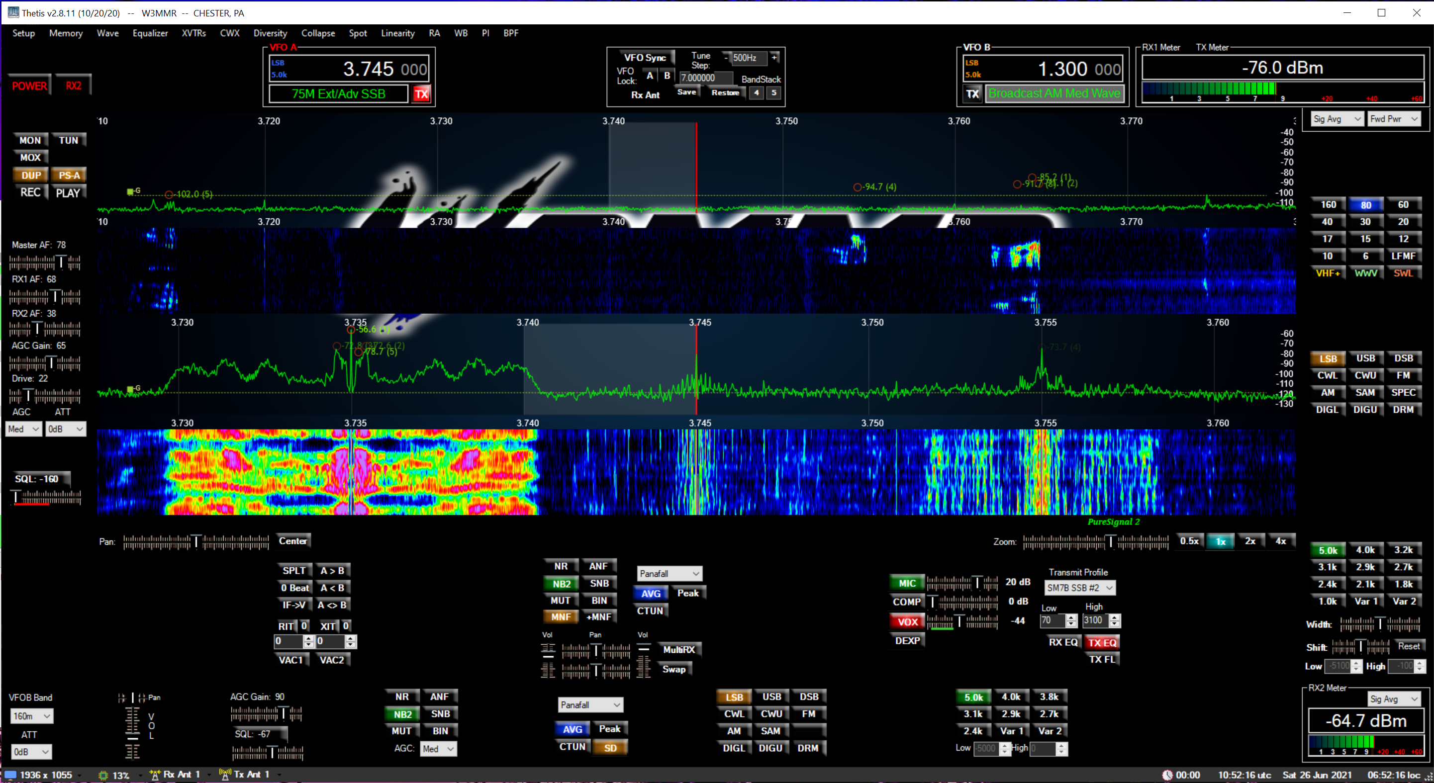

Sooooo, heres a weird one I just stumbled upon... I was using RX2(75m on RX1, 20m on RX2) this morning and accidentally hit the "SD" button on the GUI (Stereo Diversity) for RX2. What it did was weird. Now stick with me on this, its a little hard to explain. When i hit the SD button for RX2, the frequencies that you see on the panadapter change to the frequnencies that are on RX1, but the RX2 doesnt actually change frequencies. I still hear the AM BCB station. What is actually being displayed on the waterfall and data line in the panadapter doesnt change at all, like I didnt move frequencies at all, but the frequencies displayed on the panadapter would say otherwise. Ive attached a screenshot of RX2 on the AM BCB so you can see what I mean. The info you are seeing on the waterfall/panadapter for RX2 is the signals on the AM BCB. As you see, the 3745 on RX1, doesnt look anything like the 3.745 on RX2 lol. To be honest, I never even noticed the Stereo Diversity button
I am using a 200D, Protocol 2 v1.9, and Thetis 2.8.11
Perry

W3MMR wrote:Sooooo, heres a weird one I just stumbled upon... I was using RX2(75m on RX1, 20m on RX2) this morning and accidentally hit the "SD" button on the GUI (Stereo Diversity) for RX2. What it did was weird. Now stick with me on this, its a little hard to explain. When i hit the SD button for RX2, the frequencies that you see on the panadapter change to the frequnencies that are on RX1, but the RX2 doesnt actually change frequencies. I still hear the AM BCB station. What is actually being displayed on the waterfall and data line in the panadapter doesnt change at all, like I didnt move frequencies at all, but the frequencies displayed on the panadapter would say otherwise. Ive attached a screenshot of RX2 on the AM BCB so you can see what I mean. The info you are seeing on the waterfall/panadapter for RX2 is the signals on the AM BCB. As you see, the 3745 on RX1, doesnt look anything like the 3.745 on RX2 lol. To be honest, I never even noticed the Stereo Diversity button
Perry
Thanks Perry, reproduced here. Will look into it.
EDIT: actually not sure what the point the SD button is tbh. Exactly the same thing happens with VFO Sync if you have RX2 shown. It is not like you can access the SD button without RX2 shown anyway. I guess we could cache the VFOB freq when SD is pressed, and re-apply when turned off to return VFOB back to where it was.

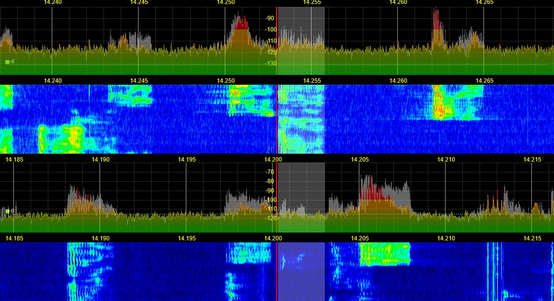

hmmm.. gradients could be a thing. I have set a hard stop for red at -100dBm in this example (which tracks the min/max grid size), but could be -73 or -93 depending and could also be a smooth transition. Could also have some config for a bunch of colour transition points..... man, have to love directX :lol:

Now gradients. That is kewl!
ramdor wrote:hmmm.. gradients could be a thing. I have set a hard stop for red at -100dBm in this example (which tracks the min/max grid size), but could be -73 or -93 depending and could also be a smooth transition. Could also have some config for a bunch of colour transition points..... man, have to love directX :lol:
Posts: 6135
The most amazing and useful spectral display I've ever seen is the "DPX" mode on Tektronix real-time spectrum analyzers. It color codes signals based on the temporal frequency of their occurence.

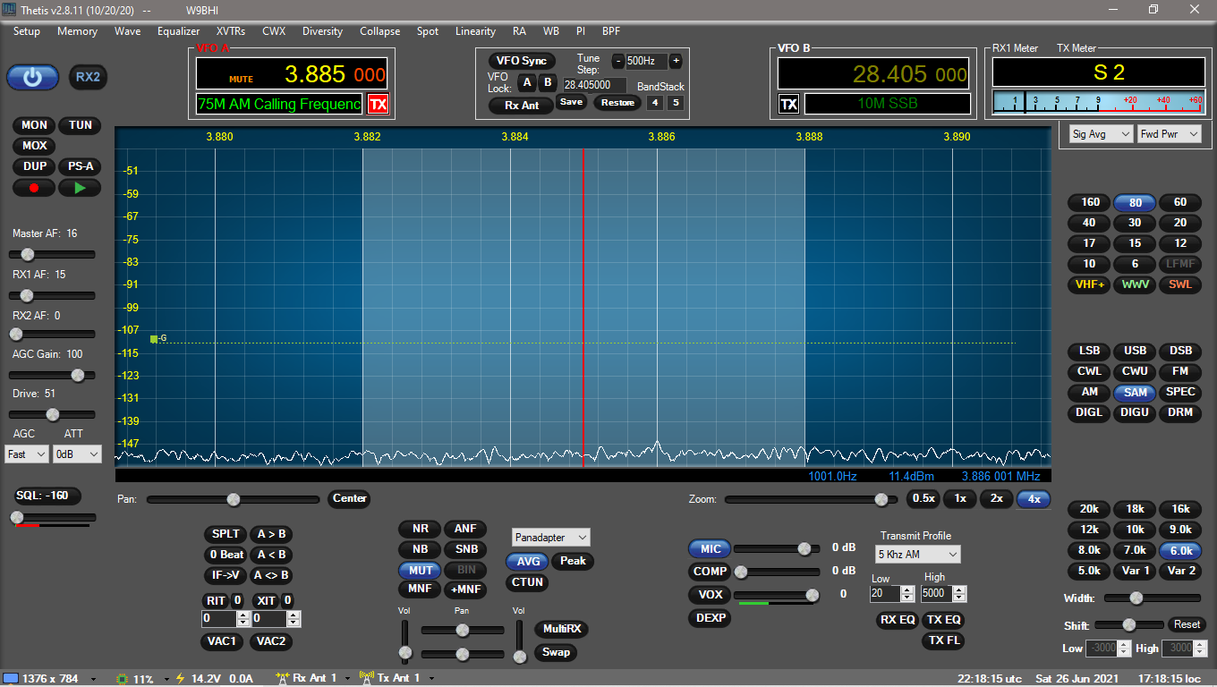

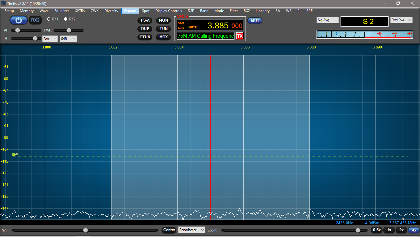

Here is something I noticed.
v2.8.11, P2.
When Thetis is first started my call comes up in the upper left part of the screen (custom title text) but when I go into collapsed mode, my call goes away.
Screenshot (133).png (237.97 KiB) Viewed 62424 times
Screenshot (134).png (159.89 KiB) Viewed 62424 times
If I change to expanded mode, it is still gone.
The only way to make it reappear is to restart Thetis again.
I also noticed that when in collapsed mode, the drive level from DDUtil is displayed where my call should be.
Screenshot (135).png (159.83 KiB) Viewed 62424 times
I know that this is coming from DDUtil because if I change the drive level there, the change shows up in the top of the collapsed display.
This may be a feature?
Another thing I noticed is If you move the PWR slider in the collapsed mode the drive level changes but there is no indicator on the screen to tell you what the drive is set to.
I am using a fresh data base.
Don

yeah Don, I guess removed for Andromeda to reduce clutter, not sure. Definitely a bug that it doesn't return when on expanded mind you, but not a game breaker. Thanks for finding it and reporting it though. Yep, the zero feedback on the sliders is annoying, put probably done for finger touch reasons I guess.

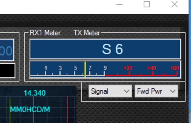

VFO-B Info: right alignment
S-Meter: border-type (maybe 3d vs 2d?)
