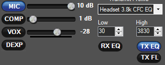

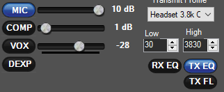

Just a visual extension. Some more characters can be displayed so the names of the transmit profiles are better readable.
Beside the dark background I also tend to have a darker frame for all dropdown boxes also. But I dont know how to color the frame in Visual Studio.
As alway I have no clue what I am doing.

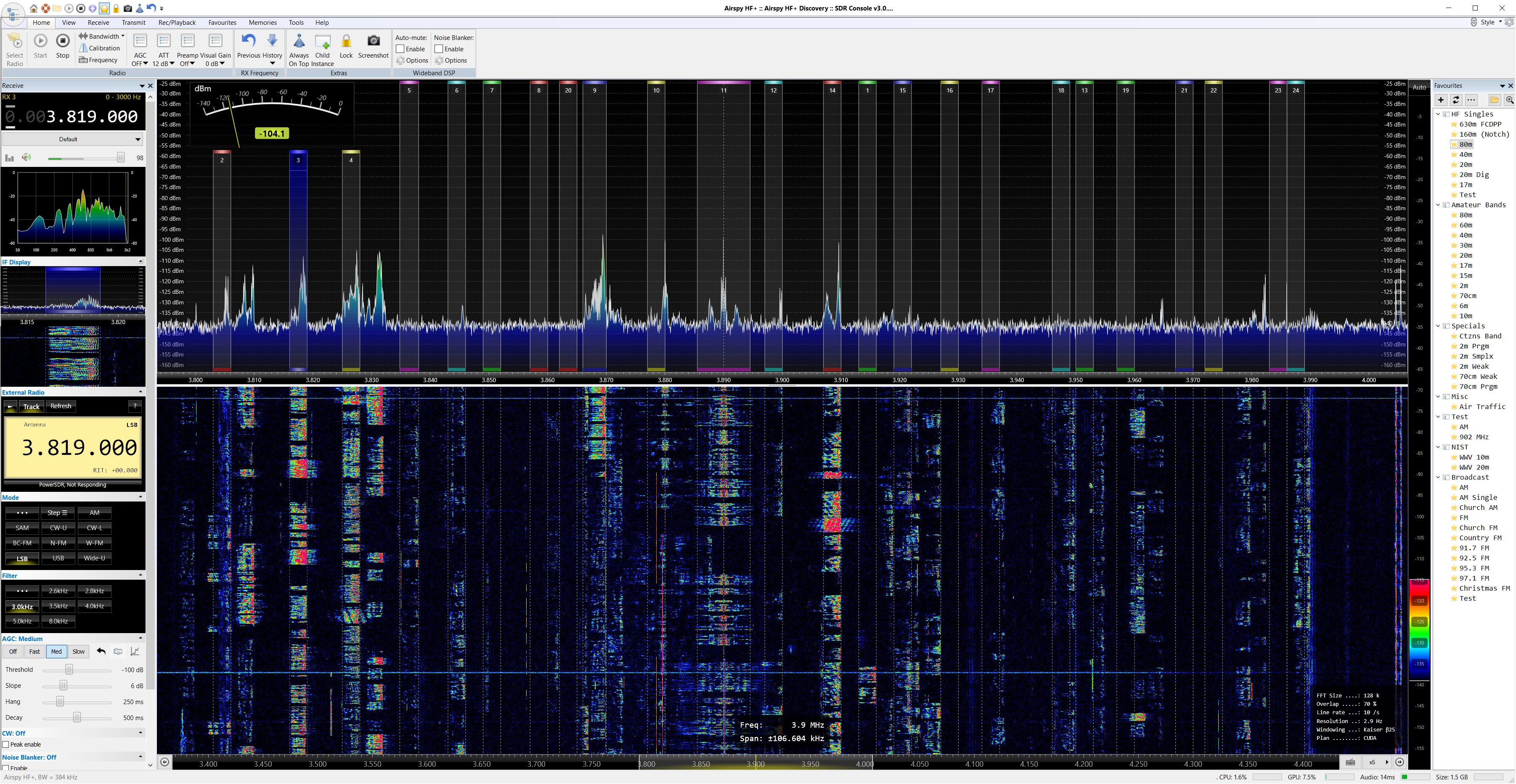

Not sure which direction you're ultimately taking the bandstack but I felt an urge to show you the way Simon Brown implements the equivalent concept in SDR Console.
In the screenshot below, every translucent gray vertical numbered stripe in the panadapter is a user-defined receiver complete with its own preset mode (LSB, SAM, CW, etc.), passband width, AGC gain, noise reduction settings, etc. Whenever the user clicks anywhere inside any of the the receiver stripes, the radio is automatically tuned to that frequency and set to those presets. While the user is in any of the receivers, changing any of the radio settings (frequency, passband width, noise filters, AGC gain, etc.) automatically updates that receiver with the new settings.
Any one of the defined receivers can be selected on-screen, and the currently selected receiver is highlighted (receiver #3 is selected in the pic). Any (or all) of the receivers can be hidden, unhidden or deleted at will.
IMO that implementation effectively eliminates the need for a bandstack window, because any of the defined receivers are definable and selectable on-screen.
I have no idea how much programming effort is involved in that implementation, I just wanted to show you how Simon does it. All of the receivers can also be managed in the Receive tab (which I unfortunately didn't capture in the snapshot).
Thanks for looking,

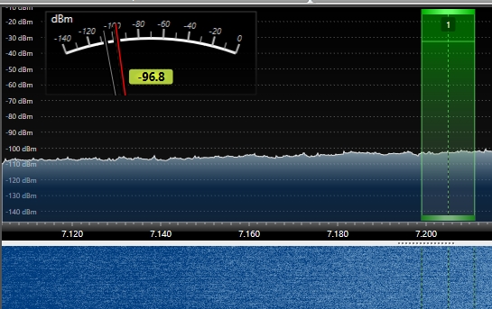

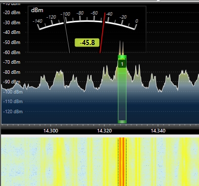

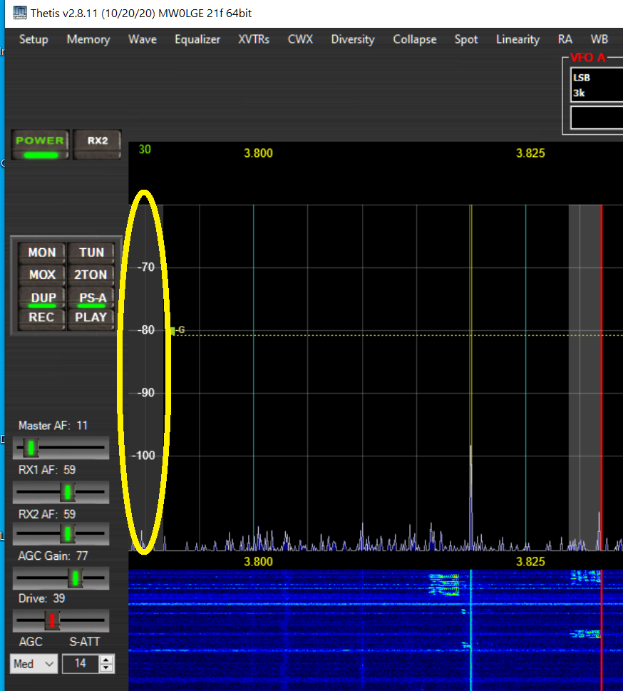

oe3ide wrote:Hi,
don't know if its possible:
Would be nice to show the signal strength on the y-axis in the panadapter-window (maybe switchable "default", "signal-dbm","signal-uV" or "signal-S-units) and if selected, show also these values in the peak-blobs.
The default is dBm. dBuV is doable but of what value is it? An S-unit scale on the PS adapter does not make sense because S-units must be measured with the bandwidth of the receiver passband.
uV is not really necessary...

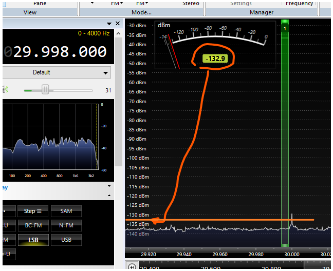

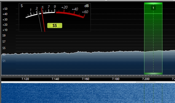

But if we would have dbm from the actual signal strength on the y-axis, then it would be easy to convert this to s-units.
If have read all your excellent explanations about noise-floor, s-units, etc....amazing stuff.
I am sure, the current scale on the y-axis is technically 100% correct, but for a non-engineer (like me) the current dbm-values are a bit confusing. Like viewing on a graph of a oscilloscope and not having the actual amplitude voltage on the y-axis (dealing with some offset).
Watching a signal on the panafall, which peaks @ -106dbm on the y-axis scale, which is actually a signal with -80dbm.
If this is technical not possible, not a big deal.
Like in SDRC:

ramdor wrote:the trouble is Ernst, we will end up with a loads of questions as to why the Smeter scale on the left is different to the actual Smeter for the bandwidth being observed. I can covert that dbm reading to smeter values no problem, and the peak blob stuff and everything else, but it wont be right.
Ok, I understand (I believe ;-) )
I wonder how Simon is doing it? Either his s-meter reading or the y-axis-scale is not correct.
In order not to confuse anyone, it should stay as it is.

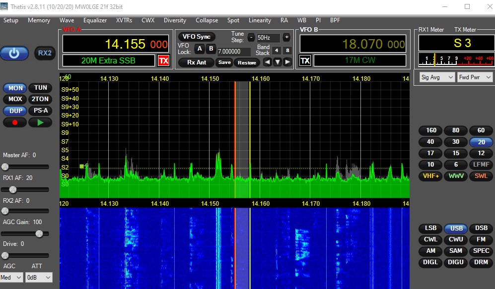

Posts: 1588
oe3ide wrote:
So does everything jump around when you move the VFO through that 30mHz point?
nope :-)
yeah implemented wrong then I expect. As there should be a 20dBm shift/jump, or a 20dBm slope as you move above 30MHz. It is telling you lies :D
I just slapped it together fast as a test..... you can see the problem :
nope :-)
yepp, not good :shock:
Another wish:
* add 2Tone on/off and PS on/off to the available midi-commands (or I missed it, looked 3 times over the list)
Posts: 1588
oe3ide wrote:yepp, not good :shock:
yeah it would be like an hour job to put all that in, but like Scott said, it is completely wrong.
SDRConsole may be applying some sort of fudge-factor to make it look like it is in the 'ballpark' when showing Smeter numbers or he has got something clever going on. However, if it doesnt move/jump when you pass 30MHz, then take it all with a pinch of salt tbh because it isn't telling you anything useful at all.

DH1KLM wrote:Just a visual extension. Some more characters can be displayed so the names of the transmit profiles are better readable
Thank you Sigi for mentioning this. I have many TX profiles, and the width of the drop-down listbox is too narrow to display enough characters to be able to tell them apart. I'm forced to abbreviate so aggressively that the meaning isn't clear. Yes, please increase the listbox width.
73, John W1JA

Not sure how much work it would be to implement but I'd very much like to see the spectrum grid step increment made smaller. I use the spectrum edge scale grab-and-drag feature very frequently to fine-tune the waterfall intensity as band conditions change (I have the waterfall linked to Spectrum Min/Max in Settings) but the current +/- 5dB spectrum grid step is wider than is ideal for fine-tuning the waterfall intensity.
