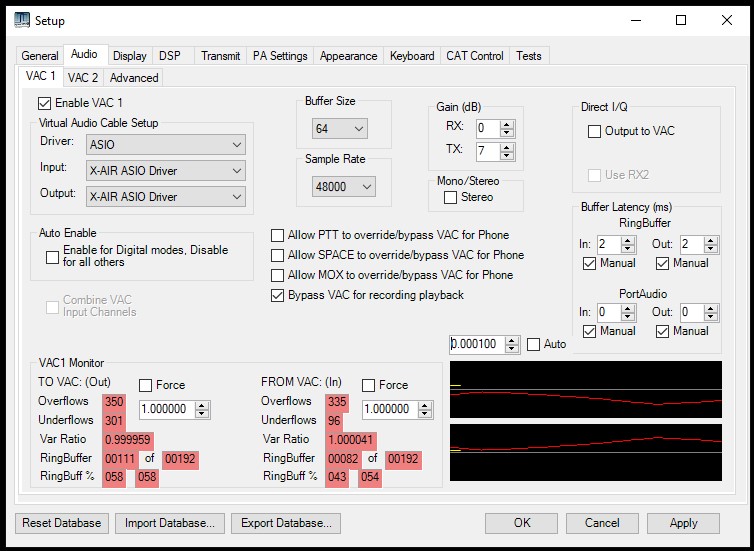

Another full night of tests, around 14hrs or so.

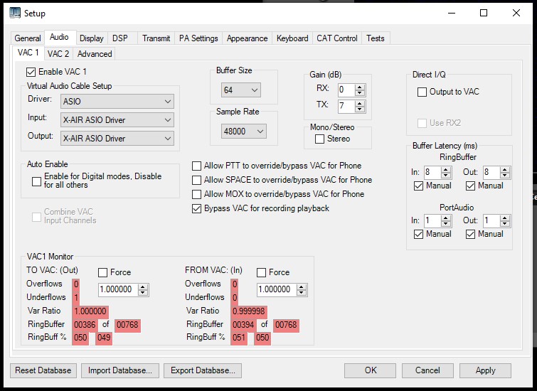

These are the results from around 11hrs testing. There are times when it will run stable for 10-20 mins with hardly any adjustment, and then something will happen and it will start to move around again. Overflows/underflows have started to show up. I unfortunately had PA set to 0/0 in this test where as it was previously 1/1.

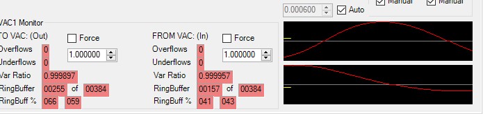

So I had pointed the finger at my OS configuration in my post above, but I think I've changed my mind again and have swung that finger back around to point at the resampler algorithm in Thetis :D
I've got all my power management turned off, and set the computer into a state where literally nothing changes (that I can control, anyhow), and yet the resampler still goes periodically unstable.
So, just randomly hacking away at it, I found some very curious behavior associated with resampler and/or VAC initialization. If I poke at one of the PortAudio "manual" checkboxes, I can almost always make it the resampler go unstable, and further cycling of that checkbox will not repair the problem.
On the other hand, if I cycle the RingBuffer manual checkbox, this has the opposite effect. It almost always makes an unstable condition fix itself.
So perhaps there is some clue there in terms of different paths through the code that occur for each of those actions.
Nevertheless, how can the algorithm NOT know that under and overflow counts are occurring and NOT act to fix the problem?
I made a short video to illustrate what I'm writing about...

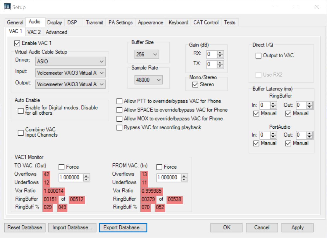

I've discovered one problem with respect to the resampler instability I'm experiencing: Voicemeeter Potato is doing a "Restart Audio Engine" every six hours. This appears to be associated with a bad program registration. I'm sure I can sort that out.
However, it begs the question: why does that make the resampler run wild? Shouldn't PortAudio automagically reset itself once Voicemeeter finishes its restart?

Mark,
The problem I'm experiencing isn't "very infrequent single-increment jumps". The problem I'm experiencing is continuously, and rapidly accumulating, under and overflow counters. It's not an intense focus on achieving perfect stability, although that would be very nice!

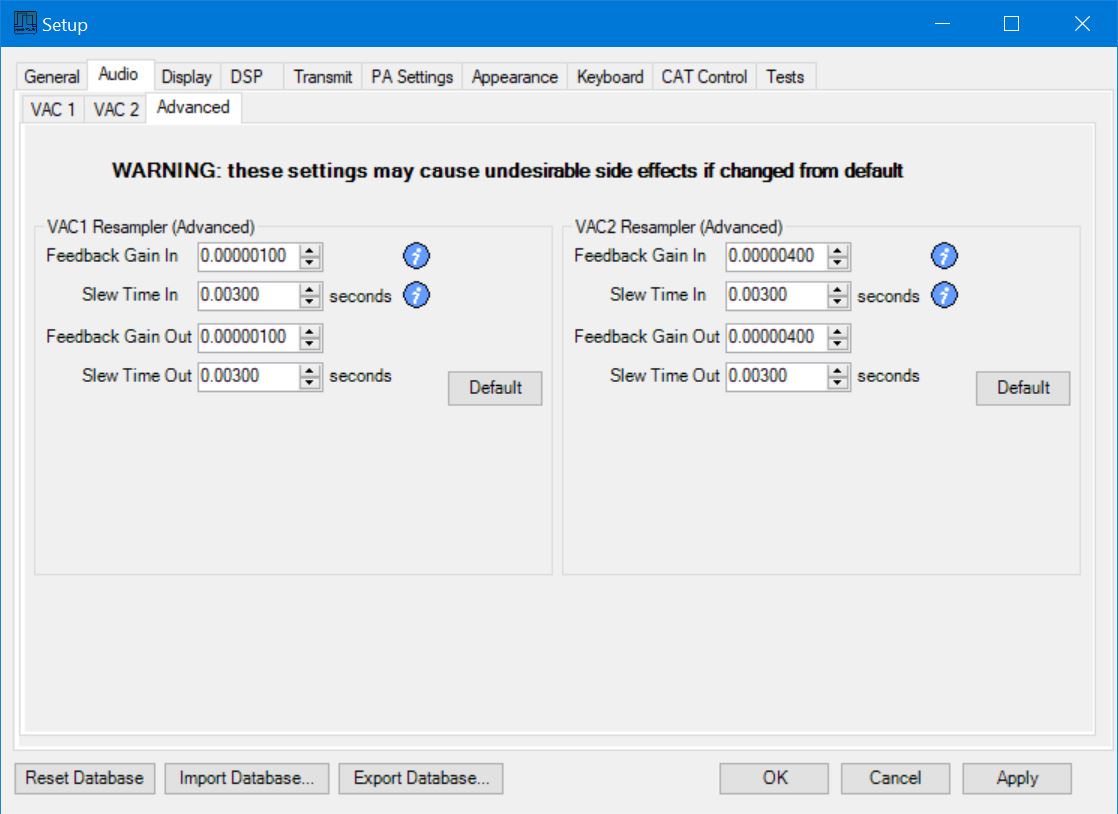

I suspect our posts may have crossed in the mail, so to speak. Somehow the registration of my Voicemeeter installation became corrupt without me realizing. Voicemeeter was doing its "reset every 6 hours" thing without me knowing, none of the usual advertising pop-up's that also normally come with that appeared. And apparently it's been like this a looooong time :? I reregistered it and now everything ran all night, over 12 hours, with just a few under/overflow counts being registered, all counters were under 50.
So now I've shifted gears to see if by messing with the Feedback Gain I can get some sort of a handle on the startup instability that I observe, and that was demonstrated in the video I posted above, when manipulating the manual checkboxes for both RingBuffer and PortAudio.
Observations so far this morning:
1. There is no setting of feedback gain that will withstand a Voicemeeter restart. It would appear that an external restart of drivers on the Thetis VAC portaudio interface is not handled.
2. Lowering the feedback gain x10^-6 from the default 4 to 1, or even .5, improves but does not completely alleviate the startup instability discussed above and in the aforementioned video.
3. More interestingly, lowering the feedback gain as above allows me to move from RingBuffers = 0 and PortAudios = 1 to RingBuffers = 0 and PortAudios = 0. At the default setting of 4, over/underflows will begin to accumulate at a slow but steady rate. Disclaimer: I've only been messing with this for a little while this morning. I'm currently running at 0.5x10^-6. I need to let it cook all day, or maybe for a few days, to really see if this is a stable condition.

Now that I've got that big distraction of Voicemeeter periodic restarts out of the way, looking at finer grain stability of the resampler has been a lot easier. Once you get it running it seems to be pretty good. At my current "extreme" settings, after two hours the worst case under/overflow counter has a 9 in it, which is, for all intents and purposes, an inaudible and undetectable error rate.
The issues seem to be, pending further research:
- A sensitivity to certain combinations of buffer sizes and sample rate.
- No ability to handle disruptions in the state of the attached audio devices.
- Occasional problems achieving stability at startup. Even with relatively conservative Ring and PortAudio buffer settings (for me) of 10ms across the board, I can cause the resampler to run away by cycling the PortAudio manual checkbox and fix it by cycling the RingBuffer manual checkbox.
That said, once running in a stable fashion, if nothing disturbs it it works fabulously well.
The original intent of having the resampler was to solve the problem of buffer under and overruns that were audible to those using VAC for phone and CW. Warren extended this to achieving a high level of frequency accuracy for digi modes as well. And when the resampler is behaving, as I wrote it works fabulously well. There are other threads on the forum discussing this for both FT8 and FME work and the like. I have personally measured it's performance. Those measurements were subject to ionospheric effects but were still measured in tenths of Hertz. With a good signal generator accuracy is probably below what we can measure. Bryan can tell us what theoretical performance is, probably measured in milliHertz.
As it turns out, the resampler can safely be disabled for digi modes as long as under and overrun rates are not excessive. There will be a small frequency offset, but that's just relative, and most digi modes will not notice the occasional glitch even if is audible to our ears. So for those who are having problems with it, or just don't care to be bothered with it, just don't use it. But for those who want buttery smooth audio, it's a must have.

Well, this was a run for about 10hrs, there has been some overflows/underflows during that time. I can get it to go bonkers seemingly randomly by unchecking/checking some of the latency options, the same as in your video Scott, so perhaps there is some initialisation problem that can happen, not sure. I have also tested routing it through VMp, setting up an asio patch in VMp, an then out to the xair asio driver with the same results, so VMp is not causing any instability it seems.

ramdor wrote:Well, this was a run for about 10hrs, there has been some overflows/underflows during that time. I can get it to go bonkers seemingly randomly by unchecking/checking some of the latency options, the same as in your video Scott, so perhaps there is some initialisation problem that can happen, not sure. I have also tested routing it through VMp, setting up an asio patch in VMp, an then out to the xair asio driver with the same results, so VMp is not causing any instability it seems.
Pretty much identical results here, Richie!
I've been playing games on and off all day with it. For "all zeros" in the buffers, anecdotally I think I'm finding lower values of feedback gain to be more stable, say 1x10^-6, or 0.5x10^-6. That causes a very gradual accumulation of counters, maybe 10 counts per hour, give or take.
For a more conservative set of buffer settings, e.g. ringbuffers at 10ms and portaudio at 1ms, and the same feedback gains, the counters pretty much sit at zero.
But I've not been running any one particular configuration for more than 1 or 2 hours at a whack, so these results are quite preliminary.

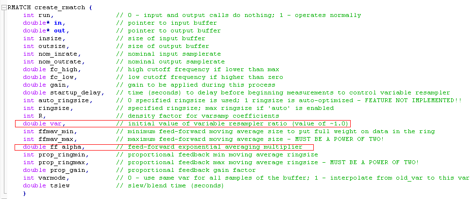

DL2XY
Re: Thetis 2.8.11-21+++ VAC advanced controls: results and discussion
Post by DL2XY »
@Richie
I'm still working on optimizing the control loop of the resampler. Made some progress on understanding the interrelations by testing and digging in the sources. It would be extreme helpfull if you could do 2 changes in the current version:
1.)
Please make the parameter ff_alpha accessible in the Advanced tab. I think this could be used to manipulate regulation loop timing. In combination with Feedback Gain we get control over phase margin and stability.
You may use the slewrate controls for this , slewrate is not that important.
2.)
Please transfer the values of the "Force" values (udVACx_Forcex) to the parameters var at (re)inititialization of create_rmatch(). We can put in the values of a succsessfull run and use it for start value, reducing the long primary (re)settling time.
With these changes chances are good to develop an algorithm to programmatically optimize the loop for all different setups.

Posts: 753
This might be a stupid question but I'm curious -- do any of the VAC tweaks or advanced controls have any influence on PureSignal?
Put another way, if someone is experiencing any issues with PS functioning robustly, is there anything he might try adjusting in the VAC or advanced controls that might improve or stabilize PS's behavior?
Or is PS simply not concerned with those controls in any regard?

Posts: 414
Post by K9RX »
Sorry - I didn't say that it was 'insurmountable' ... didn't even think it could be seen as suggesting that. I was only saying that I've found that I might have to reboot, typically once, once a week (and then only as forced by updates) to have a perfectly stable and clean system .... vs. what you seem to say previous to my post which is it goes bat-s#*t crazy randomly .... sorry - I prefer what I'm doing and was suggesting that to others who just want to use their radio and not be a test jockey.
I did play with the resampler - for a good bit doing all the 'tricks' suggested and recommended by you and others ... to no avail. It still, randomly, 'took off'. Then I noticed through normal reboots (again, due to Windows updates) that there were times when it would just work (resampler not active). So I tried, when I had a reboot and it didn't work, to just reboot again and lo-n-behold that worked. To me its less onerous to do this then to worry about my signal going awry all on its own. I have large high gain antenna systems and run power - it is critical to me to have a clean signal, on SSB (where I use PureSignal), on CW and on DIG modes. When the system is not working right I can hear clicks on RX and I'm sure they're there on all modes - but the issue is very prominently seen on DIG (FT8/Q65) transmit. That is not acceptable.
My comment was that whatever is causing the problem is not understood, and I'm sure you'd agree with that. And kudos to those researching it... but the fact that purely with a Windows reboot I can make it work - says it is indeed something IN Windows - and therein lies the need for focus. Also the fact that other apps don't have issues - just says either they've managed to FIND the cause and/or they're only part of the chain and not the part that causes issues. (and indeed it DOES say that it CAN be found and fixed!)
Again: my reason for posting was for those following that just want to have a radio that works and not be an experimentalist - or in most cases be changing parameters with no inkling of what it is doing and only a hope that it will improve things, that's the majority of people I'd bet. It is not to suggest it is "insurmountable" or to detract from those working on it ...

After 18 hours of soak time, results below. Note that I zeroed the counters after a 5 minute, initial settling period.
I'm pretty sure that I can up the buffers a hair and get the counts down to zeroes, but not sure it's worth it except as an academic exercise.
