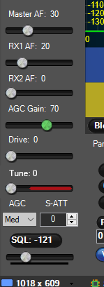

Feedback required please :
1) change the tune/2tone drive power setting in setup to allow for 3 options
  • Use Drive Power (slider) (per band)
  • Use Tune Power (slider) (per band)
  • Use fixed value (all bands)
2) add new slider under Drive called Tune
3) always use the new slider value for TUNE/2TONE
4) add limiter for both Drive + Tune, so above limit point the slider fills in red, and % drive/tune is not raised when slider is into this red area (much like ic-705 with tx power limiting enabled). Switching off the limit would raise % if the thumb position was sat in the red area. Perhaps a small lock icon to the right to limit, or a right click.
5) hide the tune slider if you are not using it (ie tune/2tone are all set to use either drv power or fixed)
something like :
It would simplify so so much related to having to check state, make sure the correct power is used when tuning/moxing etc. I would need to look at the implications to cat/midi, but it would make life so much easier for the tci side of things to split it up like this. Having a dedicated slider for Tune/2Tone makes sense to me.
Cheers,
Posted: Thu Apr 07, 2022 3:03 pm
by Mike_N1JEZ
Love it!
Remember settings by band?
Make this available in the "transverter" section as well!
Posted: Thu Apr 07, 2022 3:05 pm
by NC3Z
Hmmmm, like the concept. So you are saying we could set a max power limit per band??
I would like to see the CAT command stay for TUNE ZZTO
Posted: Thu Apr 07, 2022 3:25 pm
@ mike
yep, per band. As the xvtr directly controls the dvr slider it would all be handled by the band drv% limiting if enabled
@ gary
yes, but it is a limit to drive% not power per se, as that is limited overall by PA settings
zzto that one that would be quite easy to change/rework I think
Posted: Thu Apr 07, 2022 3:42 pm
by DL2XY
I dont need a 2nd slider for TUNE/2TONE.
I always tune my antennas with less then 1W (fixed TUNE power) and auto diabled xPA so i have no problems with high SWR during tuning.
After that i use 2TONE at normal drive level and auto enabled xPA to "calibrate" pure signal.
But limiting normal drive power to a predefineable value only if xPA is active would be very nice.
Walter
Posted: Thu Apr 07, 2022 3:50 pm
by W1AEX
I definitely like bringing the Tune power limit control out to the GUI with its own slider. At this point I've resorted to the "Use Drive Power" option for Tun and relied on my (faulty) memory to manually drop the Drive level when messing with the antenna tuner or setting up the amplifier. The very visible separate Tune slider would be nice. The settings per band is much appreciated!
Posted: Thu Apr 07, 2022 4:00 pm
by W4WMT
ramdor wrote: 1) scrap the tune drive power setting in setup
This would create an extra step for those of us who wish to have the tune/2tone level always be the same as the drive level. No?
Posted: Thu Apr 07, 2022 4:09 pm
by ULTIMAX
I like that, maybe able to control by right click on the mouse to avoid unsetting what ever value chosen, just my humble opinion.
Posted: Thu Apr 07, 2022 4:10 pm
It's still important to have a "Use Drive Level" options for both Tune and Two-Tone. In fact I never use Two Tone at anything except drive power. Please don't eliminate those options.
FWIW, my work flow is as follows:
1. QSY
2. TUNE at tune power with amp in standby
3. Switch amp to operate
4. Check drive power with TWO TONE at full drive.
Posted: Thu Apr 07, 2022 4:15 pm
@scott
do you move drv slider for 2tone? do you have drv slider always maxed for 2tone? do you use the setting in 2tone test to use drive power or do you have 100 pre-set in there?
Posted: Thu Apr 07, 2022 4:26 pm
also, there is no problem to have something like 3 radio buttons on each of Tune + 2Tone
o Use Drive Power (slider) (per band)
o Use Tune Power (slider) (per band)
o Use fixed value (all bands)
updated post sorry
