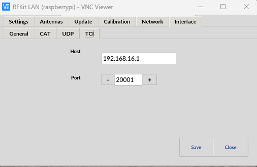

Re: TCI with RF Kits RF2K amplifier
For using TCI (or also TCPIP-CAT) "outside" the local machine (PC) it is important, that you bind the TCI-Server in Thetis not to the loopback-address (127.0.0.1) but to the actual IP-address of your PC (mostly 192.168..... or 10.0.0....).
127.0.0.1 is only reachable ON the current PC, not from other devices in the network. On Chris's screenshot you see "192.168.16.1". So the TCI-Server in Thetis is bound to that IP-address.
kc2rgw wrote:rf2k-tci.pngsetup-tci.png
My PC has a network card dedicated to only SDR traffic.
The PC is connected to a switch and the network adapter is set to 192.168.16.1 with a netmask of 255.255.255.0
I have a SunSDR2DX with an IP of 192.168.16.2 and a netmask of 255.255.255.0
I have the Anan set to an IP of 192.168.16.3 and a netmask of 255.255.255.0
I have the RFKit set to an IP of 192.168.16.4 and a netmask of 255.255.255.0
All devices are on a common switch that has no other connections.
Essentially I have a closed network on 192.168.16.0/24 that is purely for my SDRs and the amplifier, all are wired connections.
The RFKit has to have its networking configured properly in addition to the TCI settings, I'm wondering if that isn't the underlying issue for people with this.
