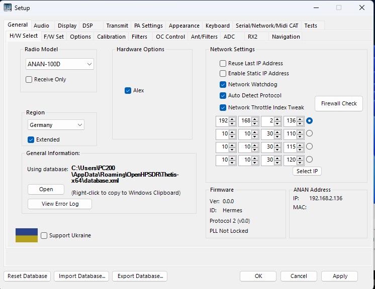

I had installed the version 2.9.0.11 on my computer and operate with it a Red Pitaya 16bit with protocol 2, is displayed under General H/W Select the firmware Ver. 2.7.0 ID: OrionMKII protocol 2 (v3.8).
As radio model I have set Anan-100D.
With the 2.9.0.11 Version I could set 386k sample rate and everything seems to run without problem. After that I installed version 2.9.0.12, now I can't set more than 192k sample rate because the higher ones are not offered anymore.
Also I tried as radio model Anan 7000 or 8000, also here I get in the selection for sample rate max. only 192k displayed.
Of course, it can also be due to the firmware on the Red Pitaya.
Maybe there is a hint where it could be.
73 Joerg, DD8JM

You must manually set to protocol 2, auto protocol detection doesn’t work. Remove check mark to cycle through the 3 choices.
Re: Understanding G7KLJ 2.9.0.11 release

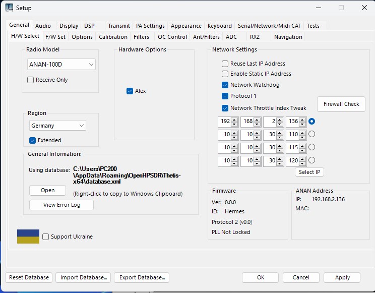

NJ2US, thanks for the quick reply, unfortunately I can't select Protocoll 2, it then immediately jumps to auto detect, Protocol 1 I can select, but there is no check mark either, just a dash.
Greetings Jörg

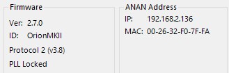

PS I managed it now, if protocol 2 is in the window without check mark, I can enter 386k, but when I start Thetis the next time, the sampling rate is again max, 192k.
Don't get confused, when I took the pictures I didn't press the power button, that's why it says Hermes at the bottom, otherwise it says Orion when I pressed the power button.
Greetings Jörg

Hello Jörg,
cycle through the protocol list until protocol 2 appears. For protocol 2, the checkbox must not have a tick.

Hello Sigi,DH1KLM wrote:Hello Jörg,
thanks for the information, I had found it too, unfortunately the protocol setting was not saved. Now I installed the v2.9.0.14 (currently there is only the x86 at Github also under x64 comes the x86) and now it keeps the protocol setting even after a restart. Maybe it was also due to the database.
73 Joerg, DD8JM
