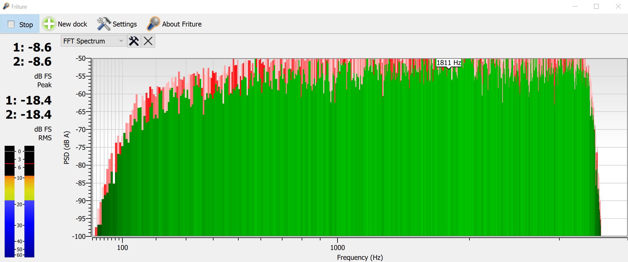

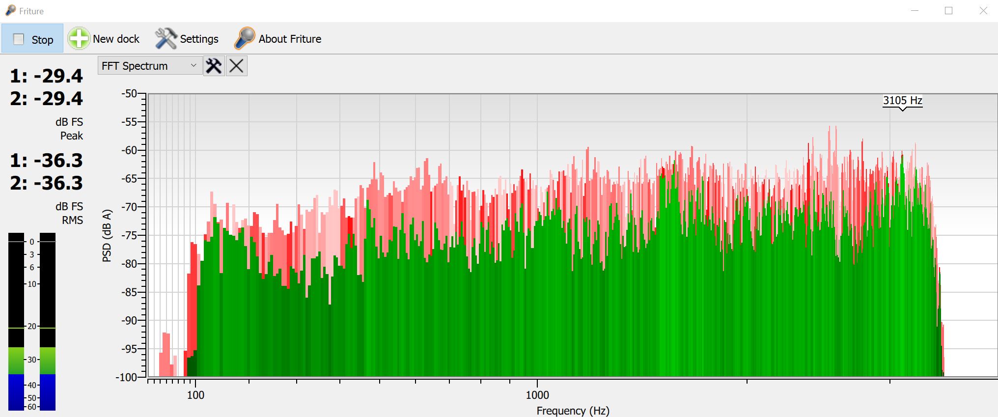

This morning I made some measurements here using some pretty challenging conditions:
- RX passband 50-3500Hz
- AGC gain line set right on top of the noise floor.
With NR2 activated I got the following noise spectra:
There's certainly a little content down around 140Hz, and this can certainly be characterized as a "rumble". I did find that I could distinguish that content by ear but it is by no means distinctive or objectionable (to me). And it's completely inaudible to my ears with an actual signal in the passband.
Even with that little artifact it seems far preferable to no noise reduction at all:
