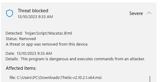

Re: Thetis 2.10.2 Final Now Available
Posted: Thu Oct 12, 2023 10:36 pm
by vk1hx
Unfortunately, I can't download 2.10.2.1.
Windows defender has detected Thetis 2.10.2.1 as a virus.
Screenshot 2023-10-13 093637.png (17.15 KiB) Viewed 42444 times
Posted: Thu Oct 12, 2023 10:50 pm
by vk1hx
Getting the virus detection on another PC running Windows 10. The main PC is running Windows 11 PRO also getting the virus detection.
Posted: Thu Oct 12, 2023 10:59 pm
by vk1hx
Trucker wrote:That's odd. I am running Windows 11Pro and keep it updated. I didn't get any warning from Windows Defender other then the initial thing about it being an exe file and did I really want to run it. I clicked ok and during installation I got the Blue Pop-up box telling me that Defender was blocking the installation till I clicked on run install anyway.
I do a virus scan afterwards and no hits. Windows 11 is much more protective than in the past.
While a bit annoying, it is better than letting anything get installed.
Yeah I get that same message for all other installs. Everything is up to date.
I downloaded the source code file and scanned it for a virus, nothing found. Very odd. I know people will say false positive etc etc, however I wont by-pass the detection. How do I compile the source code into my own exe/msi install file? Maybe I can do it that way and give 2.10.2.1 a try.
I don't get a virus detection on 2.10.2. very odd.
Posted: Thu Oct 12, 2023 11:01 pm
I have removed it from the release, completed a full virus check on my system, nothing. Ran virus total on the msi, nothing. Re-uploaded. Perhaps a glitch in the matrix. Either uploading or downloading caused some sort error that resulted in a false positive. Very odd.
virus total scan on the msi
https://www.virustotal.com/gui/file/cee ... fe32c50ec/
The trouble is, these days you get some odd byte order in a legit file and boom, it becomes flagged as a virus, a false positive. Price we have to pay I guess for non-signed installer.
Posted: Thu Oct 12, 2023 11:11 pm
by vk1hx
ramdor wrote:I have removed it from the release, completed a full virus check on my system, nothing. Ran virus total on the msi, nothing. Re-uploaded. Perhaps a glitch in the matrix. Either uploading or downloading caused some sort error that resulted in a false positive. Very odd.
Very good, yeah I can't explain it either. I'll try the download again. Cheers.
Posted: Thu Oct 12, 2023 11:13 pm
by vk1hx
Just redownloaded the update. Clear of Widows Defender virus detection.
All good, thanks for updating. Now to test.
