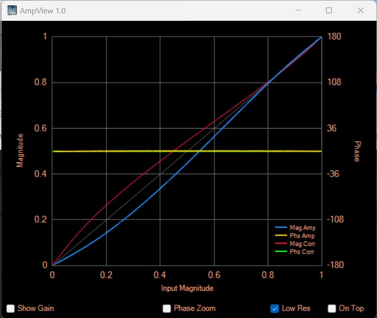

Update: Doug found a bad PA final in my radio, he replaced both finals and PS is working fine now on all bands.
Here's PS on 20 meters at 41 watts, internal sampler (curves are very similar at any power):
Thanks to everyone in this thread who offered their assistance.
