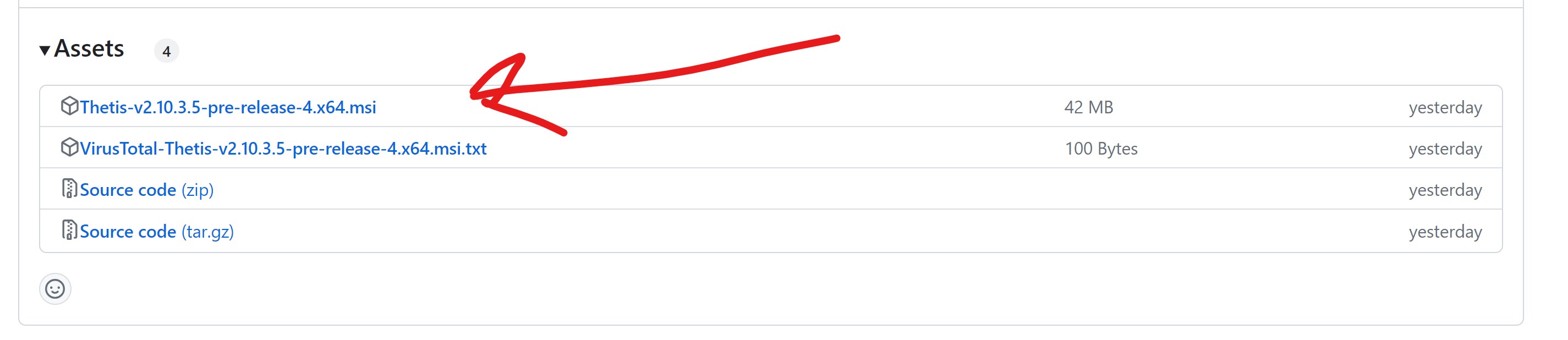

I must be missing something, but I can't find the link for the download for pre-release 4... other than https://github.com/ramdor/Thetis/releas ... -release-4
Mike, N1JEZ
NC3Z
Posts: 493
Location: Merritt, NC
Re: Thetis v2.10.3.5 Pre-Release
Post by NC3Z »
Mike_N1JEZ wrote:I must be missing something, but I can't find the link for the download for pre-release 4.
Have you scrolled to the bottom of the page?
Screenshot 2023-12-15 065658.jpg (126.26 KiB) Viewed 100090 times
Mike_N1JEZ
Posts: 42
Joined: Sun Apr 09, 2017 6:05 pm
Post by Mike_N1JEZ »
Boy do I feel foolish. I could have sworn I scrolled down to the bottom....
Tnx, Mike
Mike, N1JEZ
Took me a while too Mike :)
Mike_N1JEZ wrote:Boy do I feel foolish. I could have sworn I scrolled down to the bottom....
Tnx, Mike

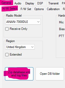

When using panafall and I try to expand the waterfall all the way up Thetis exits. Also happened once when scrolling the frequency bar on top of spectrum display.
Radio is 7000del mkIII
Firmware 2.1.12
Running W11 7800xt video card latest amd drivers.
Video below.
https://youtu.be/cuChn1B5Rno
Jay N2GQ

can you send me this zip. My email is over on qrz. Cheers.
Okay on it's way.

Sadly nothing of relevance in the errorlog.txt file. I ran up your db and spent about 5 mins slamming the splitter bar from top to bottom, dragging the splitter bar, and no issue.
If you can get it to repeatedly happen on demand, try closing down all other programs and clearing out everything from the the system tray icons.

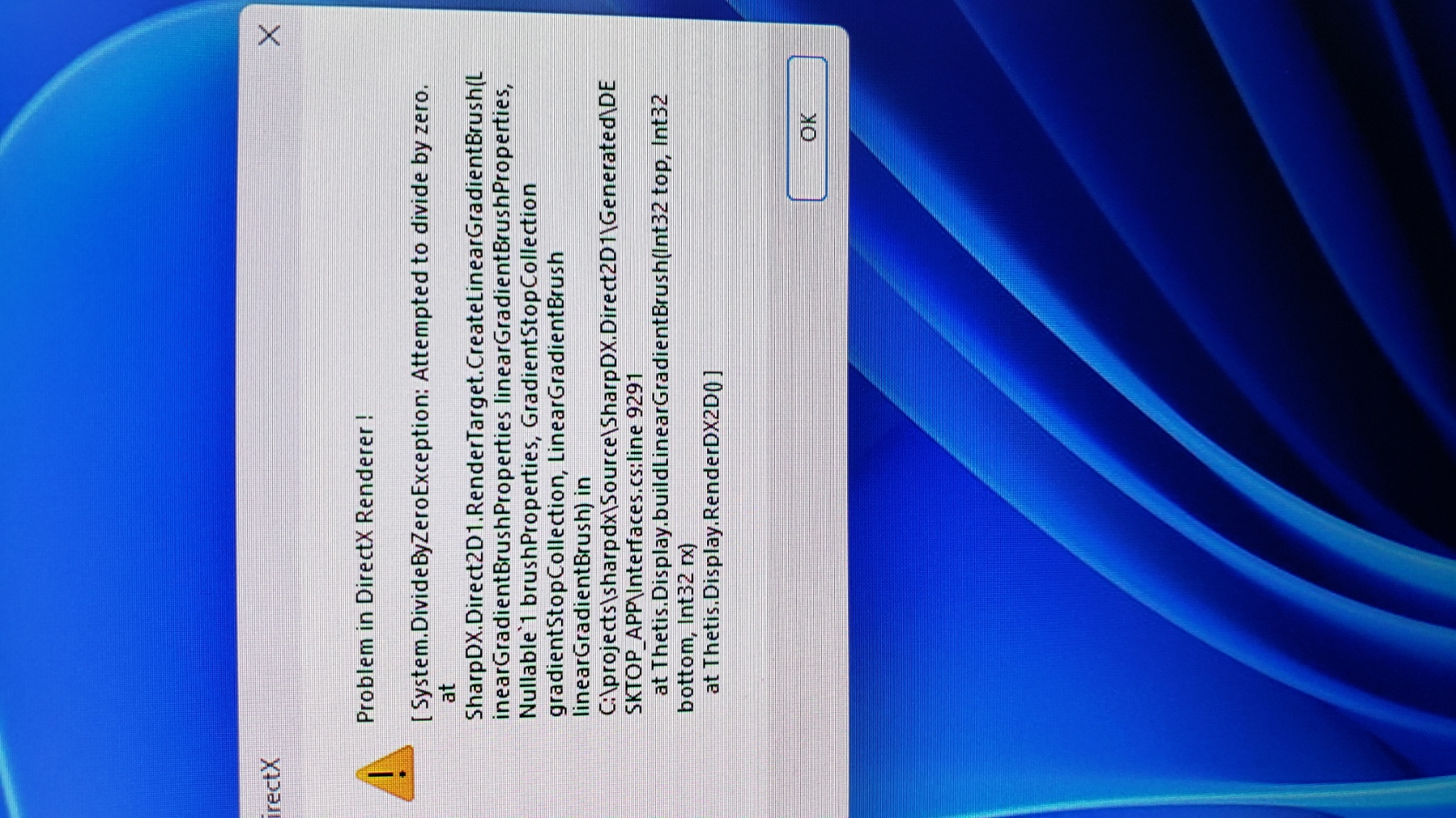

Okay I cleared as many as I could programs from system tray but same thing was happening. I then reduced display resolution down to 1080p from 2160 and I could not trigger the exit of thetis. I dragged multiple times and nothing happens. Will continue checking. Also exits at 1440 resolution.
At 2160 or 4k resolution and the recommended scale of 150% thetis exits if I drag up the waterfall. But if I move the scale to 175 and above it does not exit.
Also got this window one time. Picture attached.
Thetis crash20231216_111028.jpg (689.27 KiB) Viewed 99461 times
Jay N2GQ
