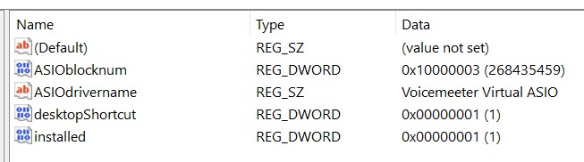

Posts: 736
The CM-ASIO Guide speaks of a LockMode which "is entered by setting any of the highorder bits in the ASIOblocknum value".
I'm not really clear on what are "highorder bits" in the ASIOblocknum value so here's a snapshot of my Registry entries:
Does that snapshot indicate that LockMode is enabled?
TIA,
W4WMT
Posts: 346
Post by W4WMT »
Yes it does. The lockMode will be enabled.
