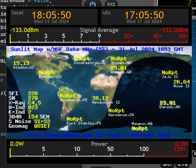

Here is a quick vid of something coming up, hopefully in a release at the end of the weekend, and perhaps a testing release in this thread before then.
https://youtu.be/eCwkEq2ec6M

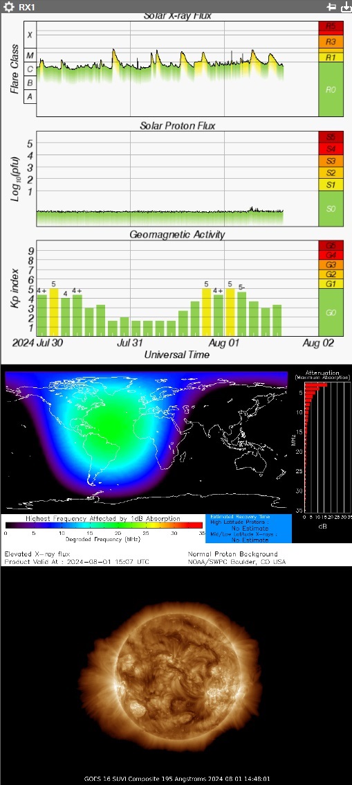

by W2PA
ramdor wrote:Here is a quick vid of something coming up, ...
Very cool, Richie. Here's my first attempt using data from the NOAA site - three in a single container:
Re: Thetis Development Build 2.10.3.6 dev_7 available
Posted: Thu Aug 01, 2024 3:26 pm
Great job, Chris! There are a few formats it currently can't handle, such as SVG. It might not be worth the effort to add support for that at the moment. I also received a positive email from Paul about including links to his solar data in Thetis, and he’s agreed to let us include them.
When I release a test build, possibly later tonight, I'll send out a request to find out where people are sourcing their data. This will help us see if we can include more examples.
