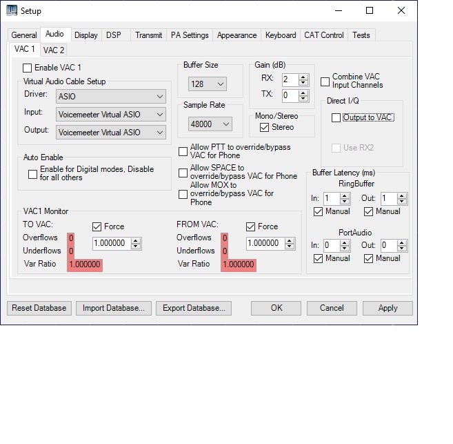

I have an occasional problem and I wonder if anyone else is experiencing it. I'm running 2.6.8 C5 along with v2.0 pre1 firmware on an 8000 board.
I use VAC with Potato and sometimes when I start Thetis, my overflows/underflows just plain run away. I find I can usually fix this by simply unchecking and then rechecking the Buffer Latency Ringbuffer "Manual" check box. This happens regardless of having any other apps running or not. It doesn't happen every time I start Thetis but it does happen frequently. Once I "fix" it, it usually stays fixed, but not always. When running correctly, I usually only see the last two digits changing in the "Var Ratio" under both To Vac and From Vac so things seem pretty stable based on this.
It's not a big problem but it makes me wonder if it is somewhat common or if maybe I have some setting(s) that are incorrect.

Re: 2.6.8
Joe,Joe-W4WT wrote:I have an occasional problem and I wonder if anyone else is experiencing it. I'm running 2.6.8 C5 along with v2.0 pre1 firmware on an 8000 board.
Joe W4WT
This is a bug in the resampler algorithm and has nothing to do with Thetis or P2 per se. I experience it here as well with both PowerSDR and Thetis. I suspect you are shaving down your buffer sizes to a minimum because I have found that doing so makes the resampler algorithm more susceptible to this behavior.

"This is a bug in the resampler algorithm..."
Thanks Scott. I'll play with larger buffer settings to see how that might affect it. I run 128 currently. I guess that algorithm is in WDSP.

Re: 2.6.8
Joe,
I live with the bug because I love having very like latency. If I have to occasionally beat the resampler into submission it's the cost of doing business right now.
Re: 2.6.8
Same here. The runaway occurs about 50% of the time when activating VAC. I now habitually start VAC with the AUDIO menu open, then reset the under/overflows by checking and unchecking "Output to VAC" twice, then start VAC. Image of the audio set-up Set-up screen attached.Joe-W4WT wrote:"This is a bug in the resampler algorithm..."
