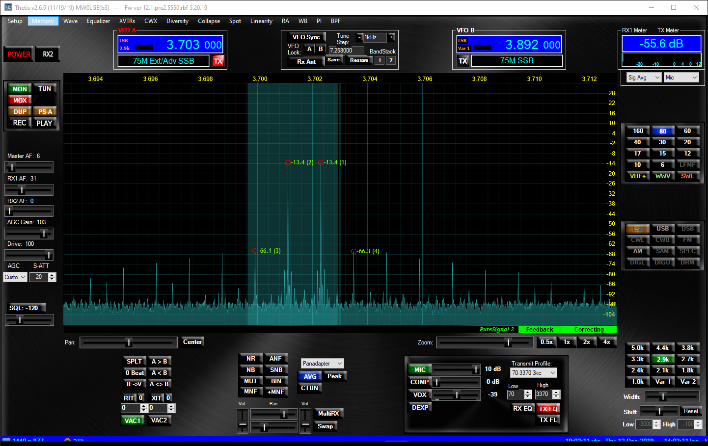

Here is my problem with the Auto-Attenuate (PS-A) since version Thetis_2.6.9_B1, 2.6.9_B2, 2.6.9_B3. Note that with the previous versions everything worked correctly. Test with old database or new and same problem
Drive 15 or low value ok (Fig. 1), but when I increase the drive (Fig .2) the Auto-Attenuate does not work. I have to put the S-ATT manually (fig.3). The Autto-Attenuate only works very rarely, so it can not be used.
Anan 100D
Firmware Angelia_Protocol_2_v11.7_7-15-18
Anan 100D

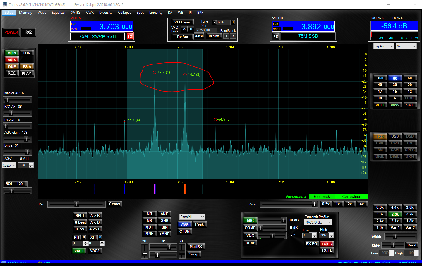

I seem to have a level issue with the 2tone test.
Anybody else ?
garyradio//wa1oxt
Anybody else ?
garyradio//wa1oxt
- 2Tone.PNG (466.49 KiB) Viewed 33886 times
Re: 2.6.9
Please ignore my last post.
Problem solved with a reboot of software.
tnx oxt
tnx oxt
- 2Tone problem solved.PNG (462.96 KiB) Viewed 33879 times

Have you tried going back to a Thetis version before 2.6.9_b1 recently? In other words, now that it does not work for you, if you go back now does it work for you again? It may not be a Thetis problem. This behavior is more indicative of a firmware problem or a problem with excess current through the F3 PTC device.VA2EY wrote:Here is my problem with the Auto-Attenuate (PS-A) since version Thetis_2.6.9_B1, 2.6.9_B2, 2.6.9_B3. Note that with the previous versions everything worked correctly. Test with old database or new and same problem
Anan 100D

[/quote]Have you tried going back to a Thetis version before 2.6.9_b1 recently? In other words, now that it does not work for you, if you go back now does it work for you again? It may not be a Thetis problem. This behavior is more indicative of a firmware problem or a problem with excess current through the F3 PTC device.[/quote]
I just checked (many more times) Thetis_2.6.8 any alpha version
Thetis_0700_171119_269_a7
Thetis_2240_181119_269_a8
all these version works properly
problem only with
Thetis_2320_211119_269_b1
Thetis_1622_091219_269_b2
Thetis_1905_111219_269_b3
problem only with
Re: 2.6.9
Issue found. New version out sometime over weekend.VA2EY wrote: I just checked (many more times) Thetis_2.6.8 any alpha version

Thanks for the version info, helped me track it.
