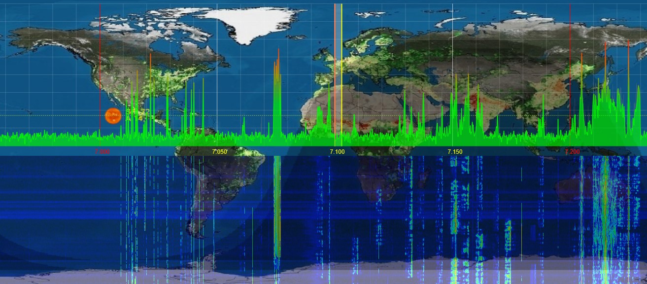

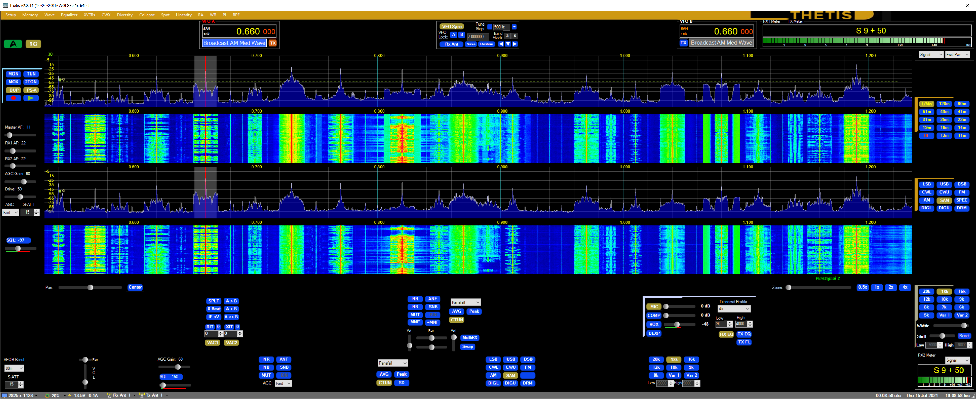

Waterfall opacity could be a thing if people think it would be worth while. Half opacity in the image.
That would be a nice addition

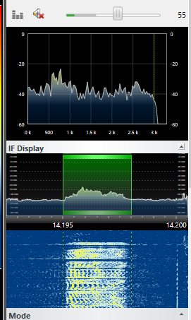

What I am missing (coming from SDR Console rx-side) is this
No need to zoom in, to have a closer look to the signal..

Negative Nancy votes "No."ramdor wrote:Waterfall opacity could be a thing if people think it would be worth while. Half opacity in the image.
Actually, I don't even understand why people like images in the panadapter portion. I desire the clearest representation of the spectrum possible. I guess I'm just too much of an engineer!
yeah, same, but after looking at Ernst's nice skins and backgrounds there may be a needw-u-2-o wrote:Negative Nancy votes "No."ramdor wrote:Waterfall opacity could be a thing if people think it would be worth while. Half opacity in the image.
Richie.![]()
If I remember right, I had this in some other SDR software... not sure which one.. but after a while I disabled it, because it disturbs the visibility of the signals on the waterfall.
But it depends how users look at the signals... some looking to the spectrum, some looking mainly on the waterfall (like me)...so the background in the spectrum window (picDisplay.png) does not bother me.
So I agree with Scott, it is not really necessary.

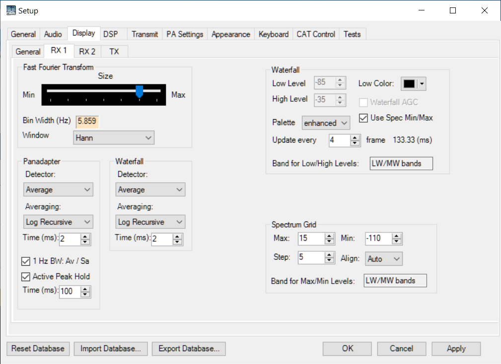

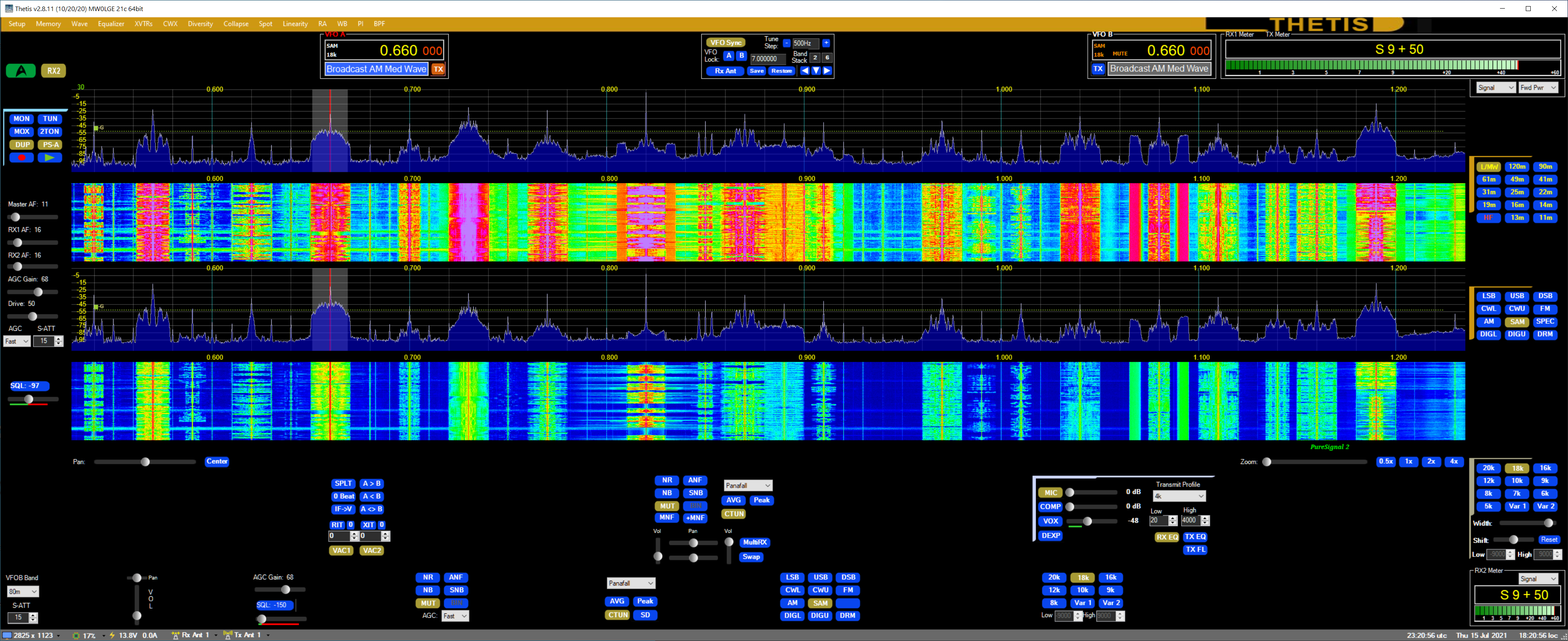

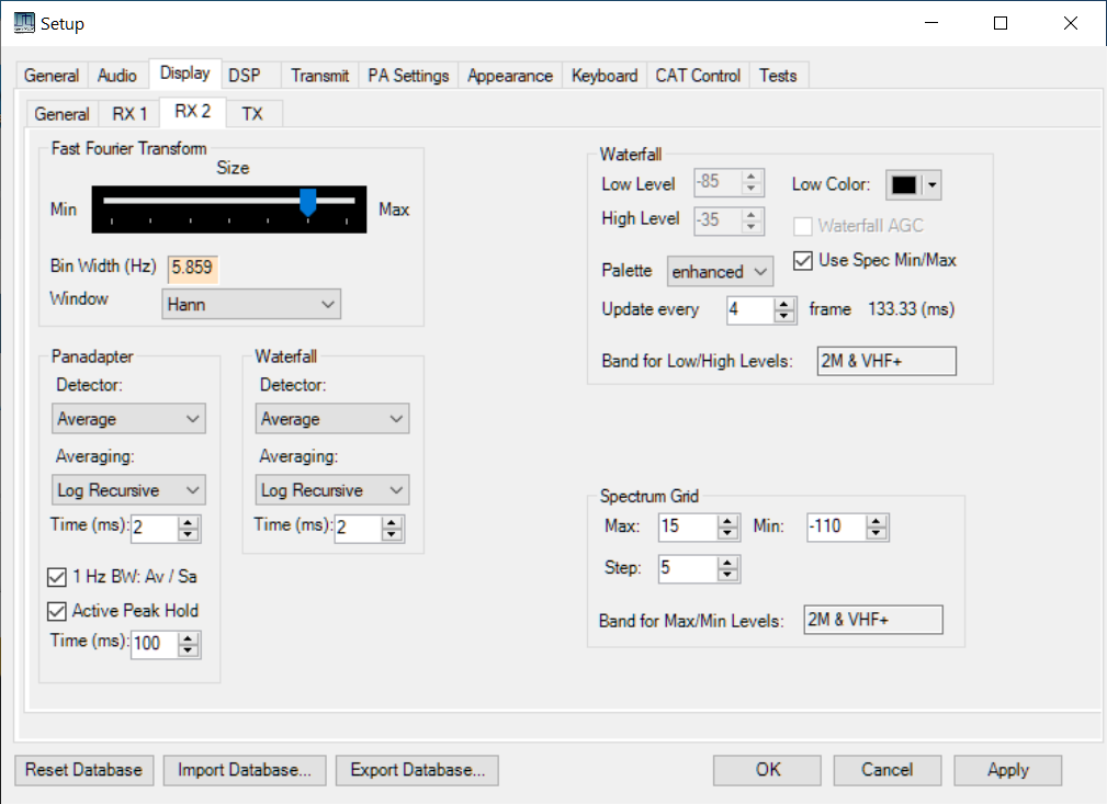

Not sure whether this is a bug or I'm just not understanding how things work, but for some reason my RX2 waterfall doesn't look at all similar to the RX1 waterfall (power density-wise) even though I've got both displays setup identically and I'm feeding very close to the same signal strength to both receivers.
Can you possibly explain that to me?
Many thanks,

Perhaps different settings for each waterfall? I am somewhat interested in how you enabled S-ATT on RX2 though. The checkbox for that is actually hidden afaik.
Here are my RX1 and RX2 Display settings, they are identical:
RX1:
RX2:
As far as enabling S-ATT on RX2, it's clickable between ATT and S-ATT for me.
RX1:
RX2:
Nevermind, apparently it fixed itself when I exited the Thetis session and restarted it:
Very sorry for the bother, sir.
Ok Mark, there may be a small bug in that code somewhere, as I do notice that 2m & VHF is selected for RX2 in your images which would explain the difference in the waterfall range data perhaps.
Regarding the S-ATT, I really need to investigate that S-ATT for RX2. I assumed that it was always as a drop down list there and not s-att. Does it switch on/off to the dropdown when you select s-att in setup? What radio are you using?
The only way I can see that it will show from the old code is if the database has an old historic entry that had previously set chkRX2StepAtt to true.
Anyone else have an S-ATT entry for RX2?

Richie, where do I find S-ATT option in Setup?

I double clicked on the ATT in the bottom left corner of the UI and it changed to S-ATT, just as it does on the setting for RX1.
Yes, double-click on the ATT-label (lblRX2Preamp) switches ATT to S-ATT.Anyone else have an S-ATT entry for RX2?

Well, that will cause some work for this morning. Why was the chkRX2StepAtt in setup hidden away, yet is used by double clicking a label ? Aaagghhhhh....
1) step attenuation is applied with function calls SetADC1StepAttenData/SetADC2StepAttenData
2) Thetis previously has always used SetADC1StepAttenData for RX1
2) Thetis previously has always used SetADC2StepAttenData for RX2
Note, the ADC<number> in the function calls starts at 1, where as we are used to ADC0 on the setup front end.
For radios 100d, 200d, 7000/8000's, the issue arises If you have DDC2 (rx1) set to ADC1 in setup. RX1 should be calling SetADC2StepAttenData but is actually calling SetADC1StepAttenData. The same issue exists if you have ADC0 selected in setup for DDC3 (rx2). It should be calling SetADC1StepAttenData, but is actually always calling SetADC2StepAttenData. The front end spectrums/signals/etc look like they are working because the atten offset is applied.

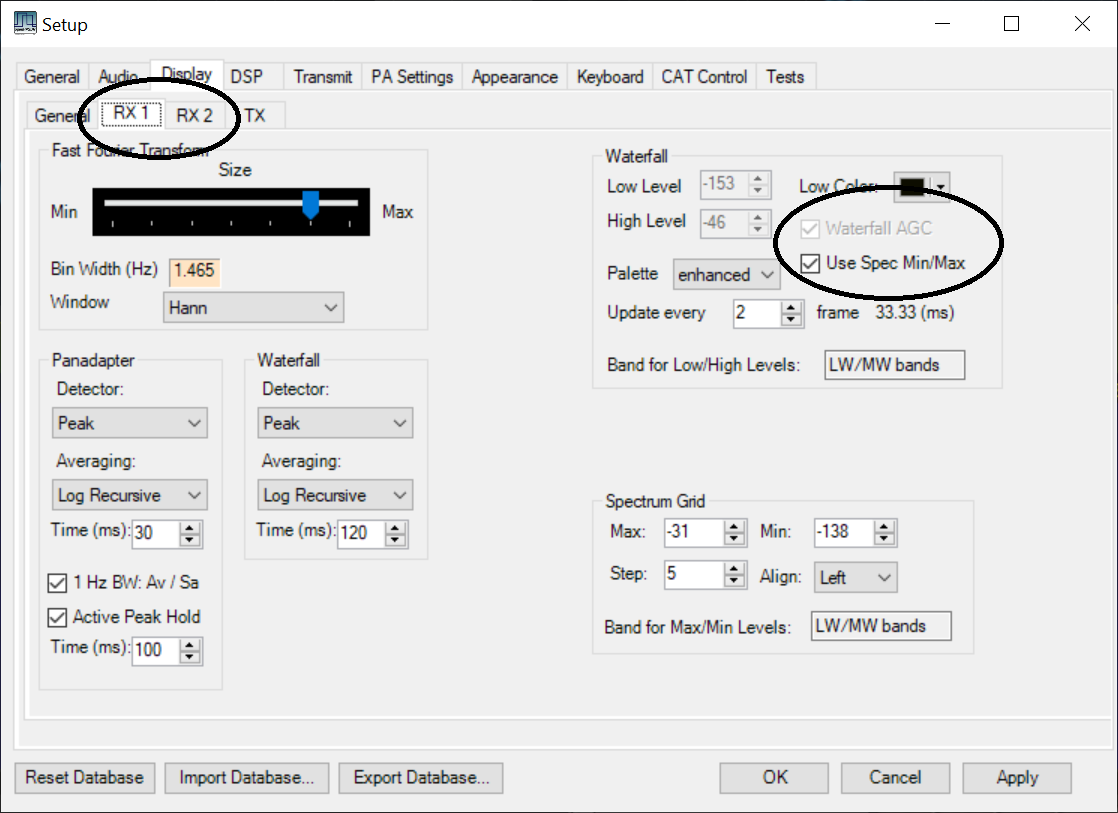

While we are on the subject of Waterfall. How difficult would it be to add somthing on the console where one could adjust the waterfall intensity?
I have been adjusting it on the Setup>Display>RX1 tab. The default High level is -80. During the morning it is necessary to change this to -60 or even -50 to prevent what I see in the screen capture. I realize it is not practical to add everything to the Console screen, but this is something I have to modify a good bit. Also, if this is not a problem for anyone else it is a moot point. This is a pretty strong signal.
Hi, it's already there......
With this setting the WF gain follows the scale dragging in the FFT

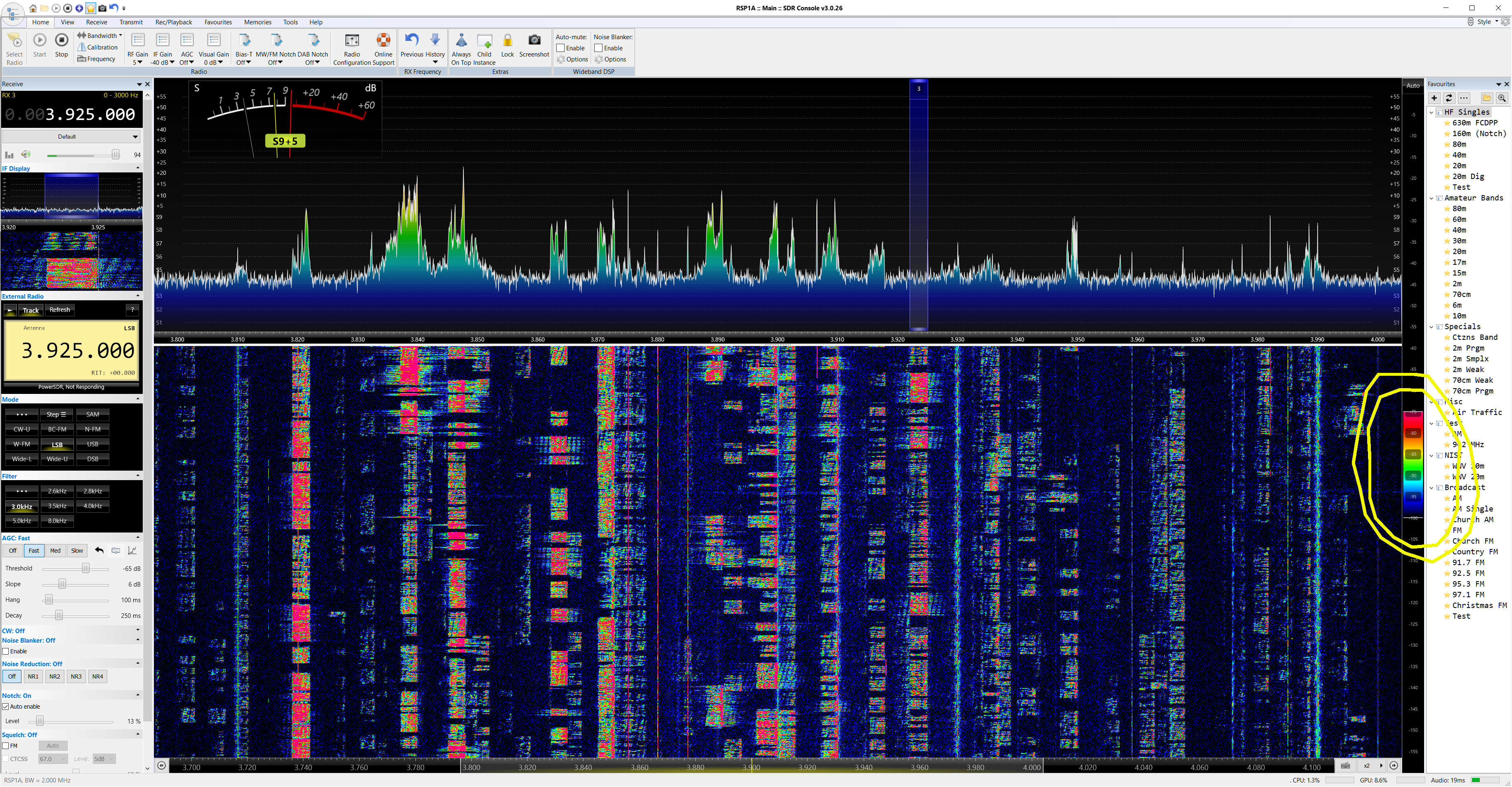

Here's how Simon Brown does it in SDR Console (it's the slider highlighted on the right edge of the panafall). I really like his method, you can grab either end of the slider and adjust only that end, or you can grab anywhere inside the slider and drag the whole slider:
Just wanted to illustrate that possible option,
