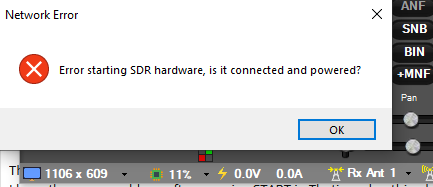

I have the same problem after pressing START in Thetis and nothing happens with the RADIO and finally I get the question ".....is it connected and powered". I quit this message 2-4 times and then the radio starts.
2022-04-21 18_06_49-apache-labs.com - Edit post.png (11.5 KiB) Viewed 27599 times
But this behavior is not reliable replicable.
I didn't find the reason for this.
Has any one an idea for this behavior?

re the connection issue. If this is intermittent then it could be any number of issues, from network, to hardware, to pc, to firewall, to other software running... etc...etc
