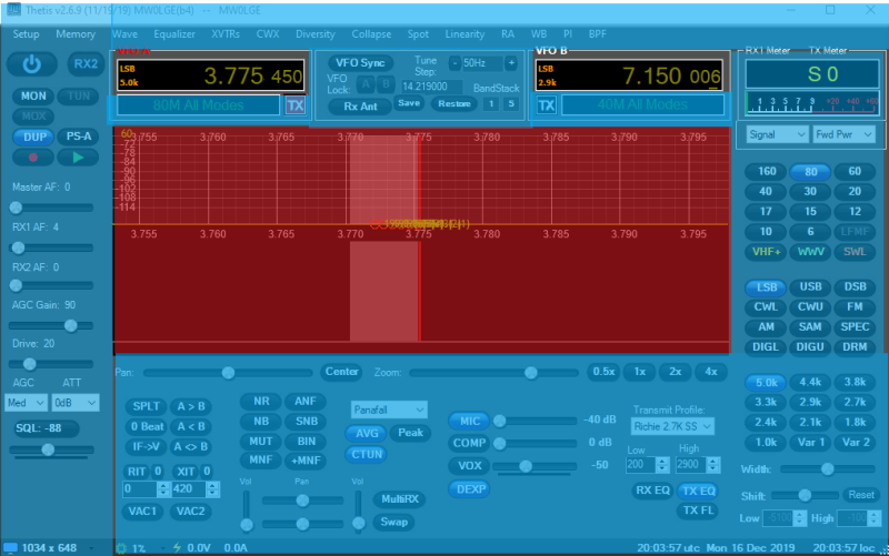

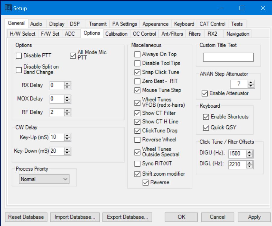

It looks like the "Wheel Tunes Outside Spectral" option may be broken.
These are my current settings:
With those settings, and CTUN turned on, and zoomed in pretty far on the spectral display, when tuning with the mouse wheel (or MIDI, etc.) the display scrolls when the passband gets to the edge instead of the passband disappearing off of the edge of the spectral display.

Mouse wheel scroll outside spectral window means exactly that. If enabled mouse wheel tune will work in the blue+red area. If disabled mouse wheel tune will only work when over red spectral area. It does not change the behaviour of how the passband/filter scrolls. It was primarily put in to prevent frequency change if someone just missed a slider and was using mousewheel.

Is the "Wheel Tunes Outside Spectral" problem fixed in b4?
Cheers!
Posts: 1588
Re: 2.6.9
w-u-2-o wrote:Is the "Wheel Tunes Outside Spectral" problem fixed in b4?
Cheers!
not sure there was anything to fix Scott. See : https://apache-labs.com/community/viewt ... 2b38#p9435
It doesn't do what you think it does.
