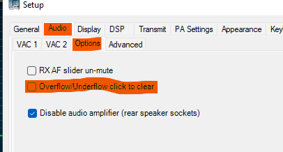

Option to auto-reset the VAC Under/Overflow counters in the VAC Settings when clicking/resetting the VAC Under/Overflow indicator on the console.
You can set them so they fade away. In that mode they will only momentarily show when the overflow/unerflow count increments. The other mode they hide when you click them, only to show again when the over/under increments. Not sure I see any gain from clearing the under/over number tbh.K1LSB wrote:Wants/Wishes
Leaving this unchecked will cause them to fade away...
The gain is that I wouldn't need to manually go in and clear the indicators and counters individually. IMO it would be more streamlined/elegant to at least have the option to reset the counters and indicators with a single click.ramdor wrote:.K1LSB wrote:Wants/Wishes

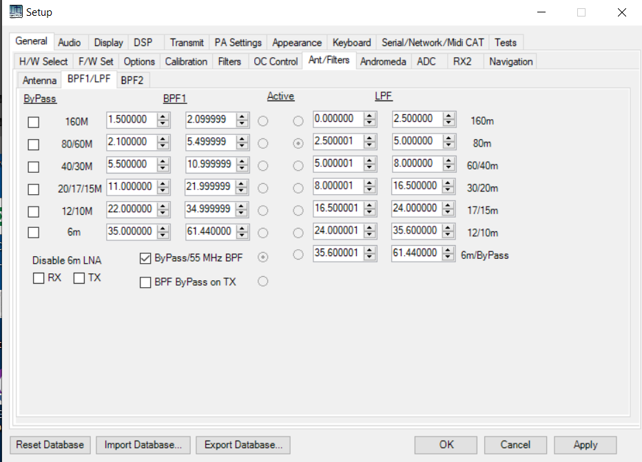

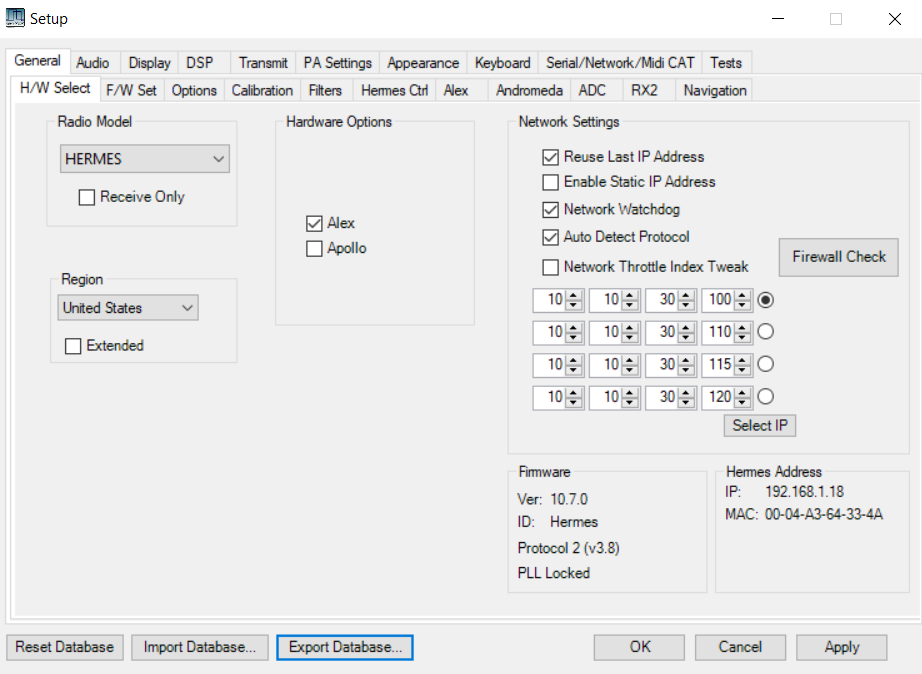

Thank you for your update of v2.9.0.6.
I tested it with Alex using my Hermes(TAPR) board.
Unfortunately Alex is not working with v2.9.0.6. On the contrary, Alex is fine with v2.8.11.
Please look at the pictures. When RX, Alex filter functions as for LPF, not BPF. You see the difference.
If there is some trick of setting up, please let us know. My settings of v2.9.0.6 are shown also in the attached pictures including the firmware
Tokio
JA1CCA

What happens if you uncheck Bypass?
Thank you for advice. I neglected unchecking Bypass. Now it works.
Thank you again!

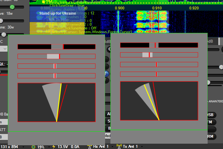

Work in progress on the new meter system
Still loads and loads to do, at least 2-3-4-5-6 weeks away (as long as it takes). The directX surfaces are just floating there at the moment whilst developing. They will eventually move to another window, and may also sit in the main UI.
Short vid : https://youtu.be/wpazWNoUsNM
73 Richie.
- DirectX surfaces
- Fully scalable
- Multiple meters each with multiple meter items, with Rx, Mox, Tun, 2Tone specific layouts
- Meter items source every bit of data available, from the regular meters that we are used to, to pbsnr, pa data, cpu, etc etc
- Meter items can be overlaid. The needle meters are showing avg_signal (yellow) and signal (red) on top of each other
- Meter items can have own refresh/update rates
- Adjustable attack/decay rates
- Image/png support for backgrounds, and other elements
- Fully user configured (either xml, or interactive editor, tbd)
- Z-order system
- much to do !

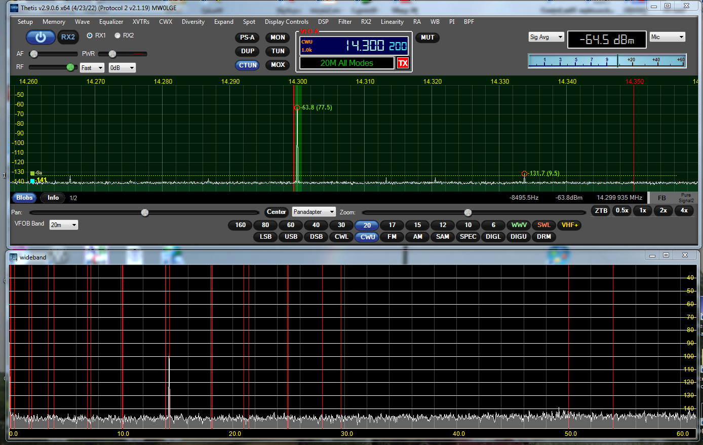

Hi
The WB level is not correct. So it should be or not.
- WB.jpg (340.97 KiB) Viewed 25029 times
The WB display has only enough code behind it to just barely show that the WB data stream coming from the firmware works. Do not expect very much from it at this time.
While the WB display is therefore ripe for many improvements, also remember that the preselector, any antenna tuners, and the antenna itself, will all have significant effects on the data displayed. This may or may not impact its usefulness depending upon the situation.
Thanks a lot.
This review is very helpful.
It is clear that you need to be able to directly connect a broadband antenna to view the entire spectrum.
